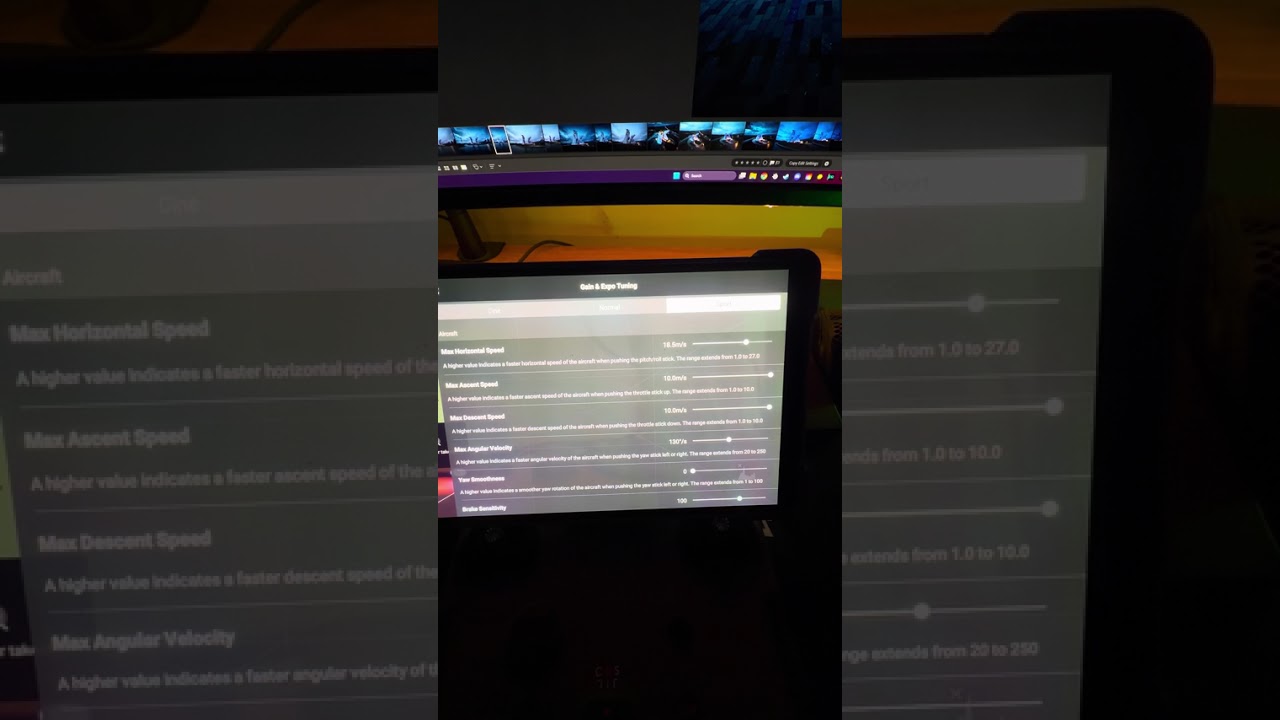

I’ve had a few comments that it is indeed restricted to a lower speed now.
Just checked this out in the house and when you try to set it to 27m/s it reverts back to 18.5 so damn annoying these new rules, I can understand it to a degree but literally before long we will have no freedom what so ever……..

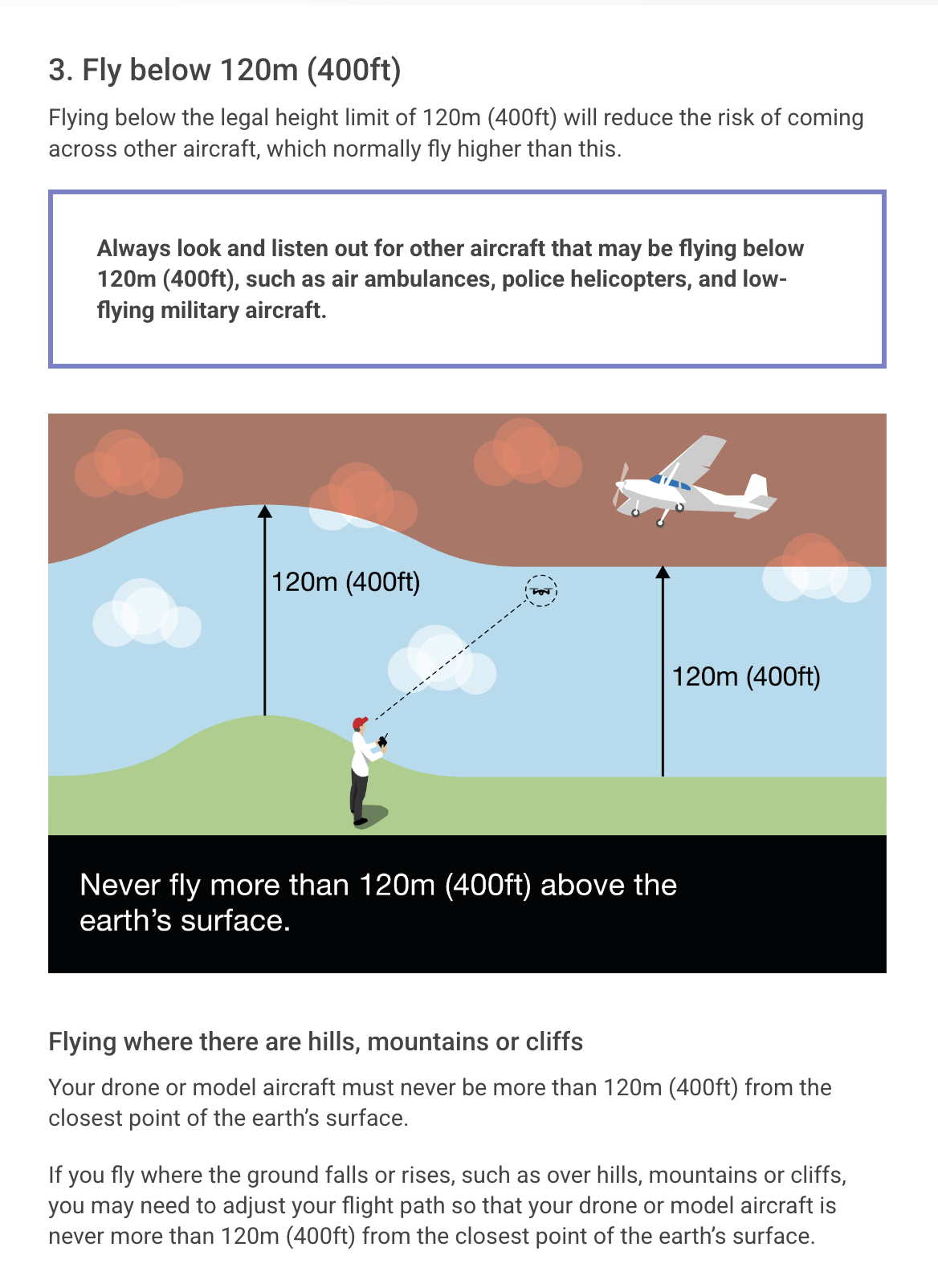

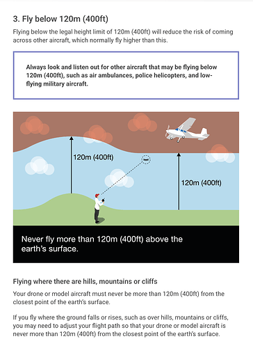

This is my understanding of the situation. The previous rule was that drones were limited in height to 400’/120m from the nearest point on the earth’s surface, and in the case of flying from the top of a vertical 1000’ cliff, you could for example fly vertically upwards for 100’, then horizontally for 300’ away from the cliff; you would be 1,100’ AGL, but ‘legal’ because you are only a little over 300’ away from the nearest point on the ground.
The new 2026 rule is that you cannot fly more than 400’/120m above your take-off location. That means that you can now fly more than 400’ ‘out’ from the edge of the cliff, so long as you maintain. VLOS, irrespective of how high you are AGL, because you are within the 400’ height limit above your take-off point!
I could be misreading the situation here; it sounds unlikely as that could bring you into conflict with aircraft flying legitimately at their 600’ minimum.
It is in any case not something I will be losing sleep over, since 400’ is the practical limit to my ability to maintain VLOS of a Mini drone anyway!

For clarity the drone code still states
Couldn’t have put it any better my self haha, The amount of arguments I have had over on the Facebook groups with people saying “120m above take off point” when it clearly isn’t!

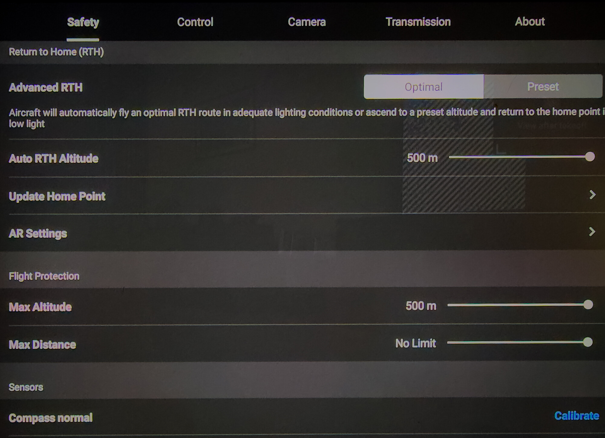

For anyone looking for a bypass / workaround, the Drone Tweaks app by @florin.a restores the 500m altitude limit again.
Tested ok on the DJI Mini 5 Pro running the latest v01.00.0400 firmware.
