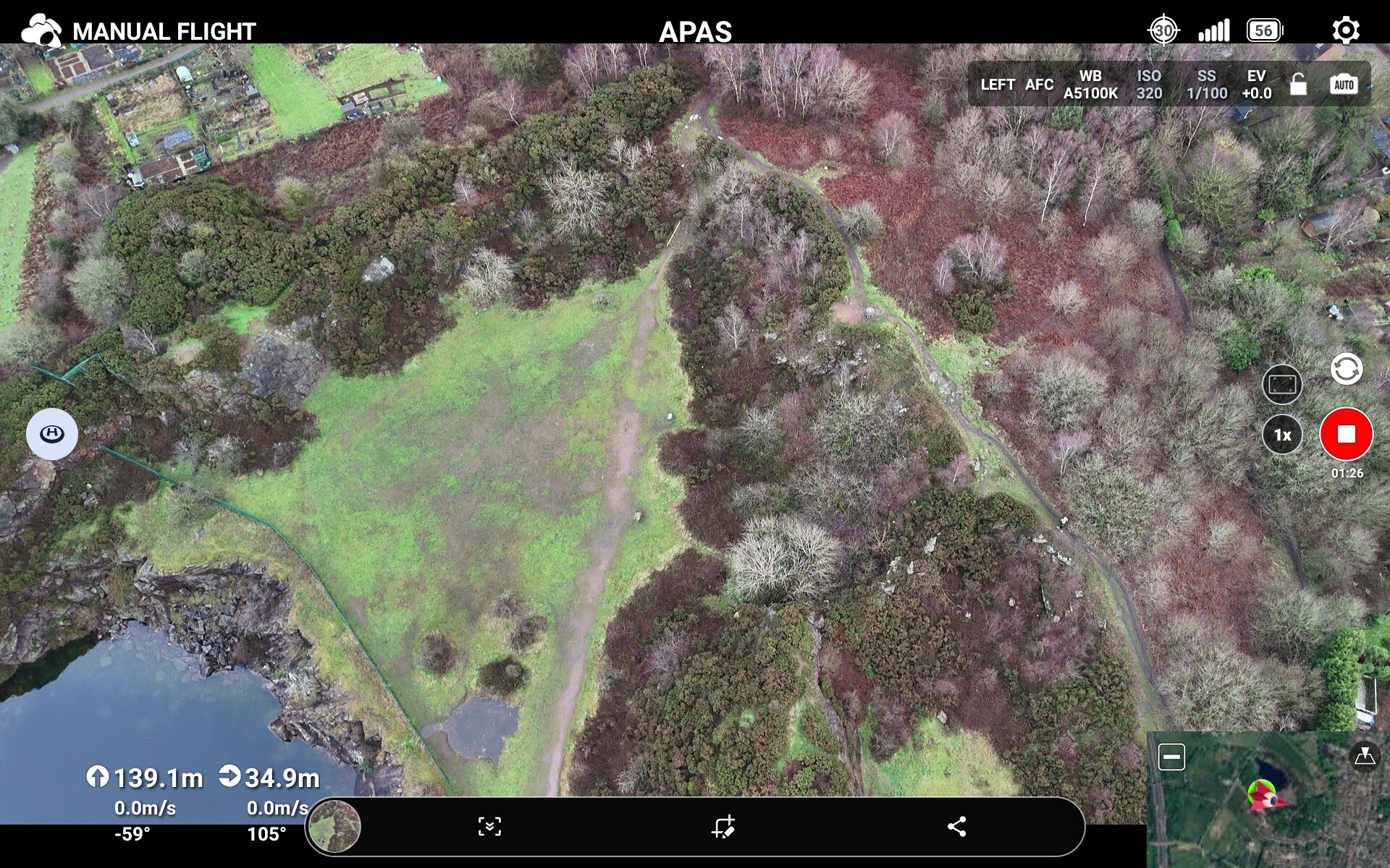

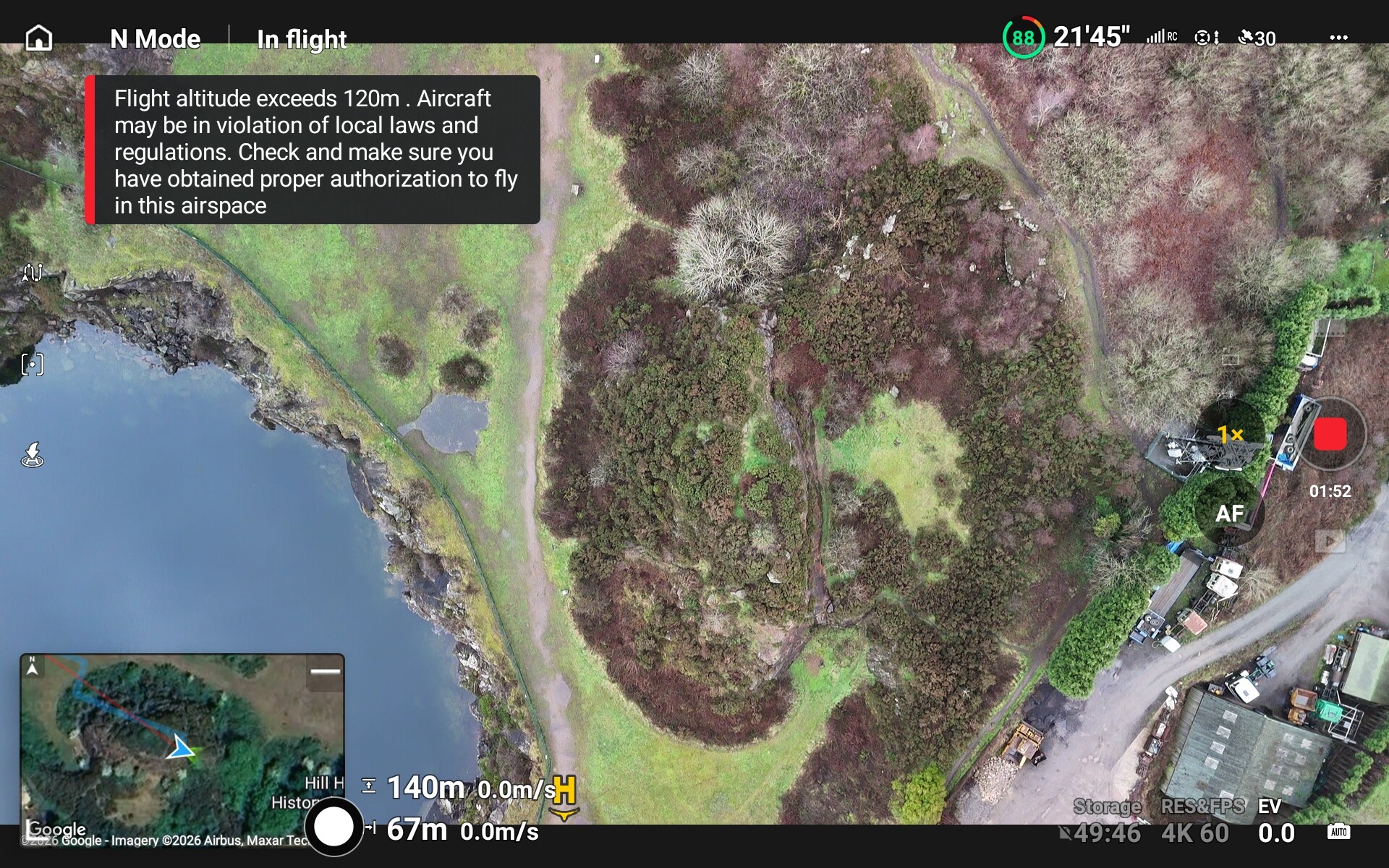

I now have two workrounds to the height conundrum on my Mini 4 Pro; the Drone Tweaks FCC version of the current DJI Fly app, or using Litchi Pilot. Both run on my Samsung tablet, so to test them I found a quarry with a rock outcrop 20m above the TOAL point on the quarry floor. I positioned the drone over the outcrop and increased its height to 140 metres. No problem in either case, as shown below:
Litchi Pilot
FCC DJI Fly:
So for the rare occasions I need to exceed 120 metres above TOP, I have two solutions.
