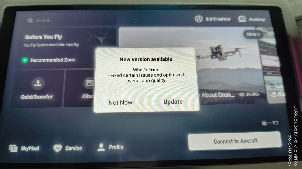

After reading this thread I went through step by step.
RC2 with drone not powered up.
Selected Not now.

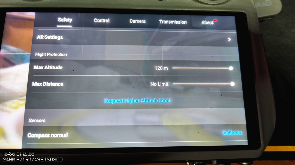

Drone powered up, went into settings and 120 max
So yes a backdoor intrusion (fnarr fnarr)

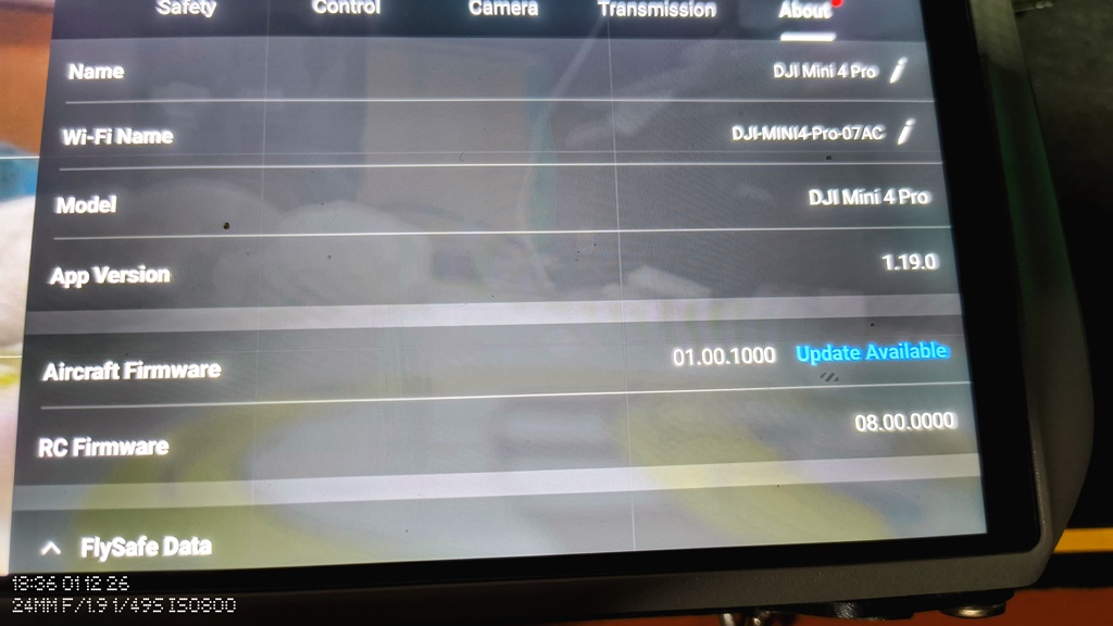

Current un updated info

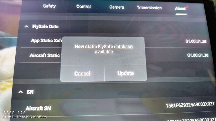

Also a Flysafe update, again not installed.

Took my Air 3s for a spin this morning so seeing the posts on here I thought I’d check though never gone above 120 metres with any of my drones, I don’t think my eyesight would cope with contouring up hill. Only got a few days before Christmas (birthday present to myself) so latest firmware updated on unpacking. Max height 1000 metres, just get a box saying to confirm responsibility for new height limitation. Then set back to 120 metres.
The air 3s is c1 class so has 500m with the option of 1000m it’s good to know they haven’t removed the 1000m although not checked my own, it’s the c0 class that is 120m

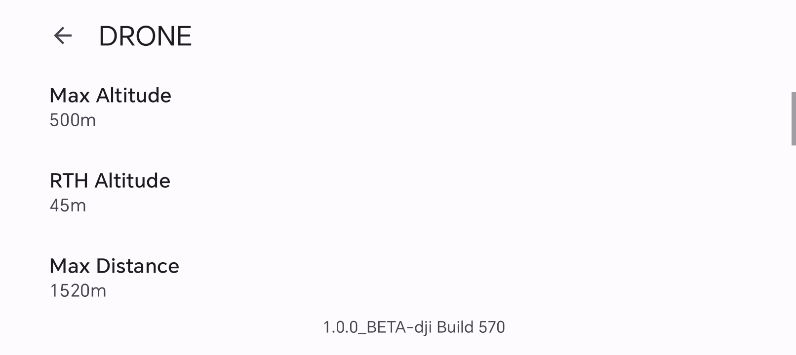

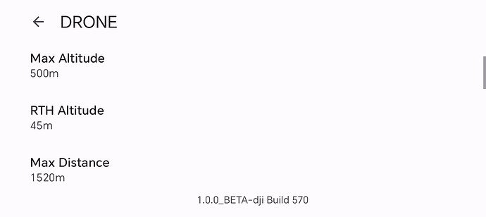

I was playing around with Litchi Pilot on a Samsung tablet tonight, working with my Mini 4 Pro when I found I could set this:
Not been out to try it yet. Have any other Litchi Pilot users had a go ?
