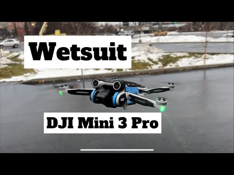

Mini 3 Pro Wet Suit?
I am not so sure about this but in this video the guy likes it. Would I subject my drone to this, no. But it
is your choice.

Call me sceptical, but that seems almost entirely useless, the little silicone hat someone posted yesterday is probably better.
Honestly, if I really had to fly in the rain I’d just be taping over the seams with some kind of self amalgamating tape and hoping for the best. If you didn’t care about cleaning it I suppose you could fill gaps with Vaseline or something.

There have been reviews on there stating things like they increase overheating (block vents, impede airflow) and so on. Also the main areas for water ingress are the motors themselves and camera area - neither of which are covered.
Any negative comments rapidly get pulled as he’s a paid advertiser and flags them immediately.
I wouldnt risk it - nothing suggests they work and they cause other issues. These arent just skins.
Edited to add:- The Mini 3 lacks an internal fan so relies entirely on passive cooling. Its likely to suffer even more from issues with blocking of vents and restricted airflow as a result.

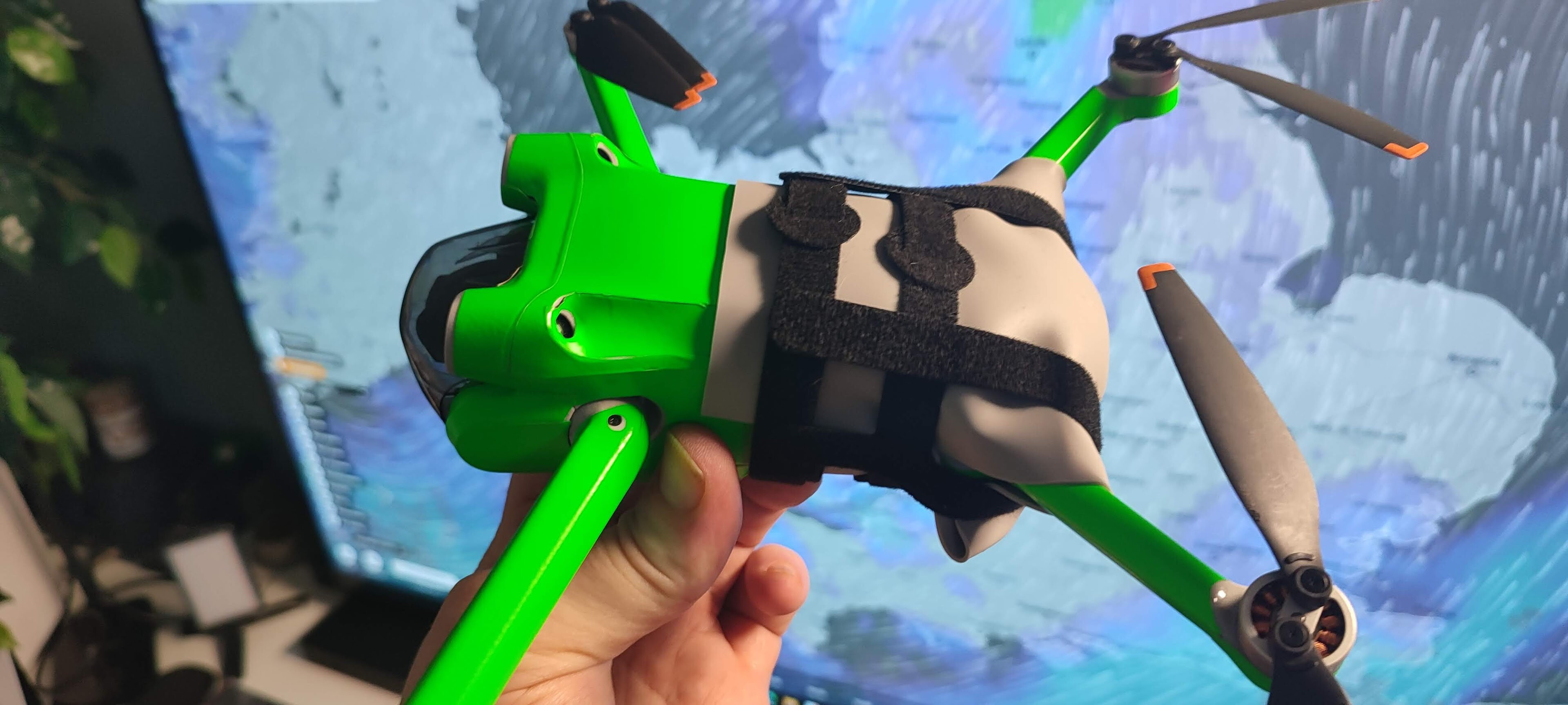

I did my own out a sheet of silcone and some velcro. Flies well and dry and kept the battery, usb port and sd card slot dry as a bone.

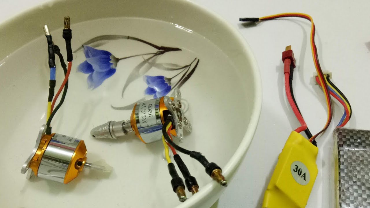

The motors are brushless, bearings are sealed and, as @callum says, the windings are insulated.
In many applications of radio controlled vehicles, the brushless motor may come in contact with water. This could be as significant as being even fully submerged
