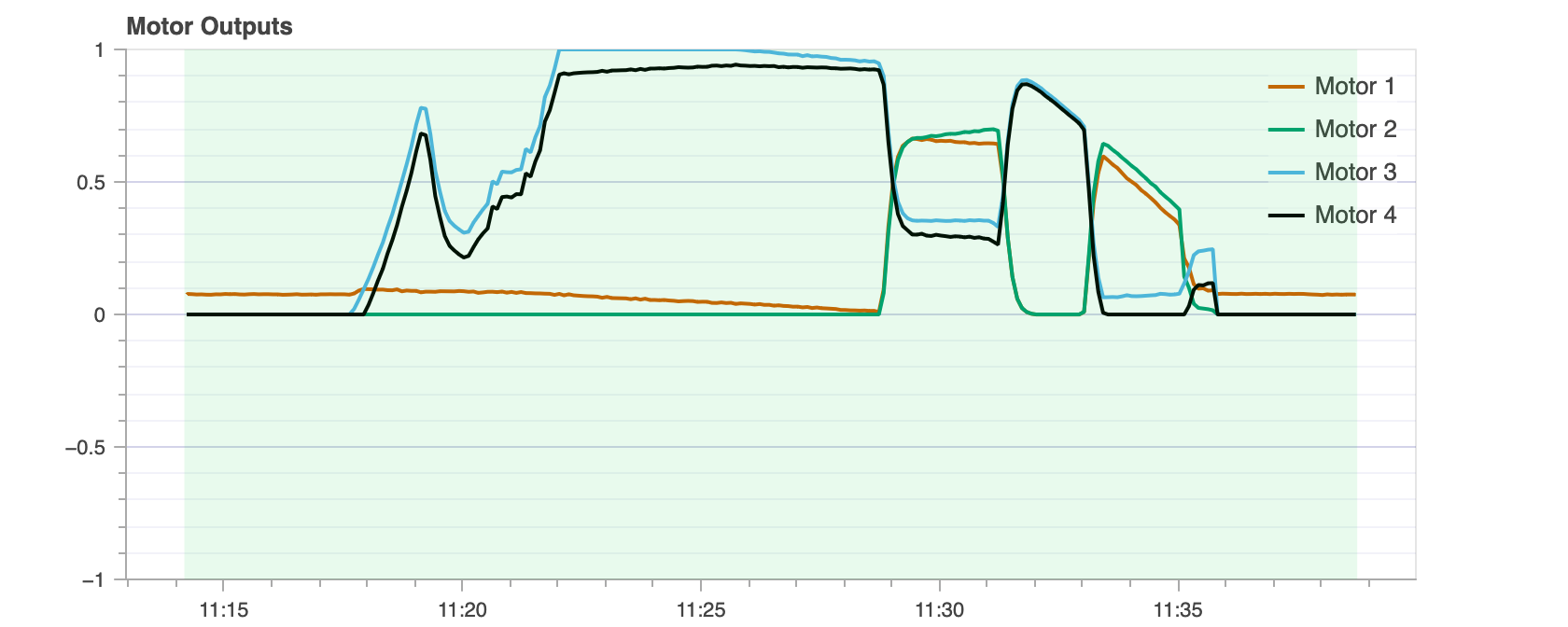

  3. I have a bokeh plot showing the output fluctations (attached below)

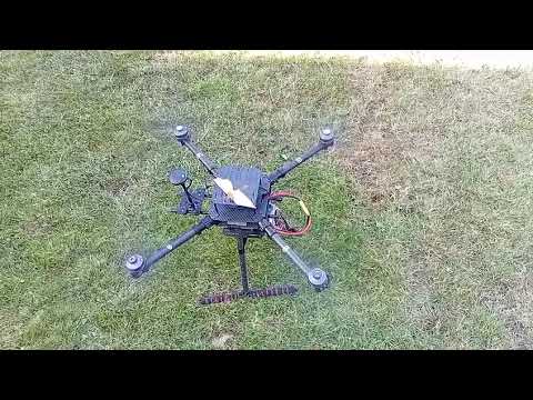

  4. I have a video showing the drone armed and spinning propellers but I am unable to share it here.
Upload to YouTube and share the link .. is they way to do that. :+1:
The reason videos can’t be uploaded directly :stuck_out_tongue: Direct video uploads no longer supported
Thank you, I have a youtube link, it may be low quality.
The wails are me changing the direction via RC.

Regarding the video - all motors seem to run - bit surprised there is no drone mvt at all as they even seem to run quite fast (based on the sound) - what props are you running? Are they the recommended size/pitch for the build? (how did you choose the motors/esc/props if I may ask?)
Were you just holding a low constant throttle? Or were you expecting it to take off?
I did a test without arming and I have the bokeh plot for the motor outputs which is the attachment shown. I can attach the bokeh plot with arming. After doing so, one of the motors had a dead short releasing smoke meaning I had to replace it; however, the fluctuations remained. As for the propellers, I’m running Tarot 1555 15" blended cf props with tarot martin 4008 motors as recommended by tarot, I chose the Tekko32 F4 45A as it fulfilled the requirements and fits neatly onto my frame. I pushed the throttle gimbal to the max expecting it to takeoff but nothing happened. I think it maybe be cold solder joints but I have resoldered everything and still got the same results. I think this points back to the FC.

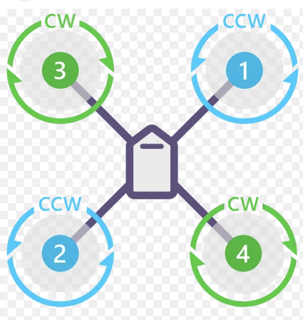

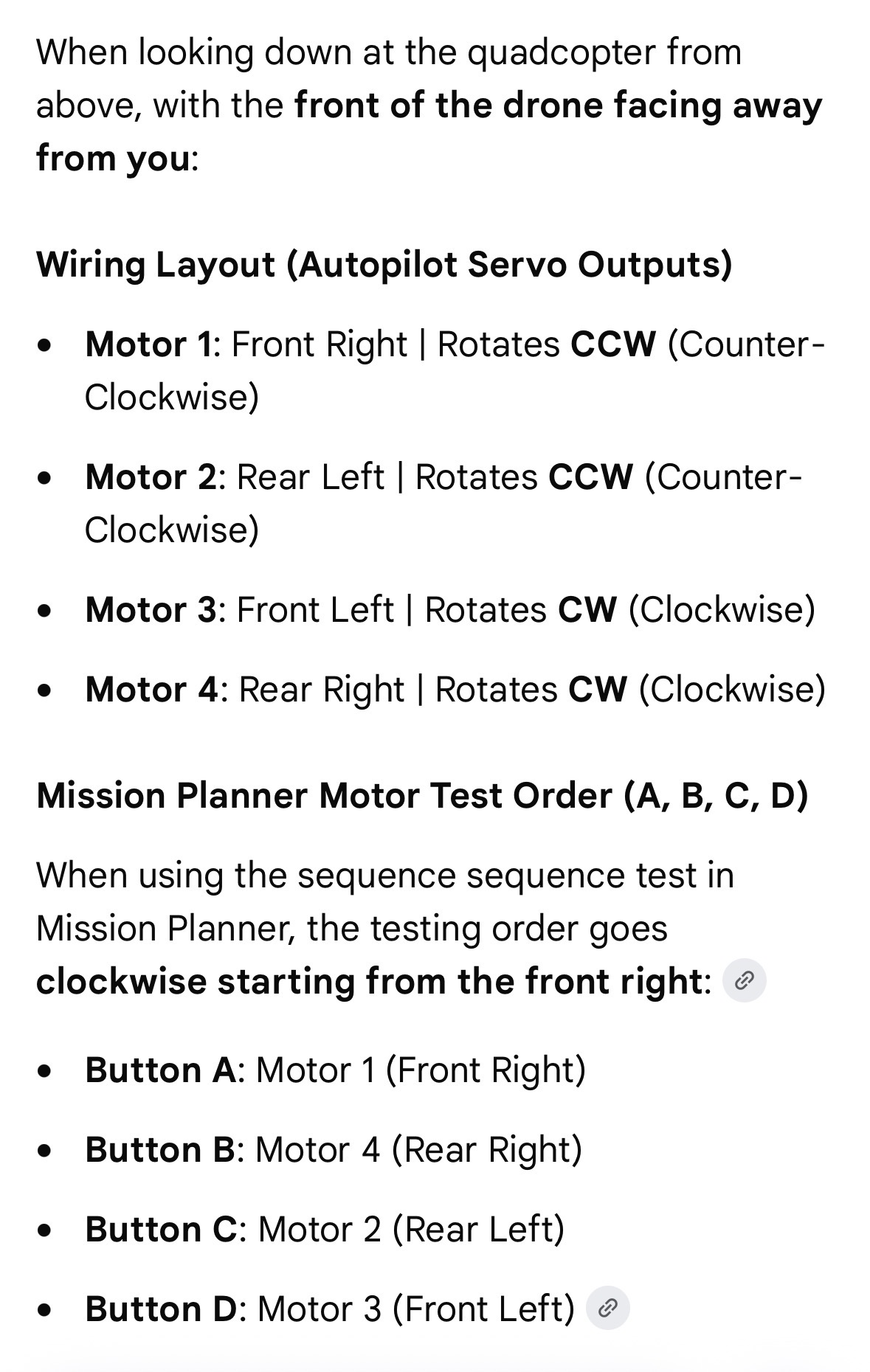

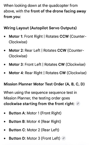

Edit: just seen you using a PX4 controller, what software level are you at? Are you using Mission Planner? There prop/motor assignments can be confusing
