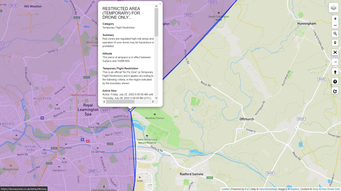

In West Midlands at the moment there is a temporary FRZ that came into force on 22nd July for Drones only. If you were to click on the current zone at the moment on DS, you would not be aware of this as the blue zone that is not active yet (this related to all aircraft including manned) is seemingly the top layer. A drone pilot may therefore assume it is currently safe to fly in this area.
I’ved messed around with the layers and see no way to get the current active FRZ thats only applicable to drones to display info when clicking on the zone.
E.g. If you view it on Altitute Angel you see there are two notices and that the red drone only FRZ is already in force. I can find no way of seeing this restriction in DS.
@firstadekit can you tell me (or screen shot) which layers you have on on their app to only show that restriction?
I’m wondering if they’re bundling it in with another existing layer :confused:
Think this is what you want?
Basically you tap in the FRZ, and you get the first AA image in the OP, showing the two restrictions one red, one blue. To get the bottom screen, you have to tap the red restriction thats showing in the black bottom half of the screen. Sorry if that comes across as obvious, not trying to sound like teaching to suck eggs on purpose.
Does that help?
Is there a way to only visually display that one red layer (re drones) in their app? :thinking:
Not that I can see. Both only appear when temorary flight restrictions are toggled on. Admittadly the blue layer is also the prominent visible layer from just looking.
I guess it would be nice if in DS if you clicked in a area it could somehow display all the warnings in that one clicked area if there are multiple, either via similar click-through to prevent it getting mega messy on the screen or worst case, listing them all in some sort of priority order of listing.

Yup that makes sense, either way atm a DS user has no idea there’s currently a FRZ for drones in that space.
Have DJI made up there own FRZ :man_shrugging:t2::man_facepalming:t2:
Yes. Yes they have :smiley:
Thanks for the info, sounds like they’re bundling multiple layer types together in the one payload. I’ll see what I can do.
You can find the FZR that is currently active for drones if you zoom in and find where there is an overlap
Interesting that they’re not both the exact same shape :thinking:

Yes, they have, rather than use the official FRZ they have just completed the circle :joy:
Hard luck if you own a DJI drone, in the 2 areas to the N/East and S/West :man_shrugging:
More reason (if it was needed) to invest in DroneHacks
