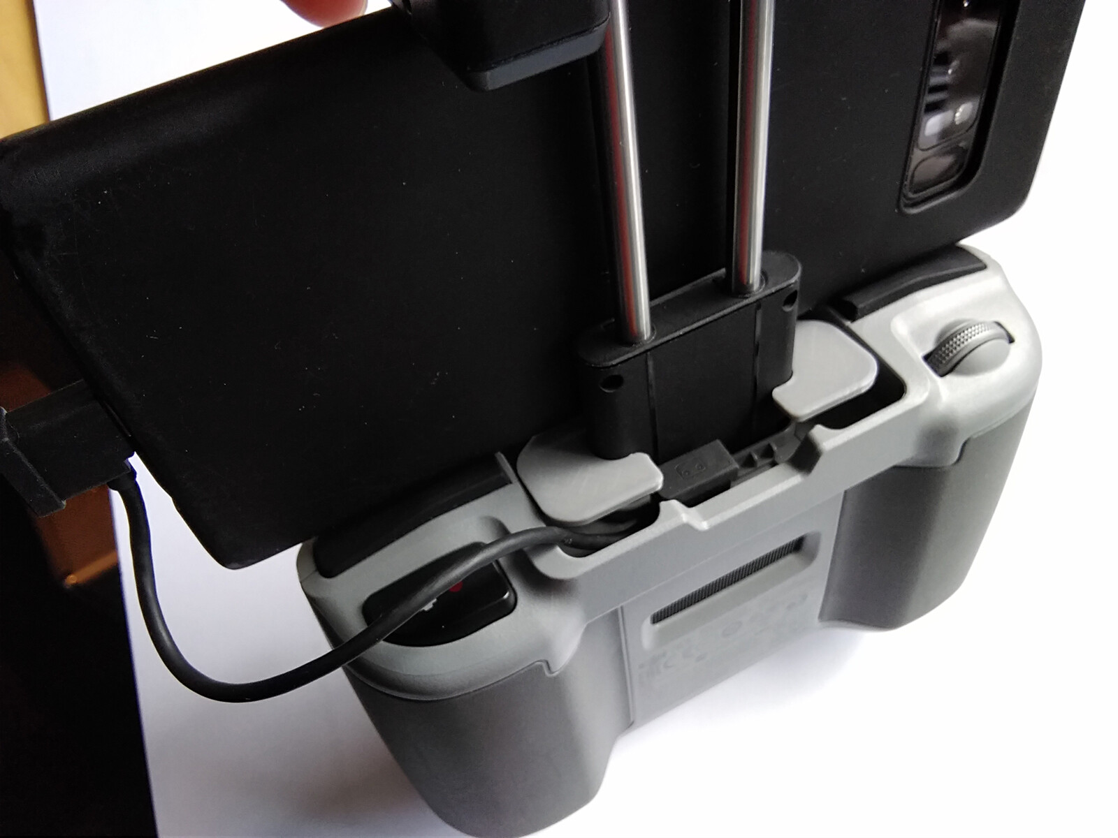

Nah, I’m still working on the solution. I’ve seen that product before, and I was not impressed by the reviews. Also, it still looks like something which puts the centre of mass away from the ideal (which would be somewhere around the mode selector switch).

First print, just to check the dimensions (printed in PLA, with 10% infill, so it is not suitable for daily use, in fact I already managed to break it), but I think it will work.
Actually there is, on the first picture you can barely see holes in the corners next to the remote, that’s what I was planning for the lanyard, if that does not work out, I can still add something else to the design, and print again.
But, as the balance feels just right, I might not even need a lanyard, will figure it out when I start to use it.
