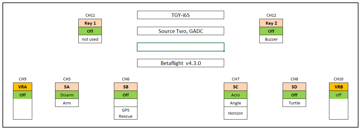

The quad is running Betaflight software version 4.3.1, the backup config file is HERE
You should be able to plug the controller into your PC with a USB cable. If you do this while the controller is powered up then it should ask you if you want joystick or storage mode (you want joystick).
Most sims should then detect it and be able to use it. You may have to go through configuration/calibration in the sim.
I’ve skimmed thorough this and it seems to be thorough. :slight_smile:
Here are the switch and channel asignments

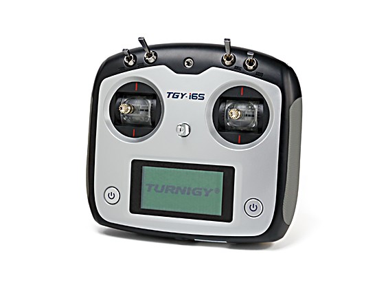

“There is even a mini USB port for easy connection to your PC for updates or for connecting (via USB) to your favorite simulator programs.”
I think you have to set it for ‘Trainer’ mode, this is not an OPEN-TX/EDGETX radio
Apologies. My bad. Should’ve checked first. :slight_smile:
