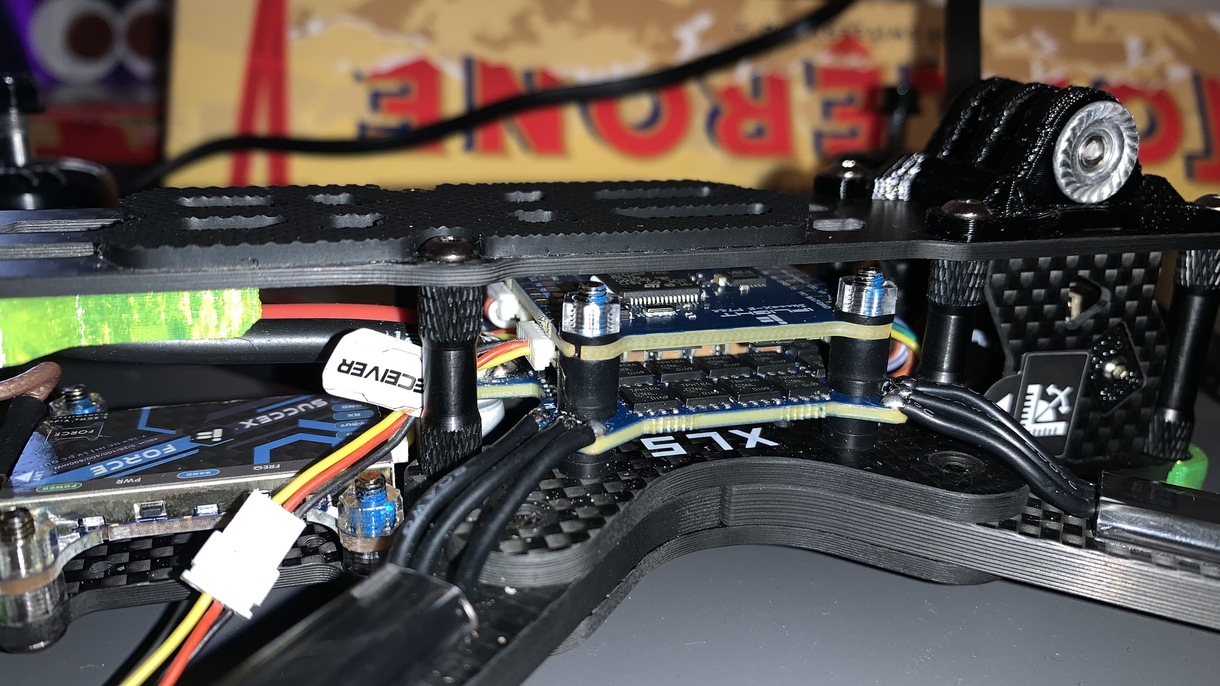

Where abouts are you at? We think the receiver is bound to the controller right? Can you give us clear photos of the flight controller wiring?
Sure I’ll try my best to get some good photos of them

I still think the RX is wired to the wrong pins. The photos of the flight controller will help loads. Make sure to photograph the plug as well

I don’t know how useful these are to you
Sorry this is the best I can do because I still can’t find a screwdriver head small enough to take the top plate off
Can you get a closeup of this?
It’ll be difficult without seeing the boards properly. Can you see anywhere on the board which version number it is so we can find the correct diagram?
