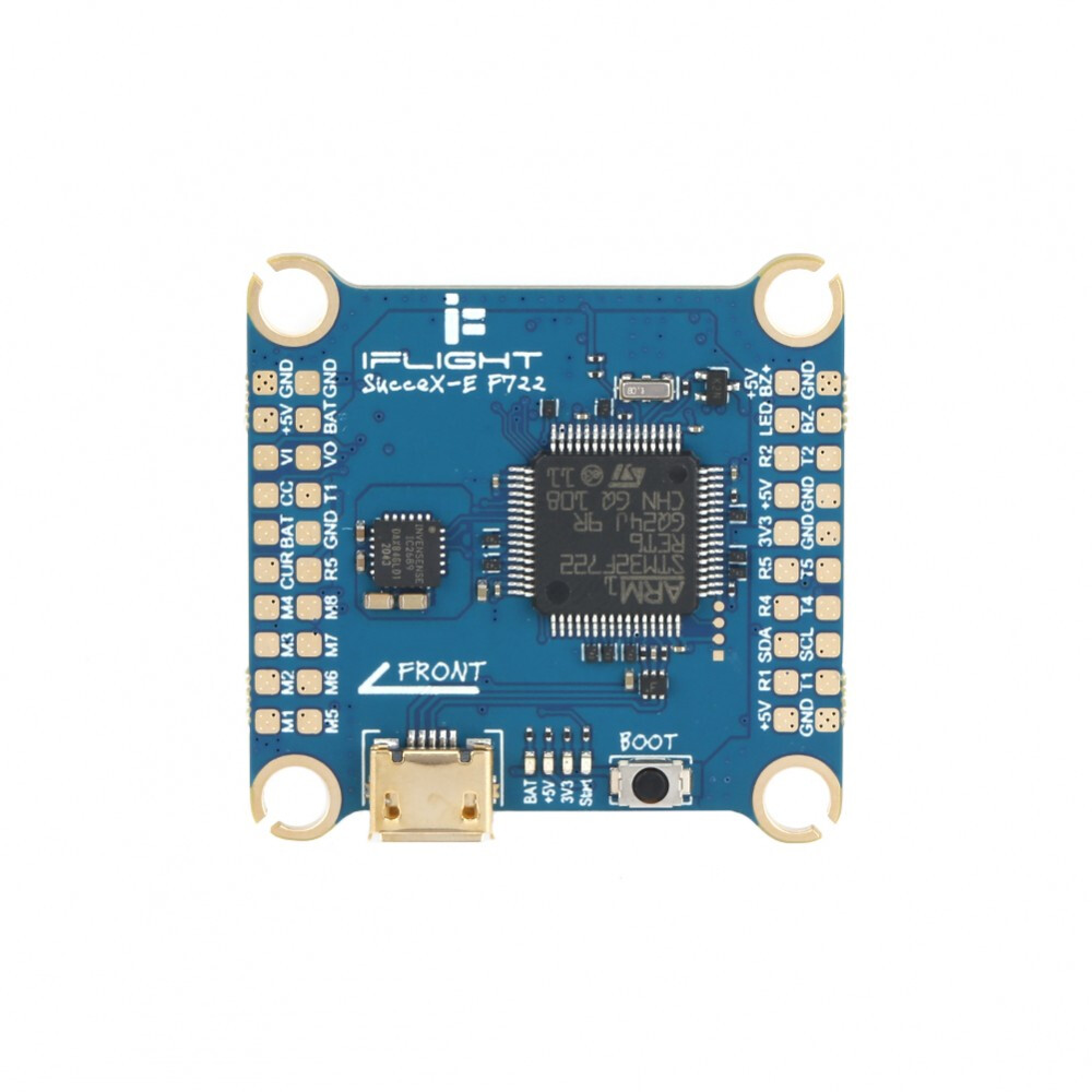

Can you give us a pic of the otherside of the flight controller so we can see the USB port. That’ll help us get orientation
Work it out from this. Think I’m right :man_shrugging:
Yeah judging by that it’s plugged into the correct socket

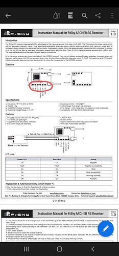

Are you able to get a shot of the receiver so we can see the pin out?

@notveryprettyboy the board looks correct and no it’s not plugged into the buzzer I checked

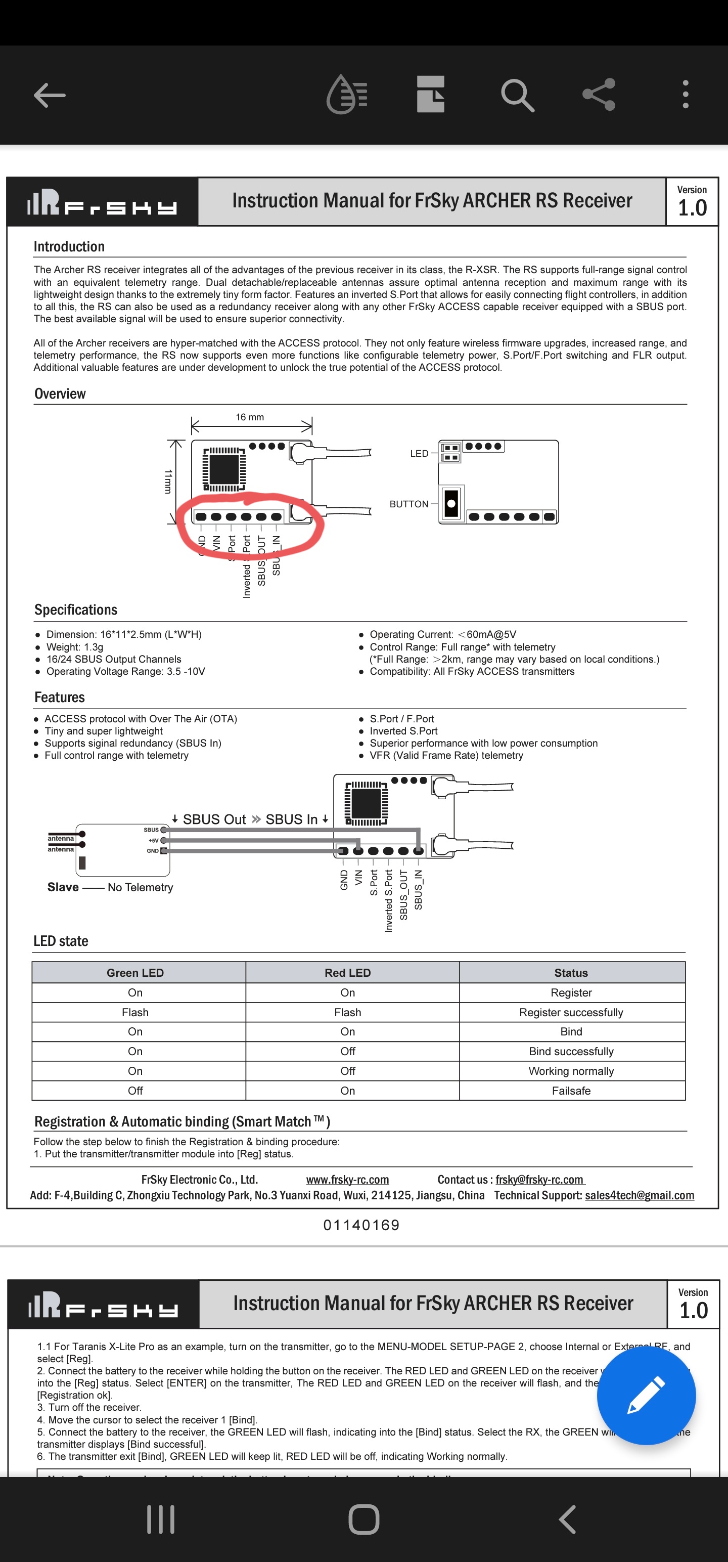

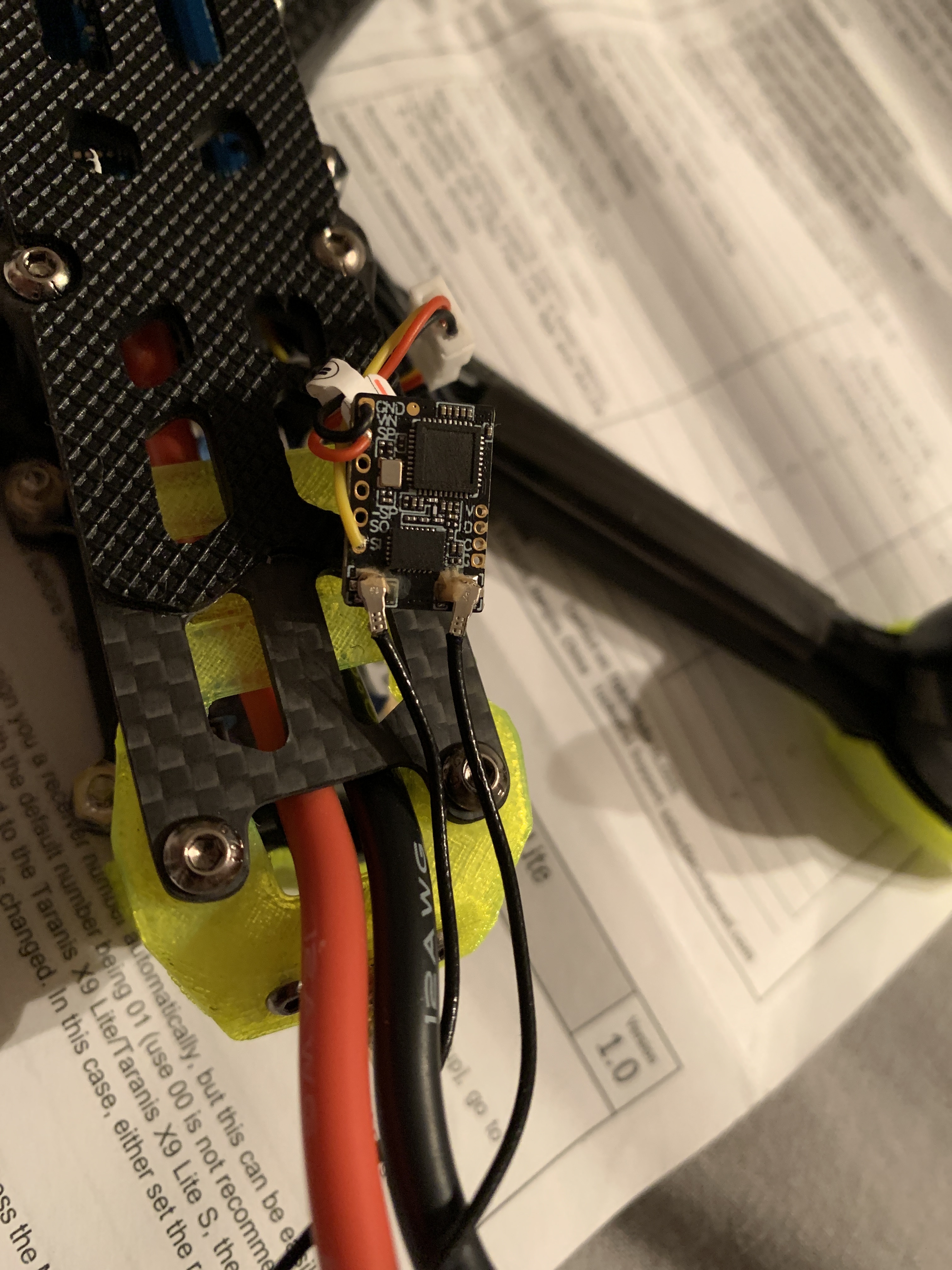

@notveryprettyboy heres the picture of the receiver you asked for
You are in the correct port
On my instructions I got with my transmitter say I can but I can’t figure out how to do that
There’s the problem you’ve soldered to sbus in
What’s an rx?
Should it be sbus out
