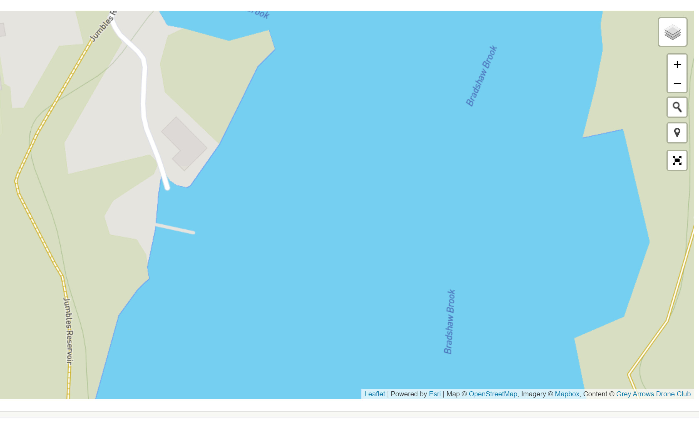

This is what showed on my drone scene. No power line! I must be doing something wrong.
It did not show up on the map on my console either. As I originally stated, I hold my hand up. I am doing something wrong. Whatever it is it is my fault, I would like to know how I can improve and pass my experience on to others.

Davent,
On the airspace space overlays, check you have ground hazards ticked. Here’s my preferences below . :+1:
As @uav_hampshire says, you need the Ground Hazards layer on to see … Ground Hazards. :wink:
Without …
With …
I am unable to select these. It is telling me to upgrade to do so, for which it appears I have to pay a fee of £16 per year. I have definitely seen other maps with the flight restrictions where I don’t have to pay a fee? I should have been looking there perhaps. Thanks again for advising. Davent.
