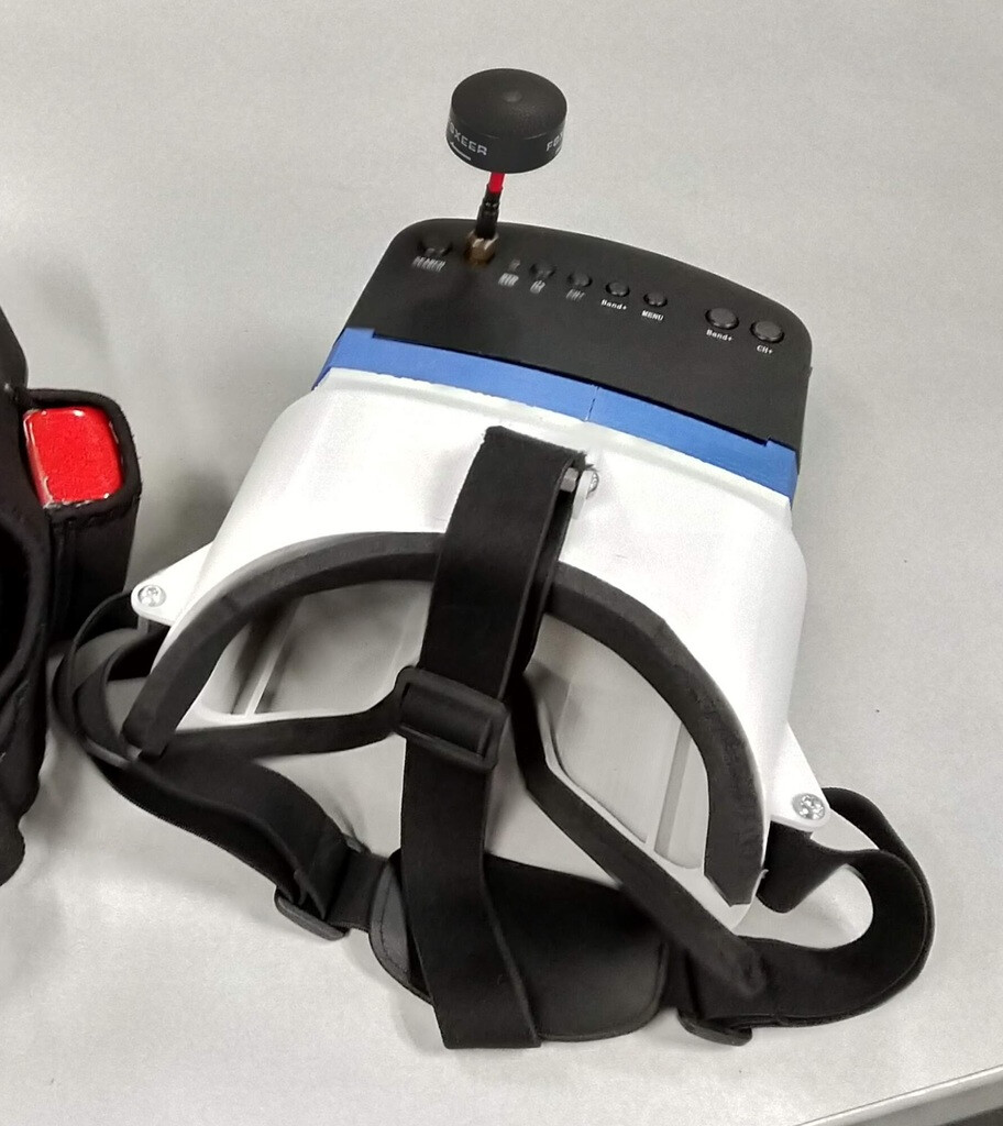

This one worked really well for my ev800d goggles when I still used them.

Is it the blue part of this?
Thank you!!! Yes the spacers I’ve seen are basically that blue part.
I’ve just checked measurements and I think either a 30mm spacer will work.
There’s a 30mm STL at this link Eachine EV800 Spacer. Focus fix by villamany - Thingiverse

If you notice the model I posted actually has a complete new face plate piece. It fits over glasses and is a lot more comfortable than the standard EV800D one.

How much do you need to do to that piece to make it useable? To you need to remove the optics from the EV800D interface and fit it into the Quest copy?

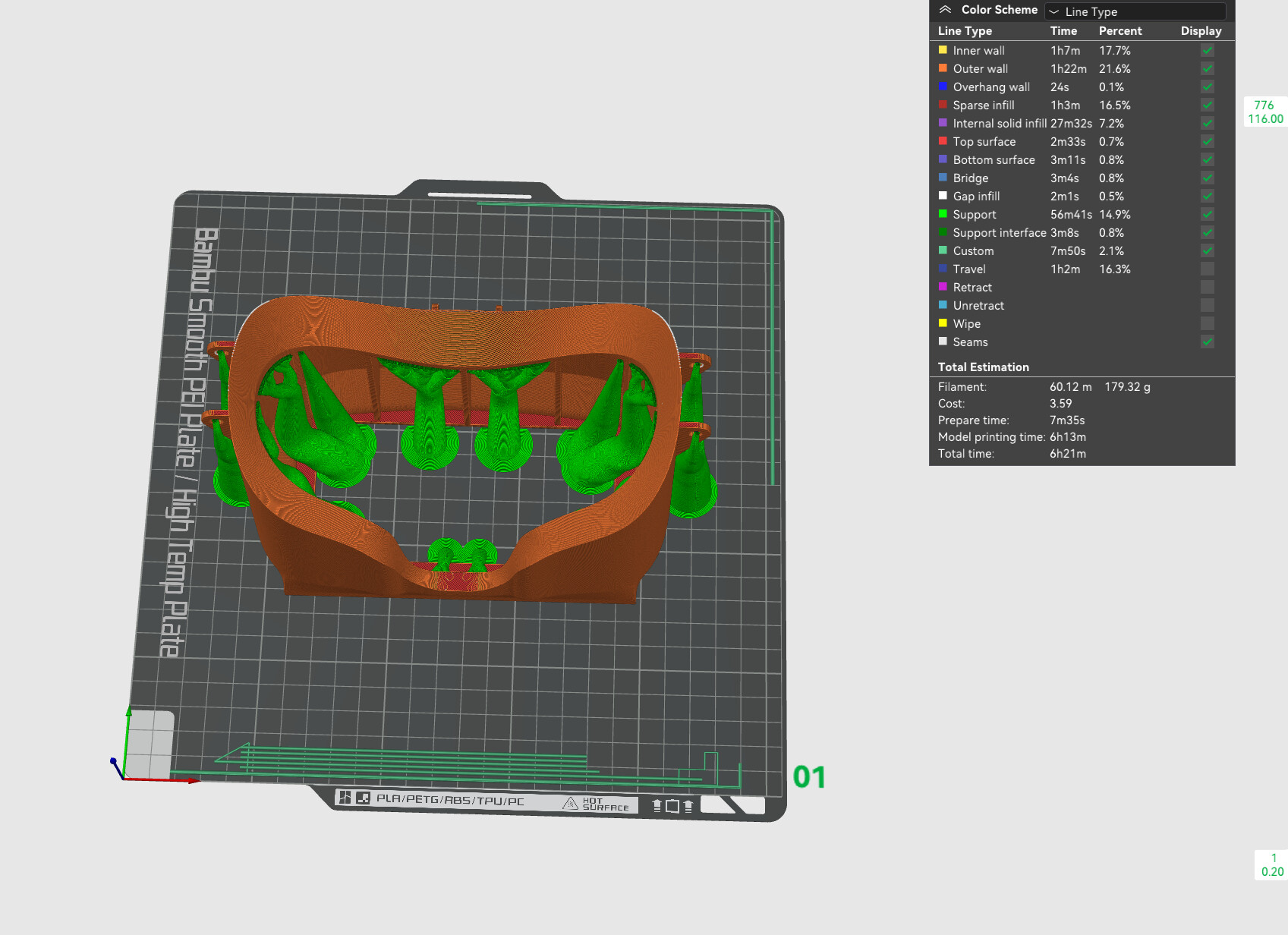

Just over 6 hours on my X1C

Yes you transfer the optics over. You’ll also need a few nuts and bolts for the straps.

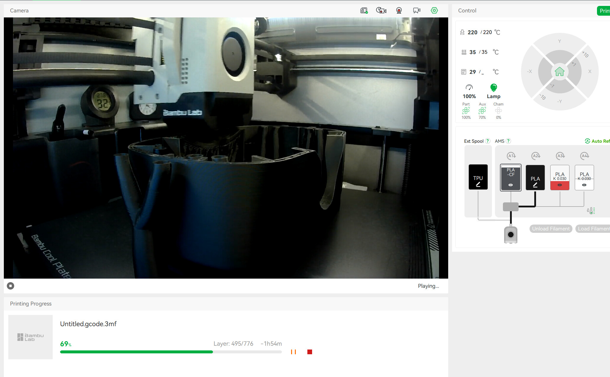

Nearly there with the larger part
