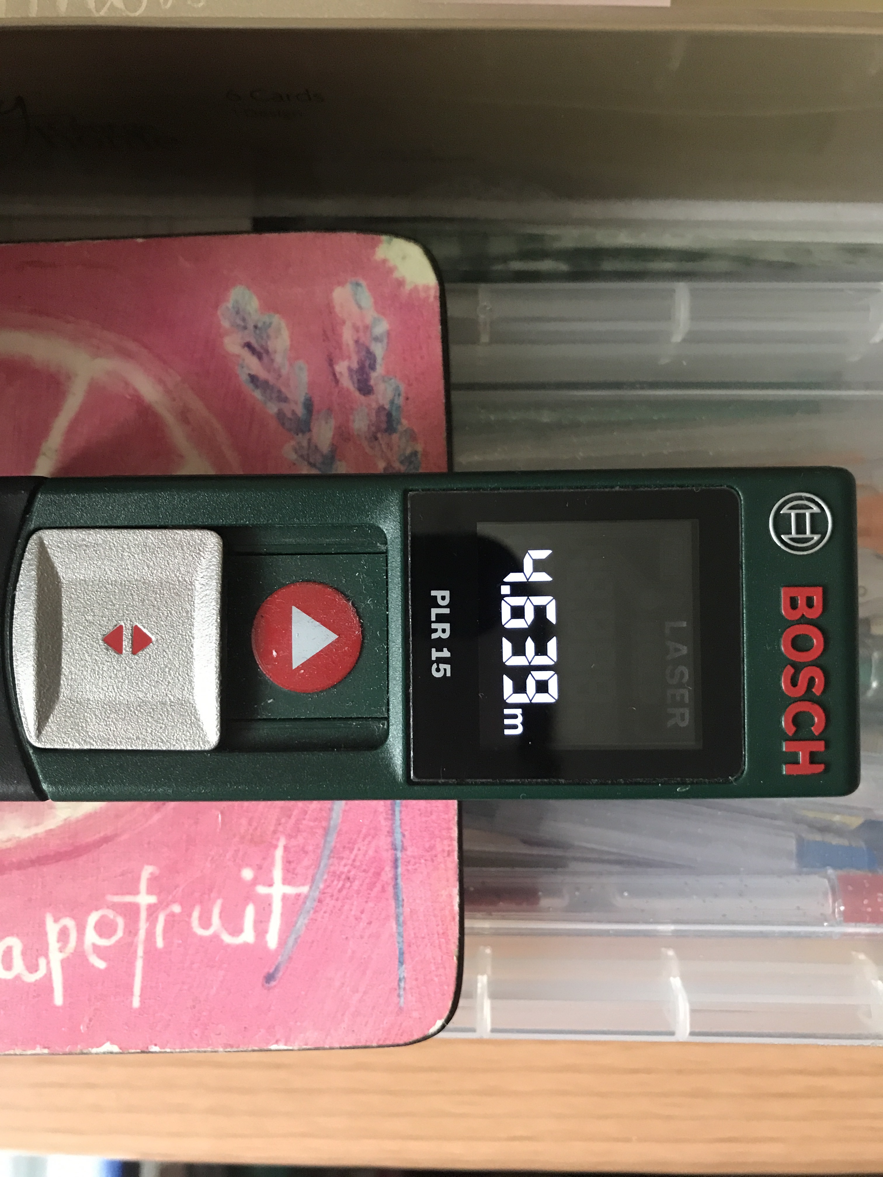

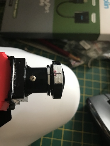

I’ve revisited the camera focus having read a few articles on line.
I’ve experimented by dabbling tipex on the camera lens bezel and marking it. I focusded the camera on a lamp post at some distance then followed a guide on focusing on the focus sheet I printed.
I’ve ended up focusing the camera at a laser point from 4.6M which seems to be the magic distance for focusing. The indoor focus point has lined up with the outdoor focus point.
How the flip did you work that out mate?!
Having read various articles and watched some videos, 3-5M seemed to be the ballpark area to aim for. I basically experimented.

I’m now happy with the focus and to my eyes the whole image seems much better and without the blurred sides. The video is long purely because I wanted to see how the camera would behave due to temperature. The distant chimney looks so much more in focus now compared to the last flight here some months ago.

What a difference! Well done mate. The key seems to be that you focused it at optimal distance and not just the nearest tree.
