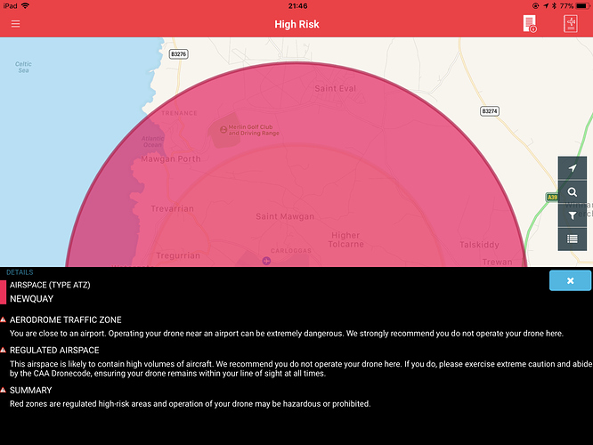

So I need to do some flying inside that zone. Where it says Mawgan Porth. Now this area is an ATZ zone due to Newquay airport being on top of the cliff above but I have been reading a ton of CAA rules and regs since my little meeting with the officer and his dog and found this.
CAP 722 UAV operations UK
1.36 Under ANO 2009 Article 166, operators of SUA with a mass of 7 kg or less are not required to gain an NSF approval from Air Traffic Control (ATC) to operate within Class A, C, D or E airspace or within an active ATZ. However ANO Article 166 states that a person in charge of a SUA ‘may only fly the aircraft if reasonably satisfied that the flight can safely be made’ and that they ‘must maintain direct, unaided visual contact with the aircraft … for the purpose of avoiding collisions’.
So what I am saying is if I follow the drone code and the fact my inspire is a lovely 4kg (she likes to eat not her fault) I’m within the law??
