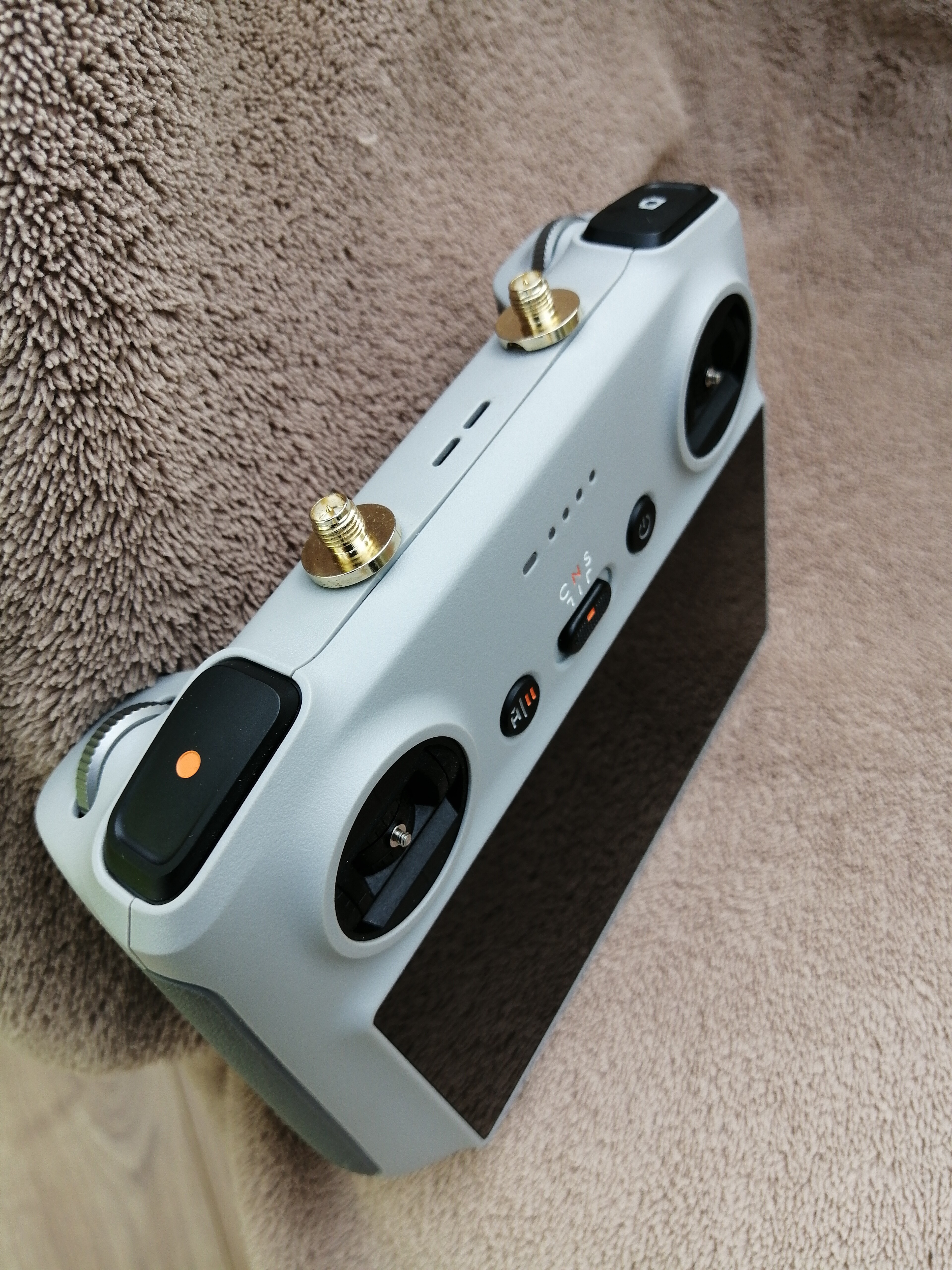

the antenna’s look really good but on the connector i see a huge ring, is that going to fit inside the controlller?
Yes it all fits no problemo. Needs a 6mm hole. Here’s a photo of location

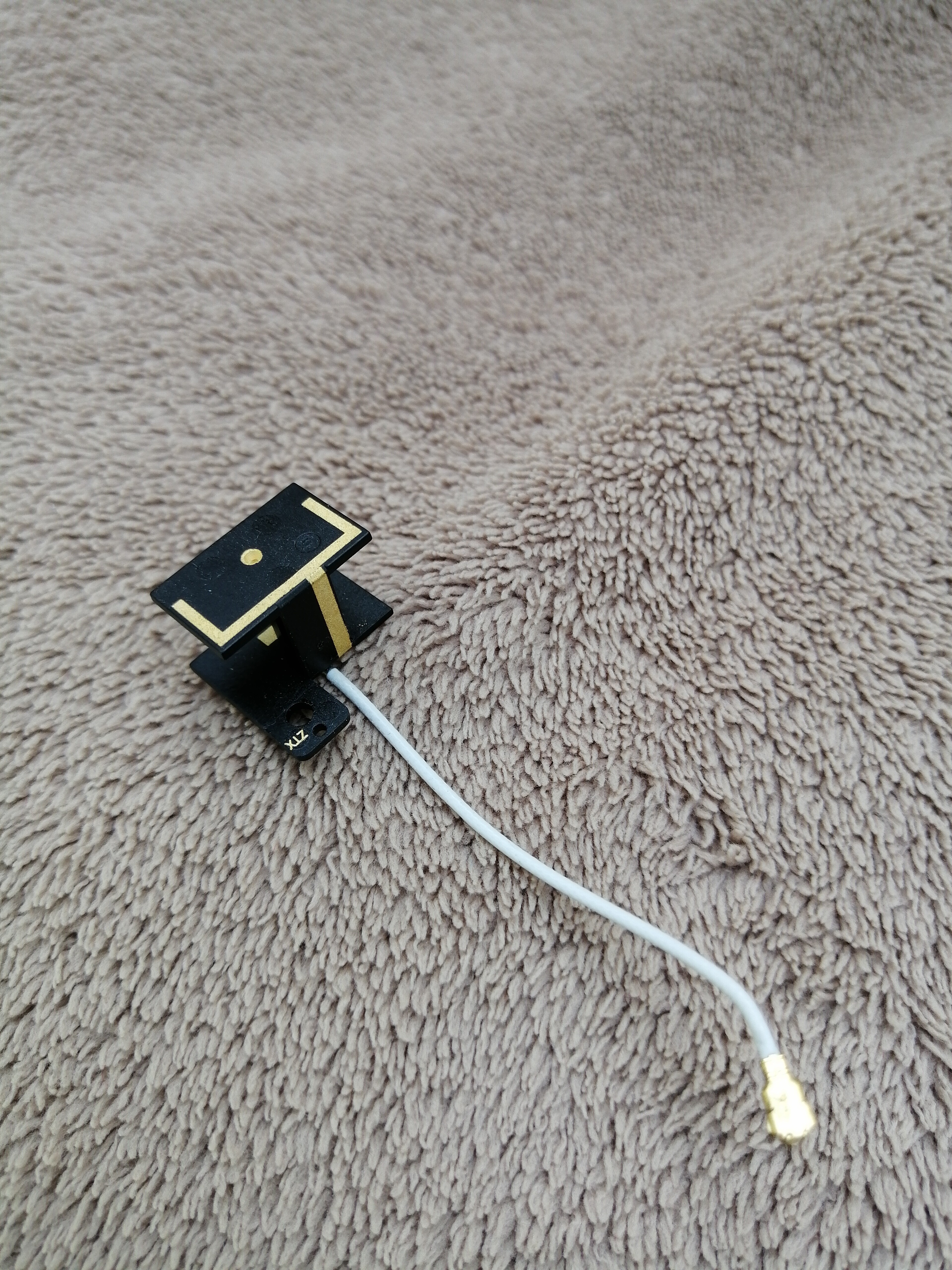

Here is one of the removed antenna. You can see the 2 tracks, 2.4 and 5.8. Tiny… Amazed they get as far as they do.
ah. the round part goes to the outside, makes sense.
i will give it some thought.
first i need to make a couple of runs to see how the range is now it is FCC enabled.
i guess even when on CE mode these external antenna’s make a huge difference.

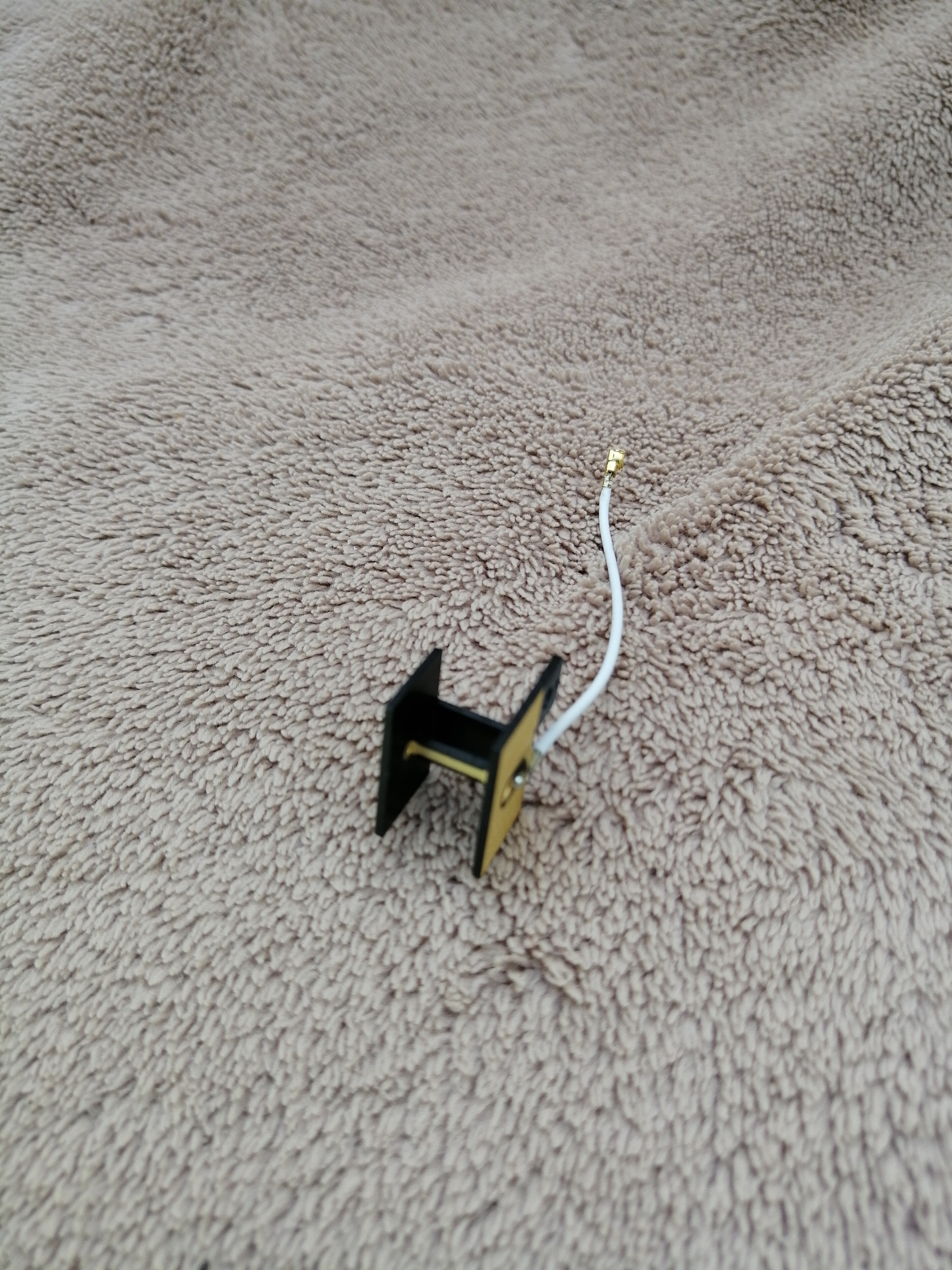

can you post some more photo’s of the original antenna
side where the coax is connected, front and back side
it looks like the small part in the middle is the antenna and the rest is acting as a ground plane.
weird that the put the ground plane on top instead of the bottom
