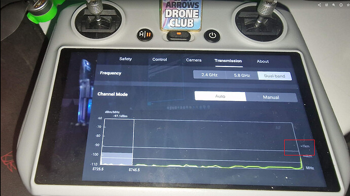

I am now on v01.03.1000, the latest firmware, with the FCC hack (as proved by checking the transmission graph in the RC settings).

I spy some GADC merch :star_struck:
Just in case anyone thought they were random images of the tinternet :wink:
