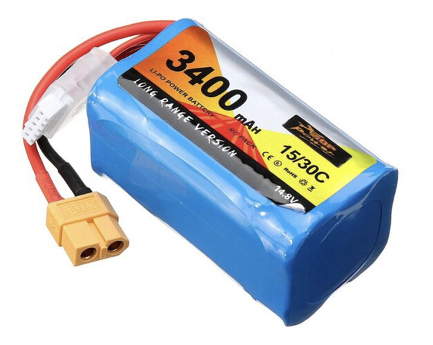

Looking forward to clocking up many many miles on this one. :sunglasses: I have in fact ordered a 3200mah Li-Ion pack that I’ve seen folks getting 20+ minutes out of which is just bonkers. I feel some mountain surfing coming up… after a wee bit more practice yet!
Which one is that?
Ohh - just checked, it’s actually 3400mah :smile:
It’s this one…
(ZOP Power 14.8V 3400mAh 15C/30C 4S Li-ion Battery XT60 Plug)
Not tried this brand but was only £18 so… :crossed_fingers:
15/30c is pretty good for a lion…
Which does put some doubt in the truth of the claim. Still £18 aint bad.
It says lipo in the picture?
:rofl: Good spot. Classic BG tbh… we shall see what arrives - I’ll keep you posted!
Judging by the shape in the photo you’re going to get a LiPo
but I like the fact it’s 15C, it will put it’s power out slower but for longer,
I suppose thats why they say
Please report back on it, I might get one myself for my standard bench discharge/charge tests

I just checked the listing and someone has actually said - “oi - that’s a LiPo” and the seller responded “This one is for a Li-ion” so :crossed_fingers:
My main thoughts were based on shape tbh… this looks like 4 x 18650 cells to me…
But… the labels all say Li-Po… :man_shrugging:
i agree, at this angle it does look very much like 4 x cylindricals, what’s the claimed dimensions?
Here you go…
ZOP Power 14.8V 3400mAh 15C/30C 4S Li-ion Battery XT60 Plug for FPV Racing Drone

Thats around 100a peak draw? Bit high for a li-ion? I’d say 50a max with high quality cells. But the weight checks out ok for li-ion

and size for 18650 cells - 18mm diameter x 65mm long
