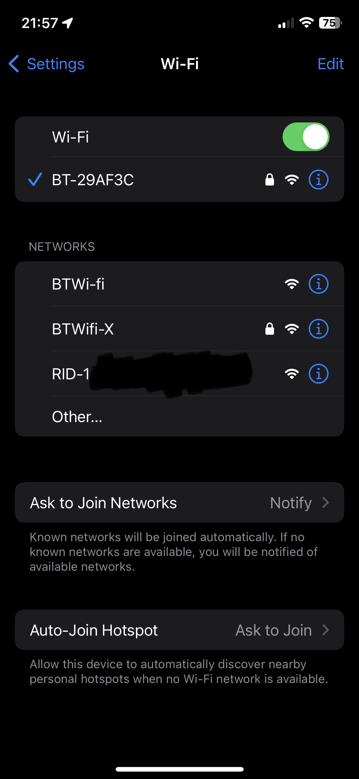

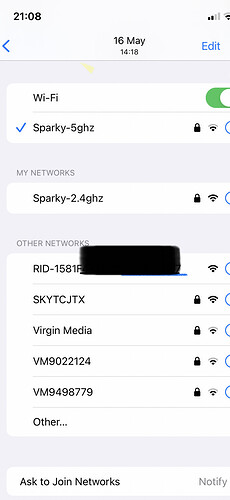

Wi-fi see if there is a wi-fi network picked up by your phone with the motors running
It should be RID - drone serial number
Like this
Ah ok

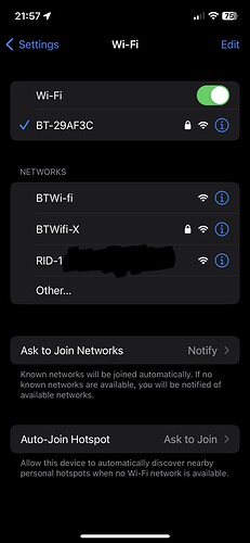

I’m on my way home now can I still test it at home & look for the same as per your picture ?
Thanks Wayne :+1:t2:
Yep it’s transmitting !

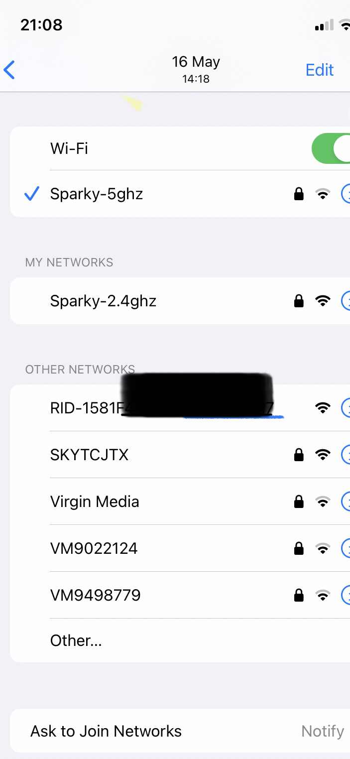

RID to be active and transmitting
Ah ok I’m with you,

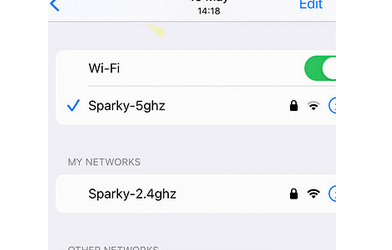

Was that picture further up the thread you posted also showing your transmission ….

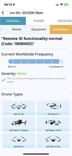

So after a little investigation this morning, cross referencing my Airdata with earlier Airdata, the remote id is only been showing my last three flights,
Which is for maybe for these reasons but not sure,
1 the update to the drone, 2 the update to the controller or 3 running the mod, or maybe all combined, got this screen shot from Airdata below.

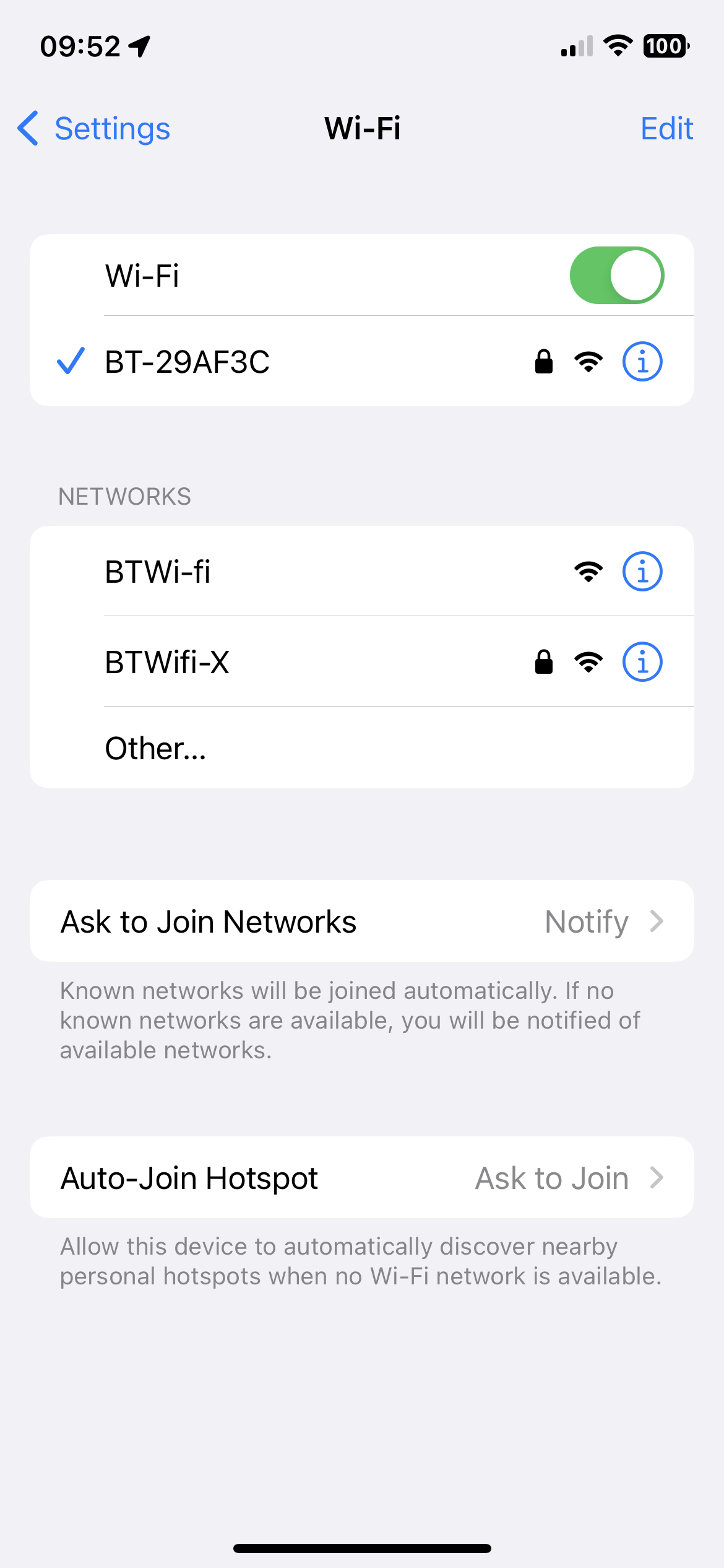

Just to add, after upgrade downgrade firmware versions with fcc mod it still broadcasts RID
Reset to stock & it no longer transmits RID when I removed the mod.
This is on any of the firmwares for the DJ RC PRO

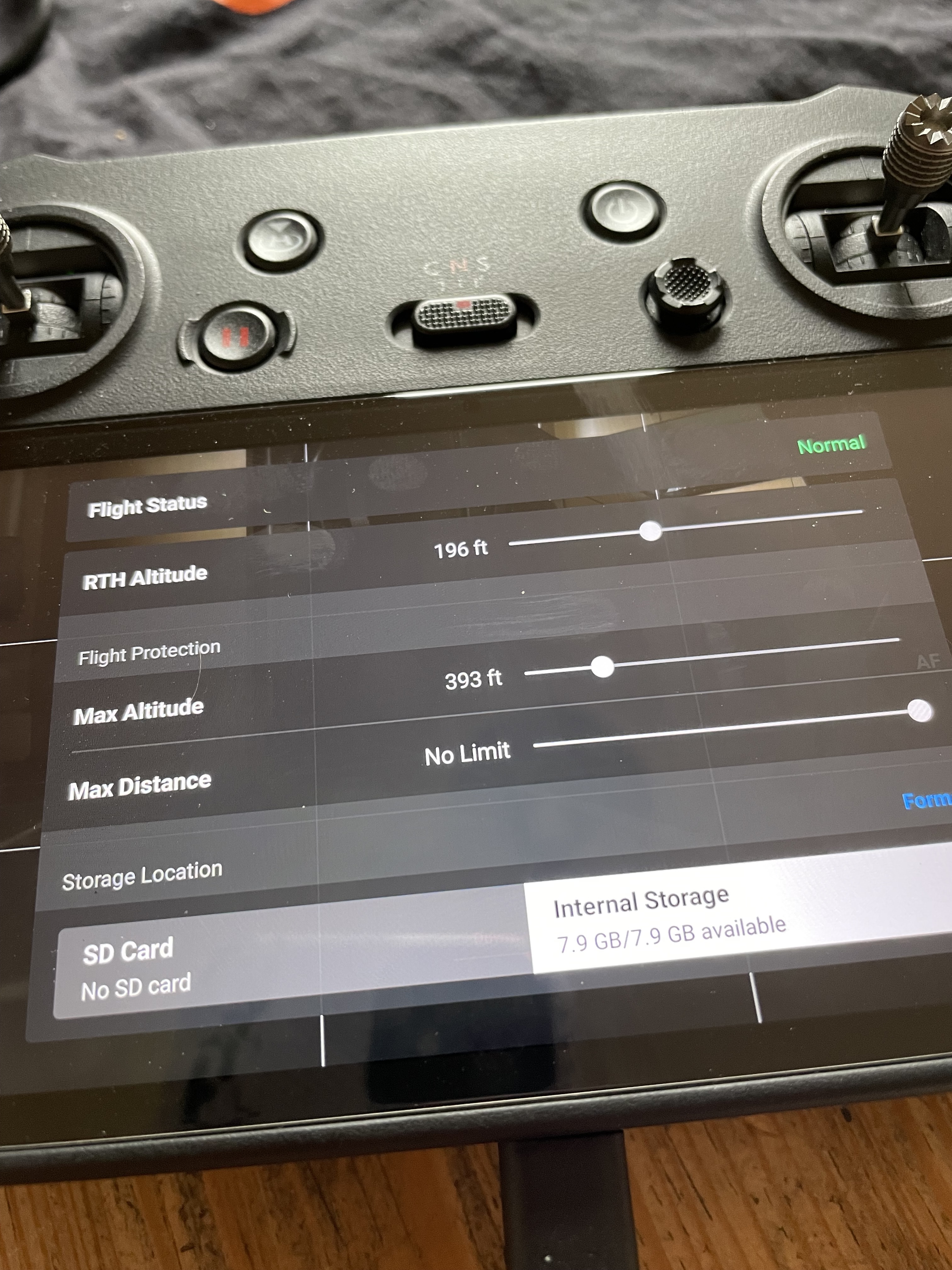

Edit, however it still shows this :backhand_index_pointing_down:t2: but nothing being picked up now as I can see.
Sorry edit again, after turning everything off then on it no longer shows at all.
