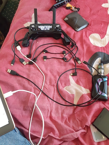

Can anyone tell me why my Samsung Galaxy Tab S performs like this ?

You tried another cable.
Is that an adapter you’re using , I find them very hit and miss :slightly_frowning_face:
Ditto - re adapters - as I mentioned the other day.
It’s with every cable I’ve tried
It works fine with my Sony Z1 so just can’t understand it :thinking::thinking::thinking:
Could be an iffy socket in the phone.
Why are you using the side connector ,into a adaptor, then into your Tab S.(both photos)
Why not go straight from the bottom USB Port on the controller, straight to the TAB S connector?.
(Connect white USB Lead only)
Cannot see the sense in the way you are doing that?
(you must not have a connector in the side of the controller, (if you use the bottom USB Port), when leads are plugged into the side connector, it disables the bottom USB Port)
Tried both buddy, side and bottom of controller and all the same, with and without adapters
Got to be a faulty socket on the device then?.
Have you tried a re-install of APP?, (looks like “Litchi”)
Yes mate, it’s the same on Litchi and DJO Go4
Hi Dave @Matty1
As this problem manifests across different apps and cables, this looks to me like a ‘in tablet’ issue
At a guess I’d say it’s screen connection to motherboard, they use very thin flexible ribbon cables with tiny connectors that can work loose.
Try using it without the DJI controller, as just a day-to-day tablet and see if problems are still there
Let me know how you get on
Cheers
Steve :slightly_smiling_face:
