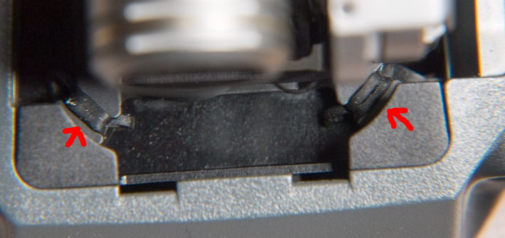

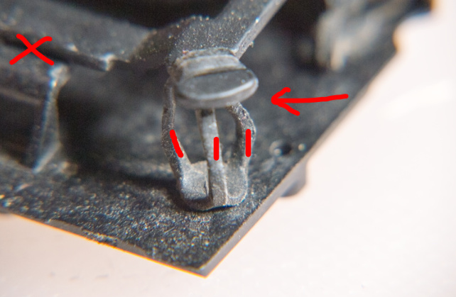

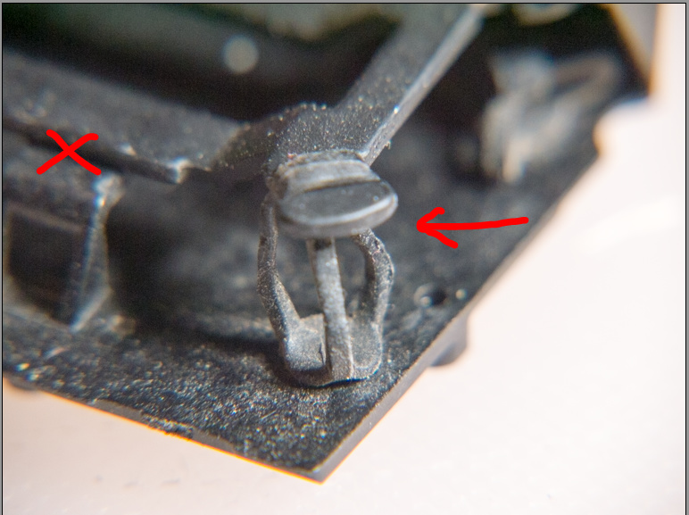

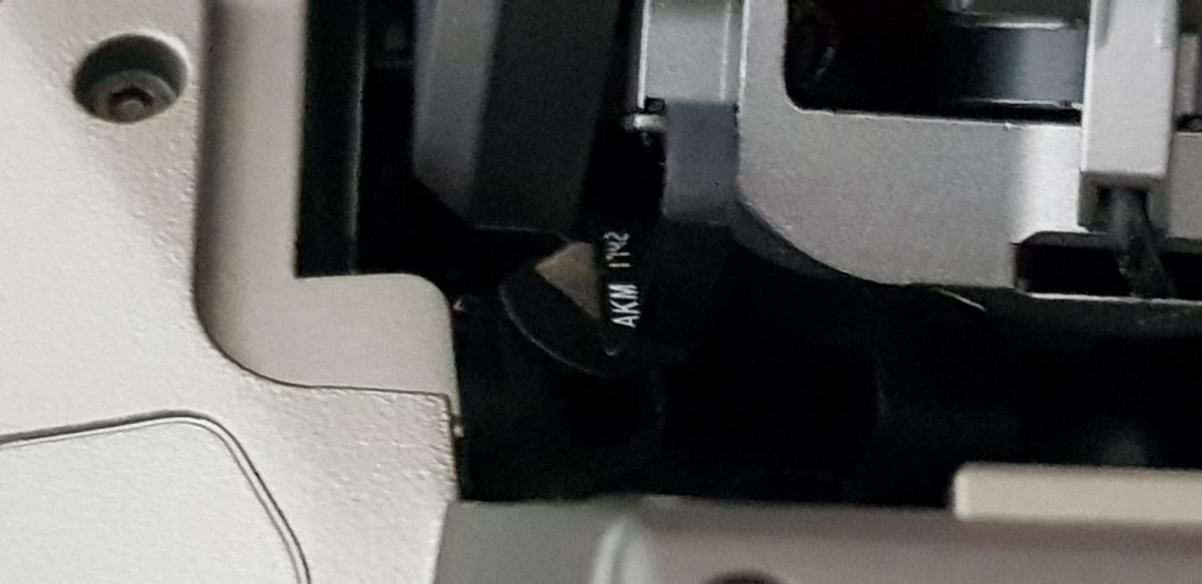

Check, also, that there is a rubber suspension link on each of 4 corners of that plate - as in the one case of this pic (arrowed).
(Which also shows the plate in the wrong position - marked X)

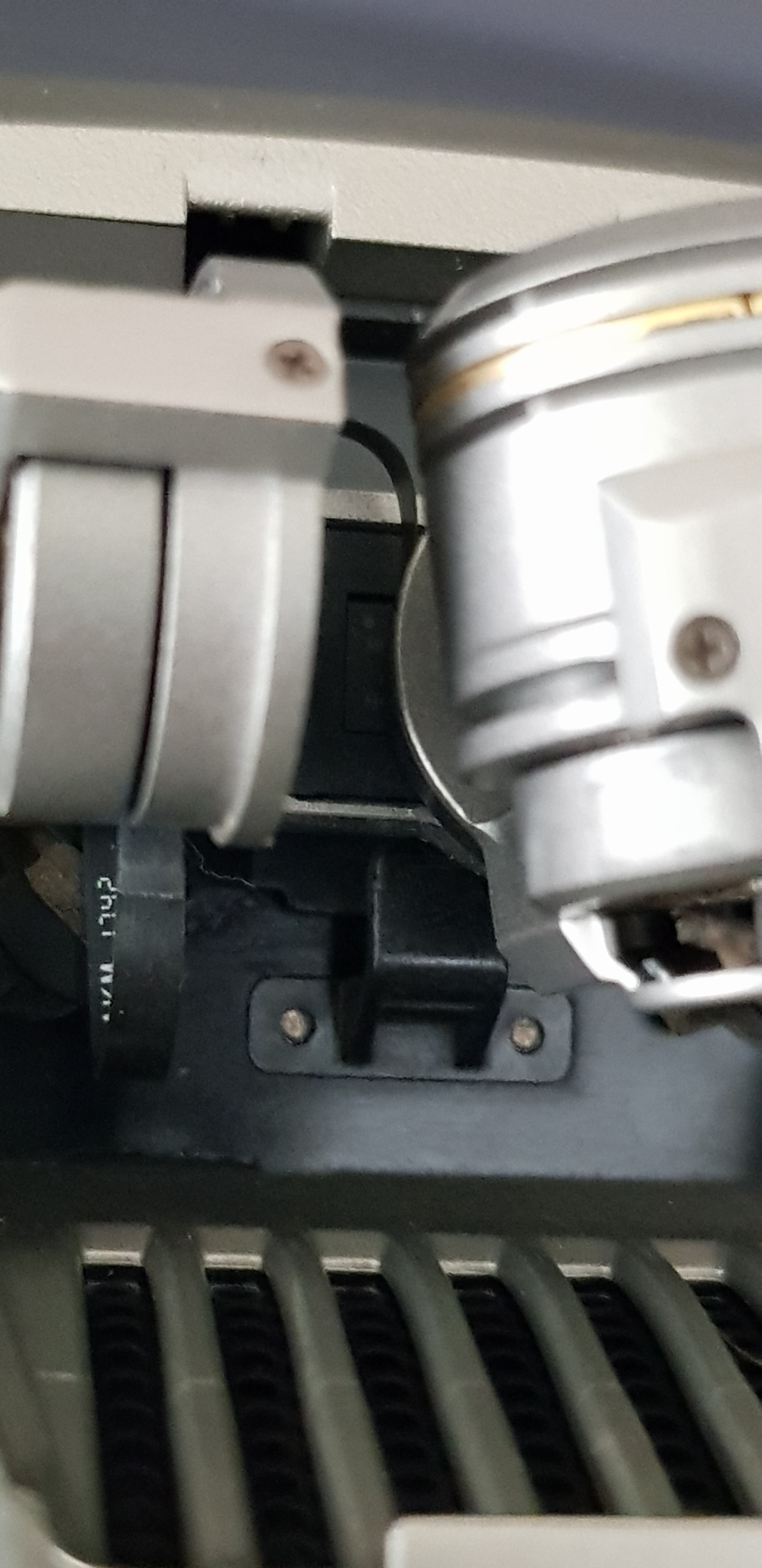

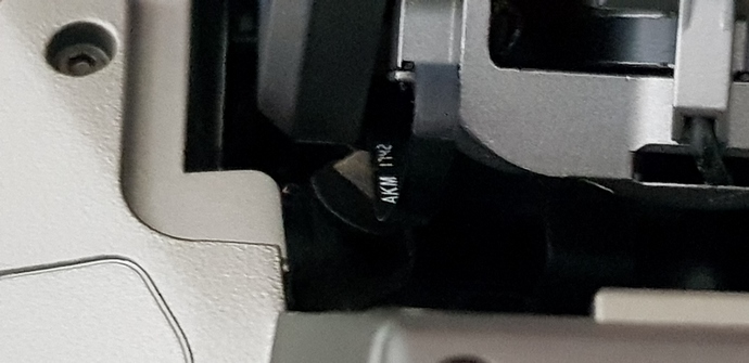

Front had those elasticky things, rear right defo has one, but I cannot be so sure of the rear left as there is a cover and gimble lisghtly over it.
Will calibrate again
With the camera pointing to the MP’s front, all four elastics should be visible OK - you’ve taken a pic of the least easy to see since there’s that ribbon cable above it.
Check all three strands are present, none broken … as indicated with the three marks.

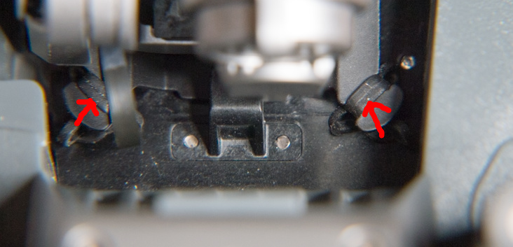

All four suspension bands should be visible … as in these pics.
… but, more tricky - check that each is undamaged and has those three strands - as indicated in a previous pic.
Yes its a bit tricky with someone with bad eyes :slight_smile: but i am trying to see if the strings are on it

if you can’t see make sure aircraft is turned off and gently move the gimbal with fingers and take pics
