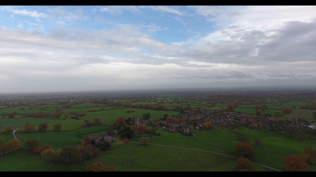

Here’s my first video shot on a P4.
ALL comments and critique welcomed.
Very nice! Which village is that? I notice you didn’t shoot any downwards shots? Any reason for that?
Tom, thanks!
Ightfield, near Whitchurch, flew out of our garden. As I say, first video on a new to me P4 so still getting the hang of it.
Nice first video.
Tilt your camera down slightly rather than having your horizon in middle, as your props are showing, look at rule of thirds.
Look at maybe using ND filters to get your shutter speed to twice your frames per second in manual, this will help hide your props again and give a more cinematic feeling, you don’t always have to go manual, we all probably still shoot in auto.
And I also notice your horizon is slightly tilted, a P4 problem with certain firmware, you should be able to rotate the gimbal to correct this depending on your firmware.
HTH

Yes, I can see the sense in dropping the gimbal down, I’d never take a photo like that so why I was happy with this I’ll never know
Filters should be here tomorrow with any luck.
I’ll take a look at that camera angle later.

The idea with the garden take if was to get the shot of the church as I climbed, point taken though. Yes, I had the idea of a fade out whilst the soundtrack ended, should have extended the fade out time to match.
Getting feedback like this is great - thanks!
Yes, but also wanted to get the church in the shot as I climb out. Good point re garden though - greenhouse looks really naff in hindsight

Movavi, only installed it today so this a first, first. Yes, I reckon that I rushed this a bit, must take more time and pay more attention to the transitions, they really do stick out - particularly one of the church.

Hmmm, interesting point re transitions and I couldn’t quite put my finger on it when I watched it first time round but after watching it again, I think I see what the issue is.
Some of the transitions come towards the viewer, yet the end part of the transition actually saw the drone either sat still in the air, then starting to move forwards - or, the drone was actually further back than when the transition started… if that makes sense?
It confused my brain
(granted, not hard to do these days…)
Yes, reviewing it there’s a right mish-mash of transitions, going to have to do a lot better next time

I guess, looking at the video that you were either travelling forward at speed, or heading into wind, which is why your props are showing a lot.
Simple mistake we have all done, if you slow down the drone.
Then in post, speed up the video playback, same result, but, more cinematic.

Thanks for the excellent advice re slowing down the flight and then increasing playback speed - would’ve taken nme a long tiime to appreciate that without the nod!
Yes, it was pretty windy that day, and a previous wellwisjer advised me to head out into the wind so that I’d have an easier time coming back with a depleted battery - more advice I’ve taken on board vfrom this forum:grin:
