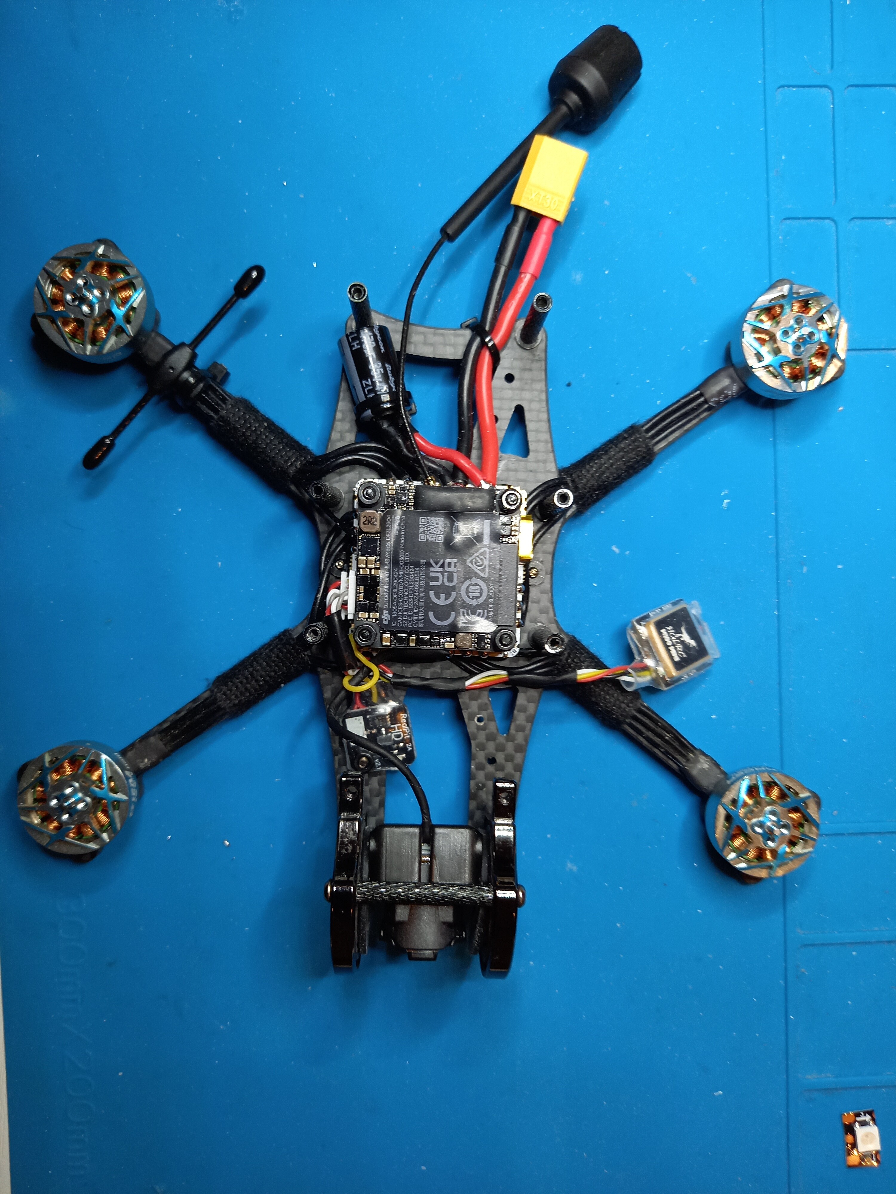

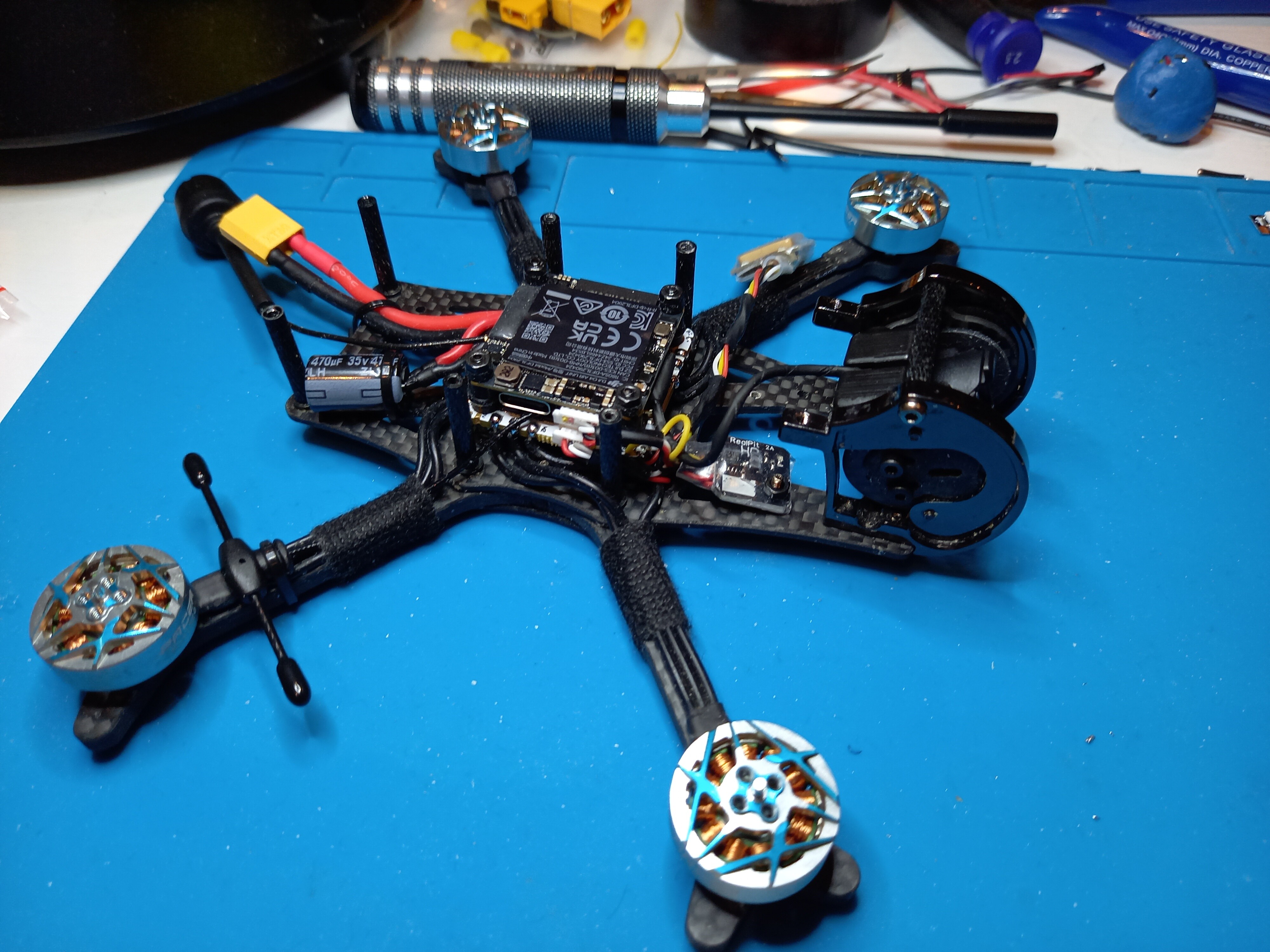

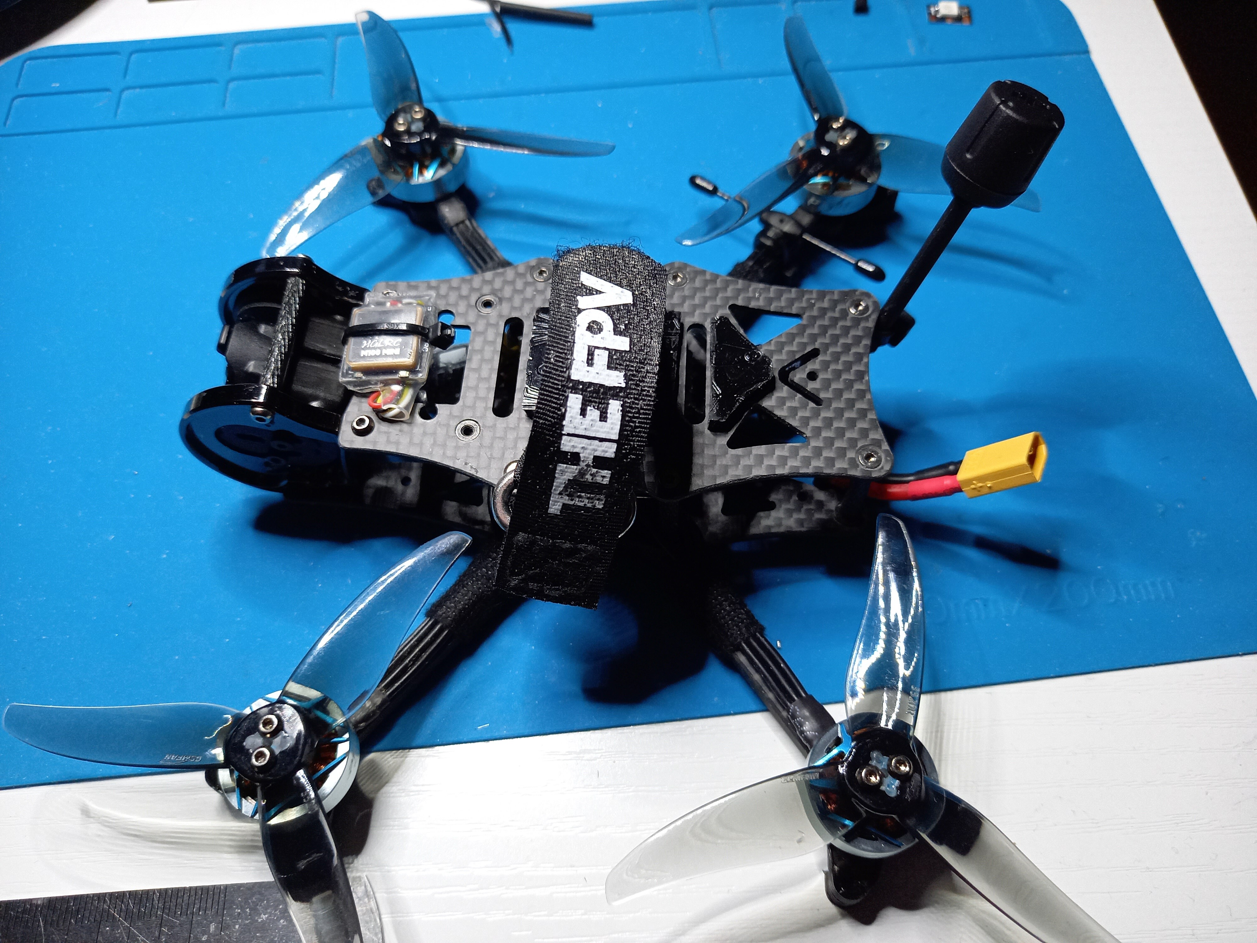

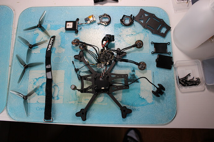

Refresh of my first ever build (new AIO + 1 new motor) and migrated from a Walksnail mini to the O4 with the Flywoo mod. Stole an O4 Pro antenna to see how it compares to the small linear one on the Firefly. Also curious to see how the ‘mini’ M10 GPS will fare :crossed_fingers:
240g AUW with a 6S 550mAh battery running some 1604 - still one of my favorite combo
Managed to get a couple of test flights before the rain came in - all good apart from the GPS giving a grand total of 3 sats after 10mn+ :sweat_smile: – Oscar gives it a good review so may try to reposition but looks like it will more likely need to be upgraded
Stick it on an arm like the RC Antenna, different arm of course :laughing:
I’ve got a 180size on the arm of my 7” and it works a treat :smiley:

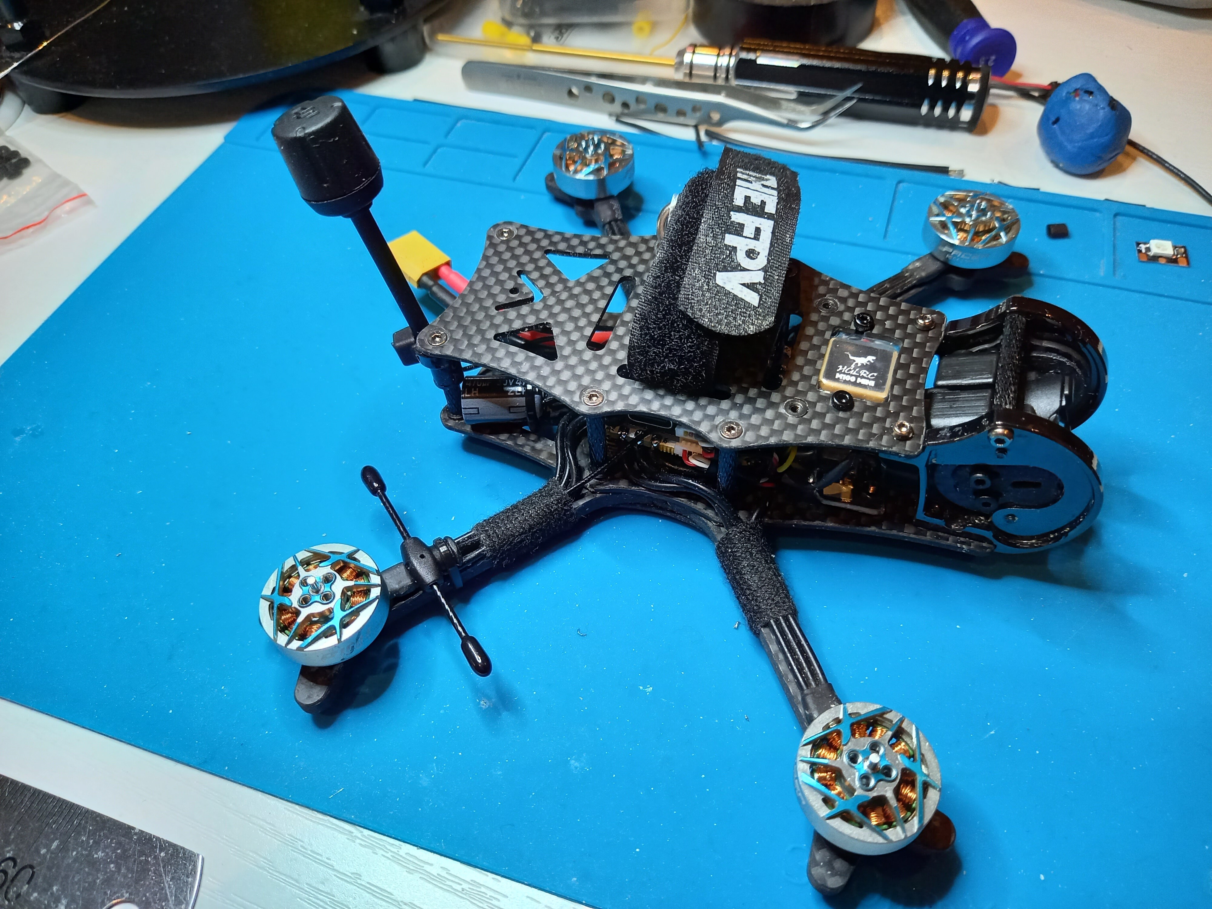

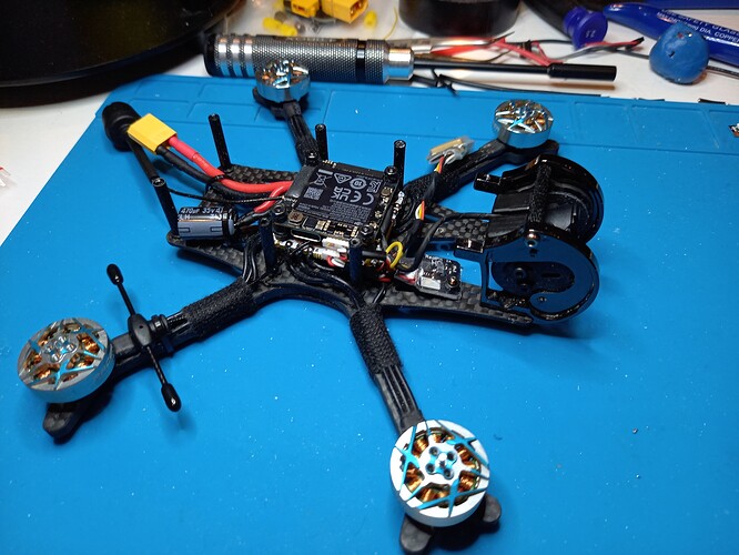

Not much success on there - arms must be too short and motors seem to also impact the number of sats. Got it back on the body but this time out of the carbon frame and now getting 15 sats :flexed_biceps: - which is better than I expected (this is a tiny M100 :slight_smile: ) – it really did not like to be flush with the carbon :sweat_smile:
HGLRC M100 Mini - “approved” :slight_smile:

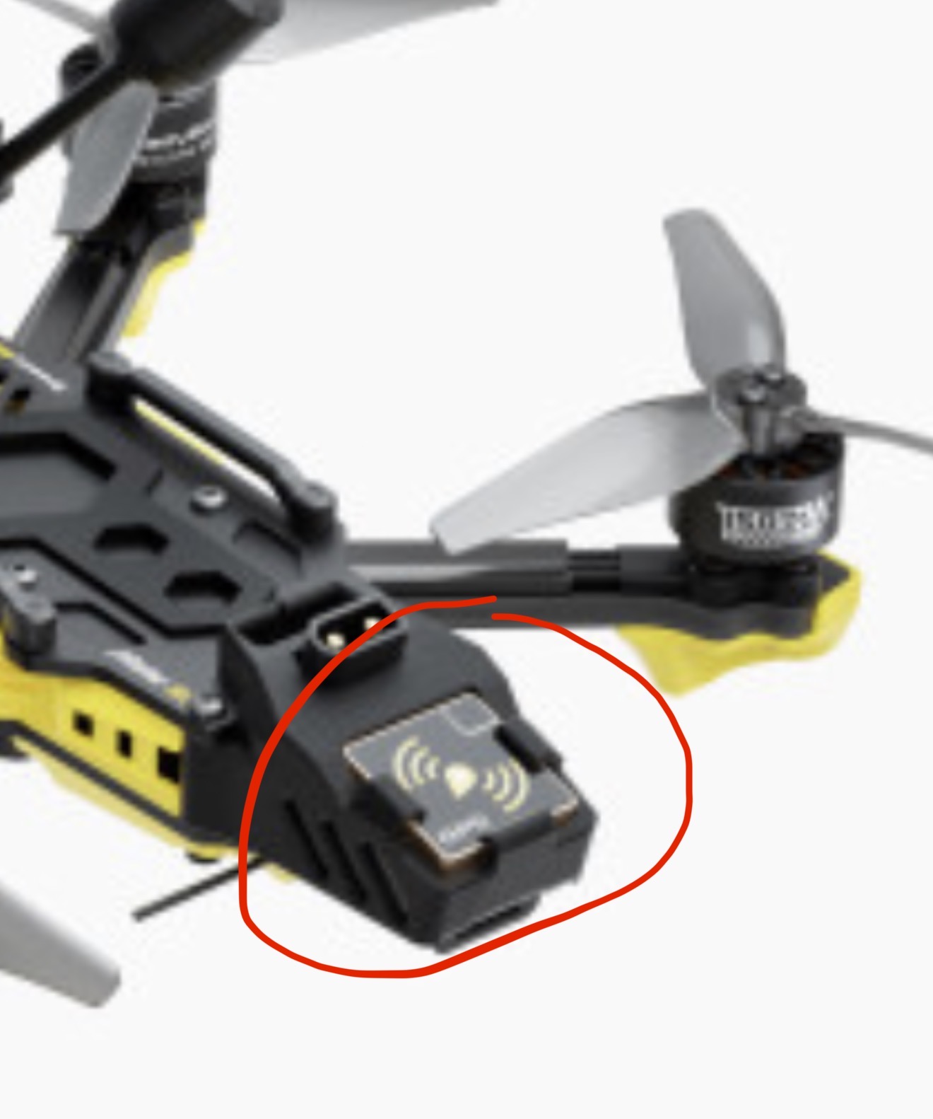

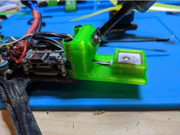

What about trying a TPU mount, so the GPS module sticks out the rear of quad?
Something like this -
Here’s one that may fit your quad, however it wouldn’t take too long to remix it to fit yours.

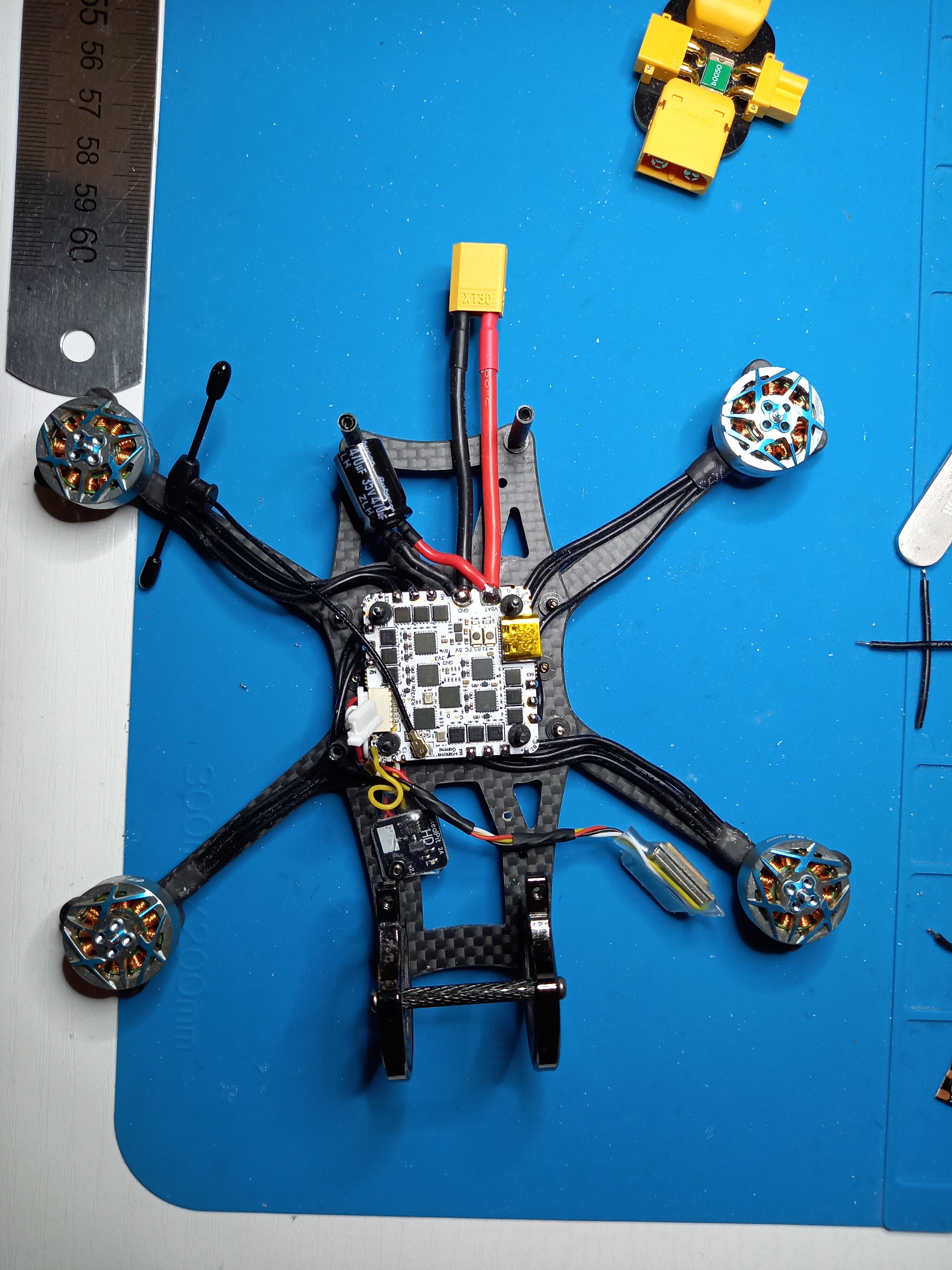

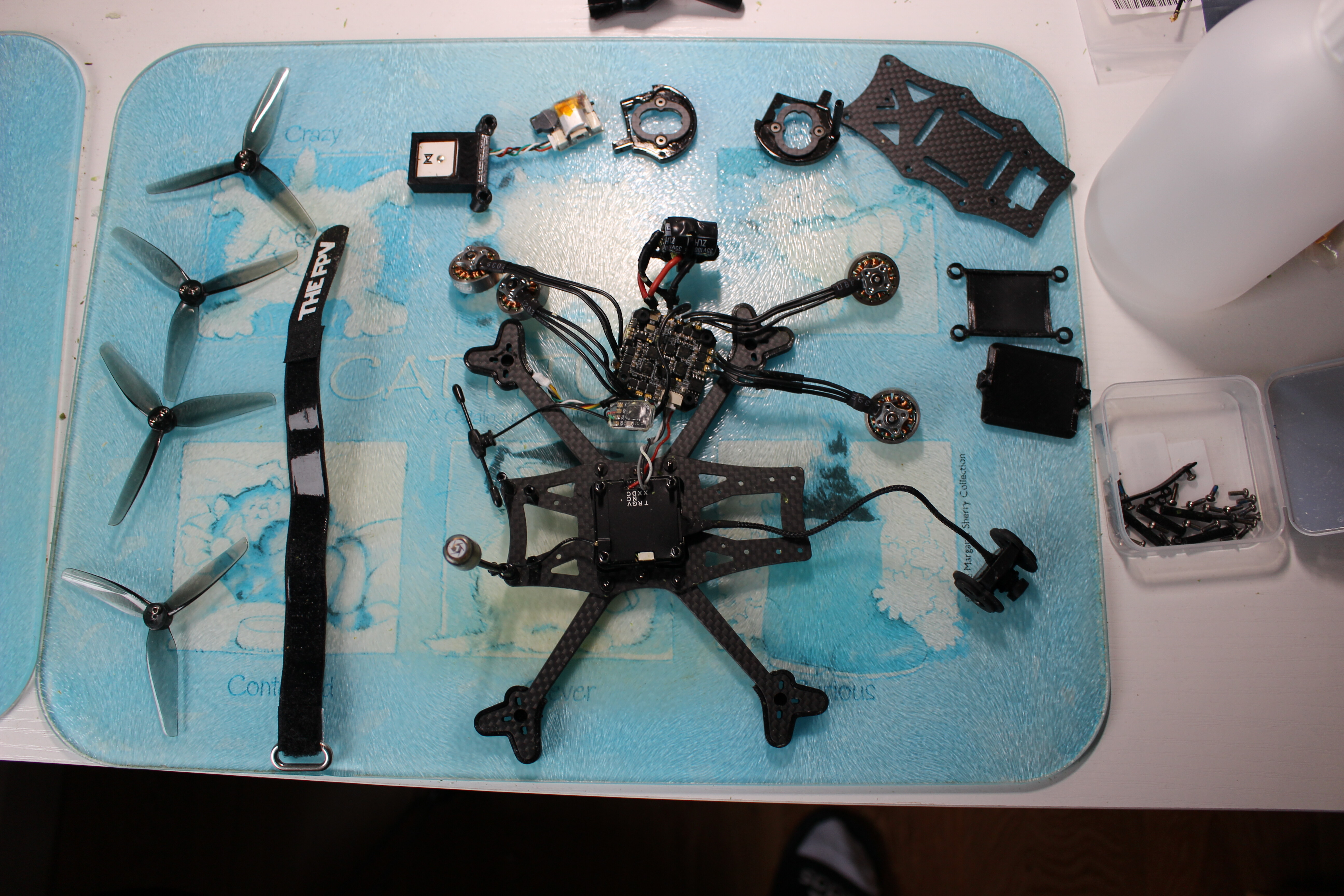

Yeah - I have one of those - it was on before the refresh (with a ‘big’ M10 GPS and even a GPS Mate - see exploded pic of a cleanup a little while back) – I wanted to get rid of as much weight as possible (quad was nearly 280g with a tiny 14mm cam) as well as trying a ‘mini’ GPS and getting rid of the GPS Mate and as much TPU as possible.
I will run some more tests with the mini GPS - so small/light it could be added to some smaller quad - I have a 3" 3S toothpick/Firefly hybrid in mind that could beat some speed record :wink:

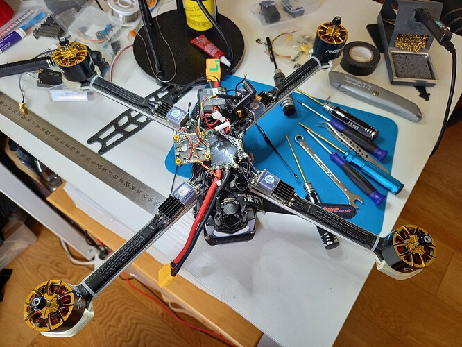

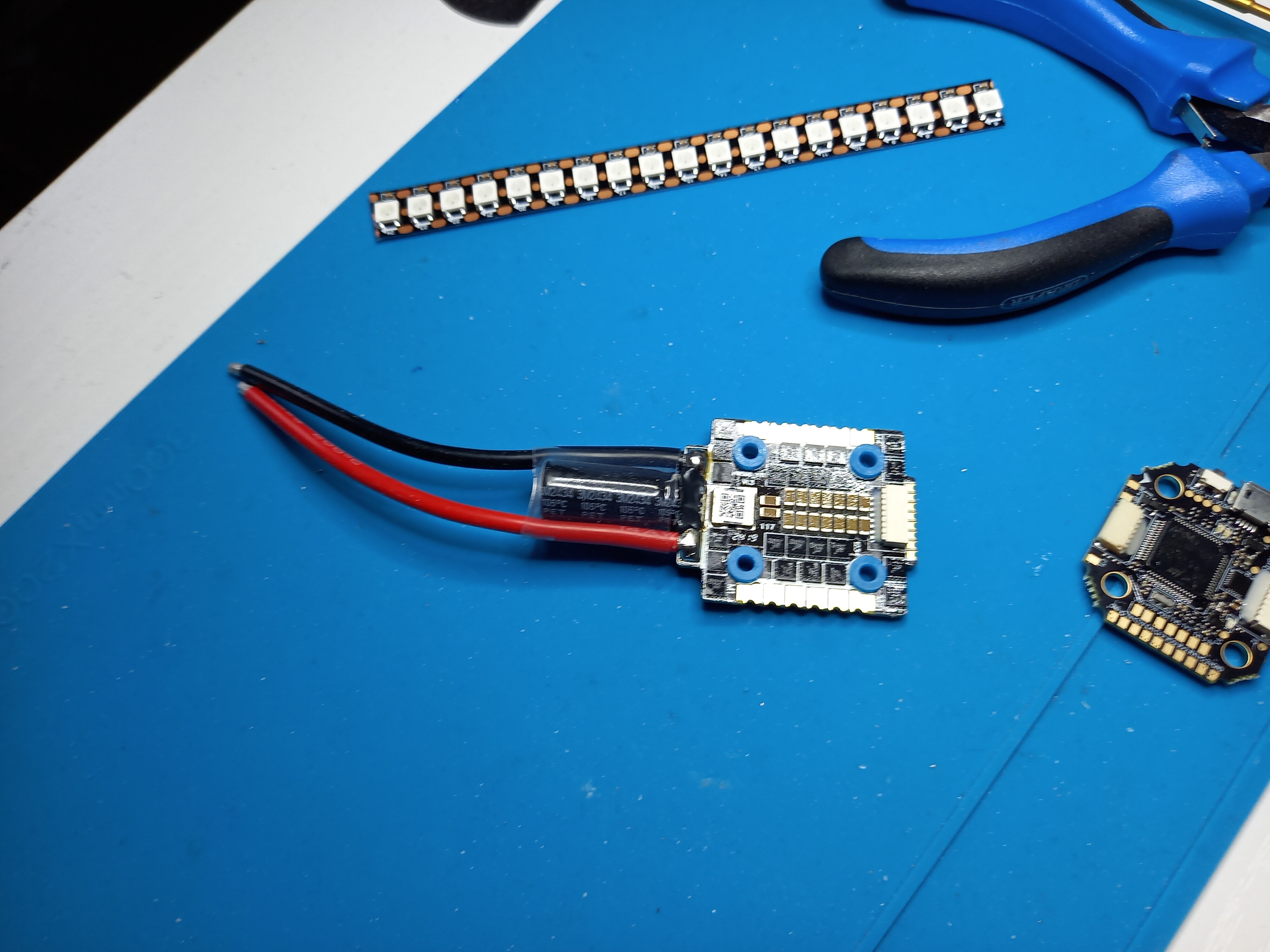

Unpacking a Hobbywing 20x20 ESC and they are shipping it with a huge cap and power cables soldered on and covered in insulation… What a daft idea - need to remove it all to start with :man_facepalming:

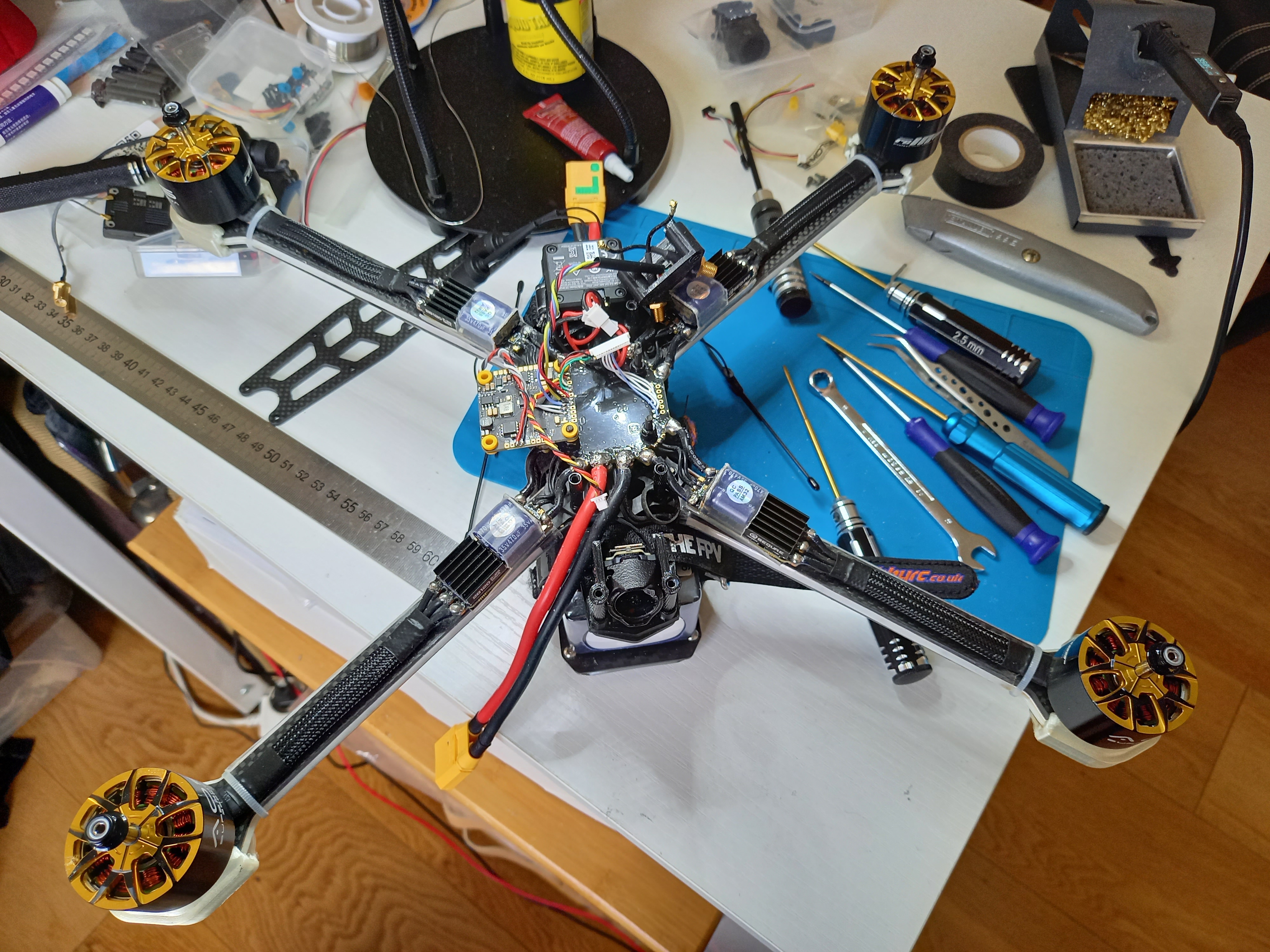

Moving the Super G 10 to a DJI O4 Pro – Took longer than expected to get there but I can see the finish line now :sweat_smile:
Bro are they heatsinks on the ESC :astonished_face:
yep - here down South it gets hot :wink: :smiley:
