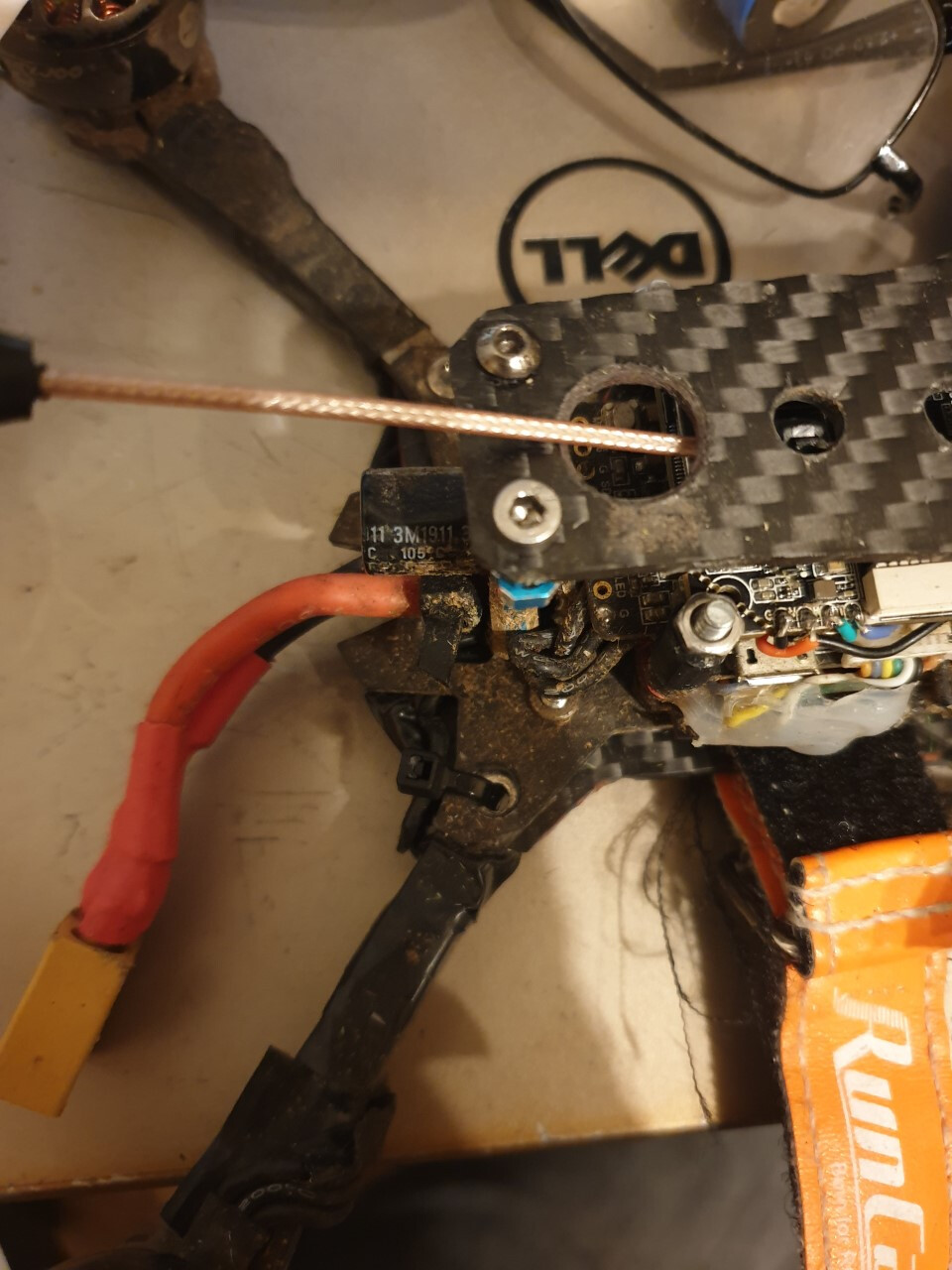

Thanks to @notveryprettyboy for getting the LiPo disconncted quickly, he tells me it was bloody hot ![]()
It looks a little hot!
Buxxer, Motor is shaxxed
UMT have NO stock ![]()
Neither have HobbyRC

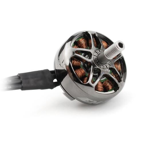

So upping the size to 2807 and gettting four of these;
I’ve got these Emax ECO II series motors on another quad and they haven’t given me any trouble, so at this price worth a punt ![]()
Ah, I’ve added 4 of those 2807s to my basket a number of times as part of a 7" build and keep chickening out.

I’ve just finished fitting my 2807 motors, will be flying them tomorrow with @notveryprettyboy & @DeanoG60 (if he’ll be let out to play, sorry I mean, if he’s finished his decorating TeHe)
I’m impressed by the build quality of them for the price, magnets seem strong (plenty of cogging)

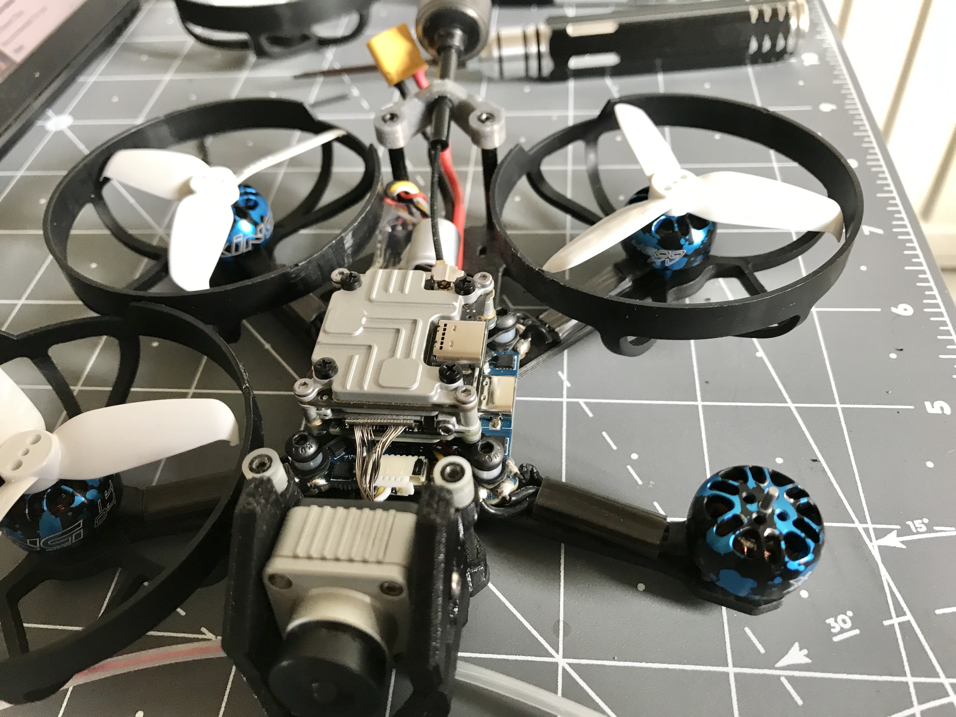

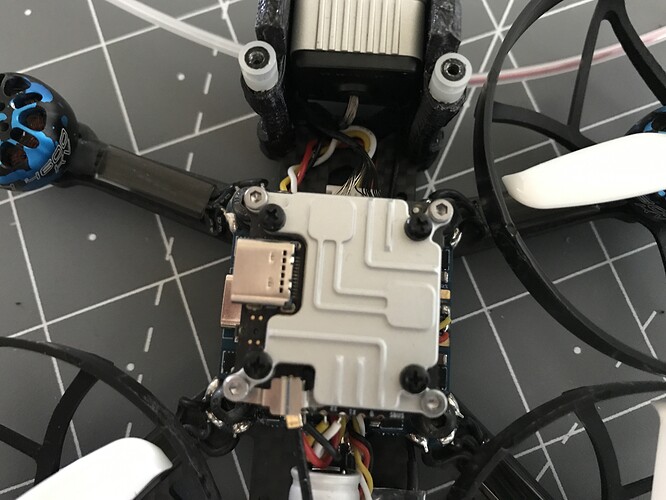

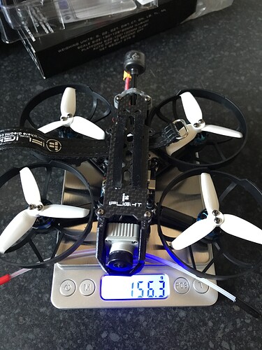

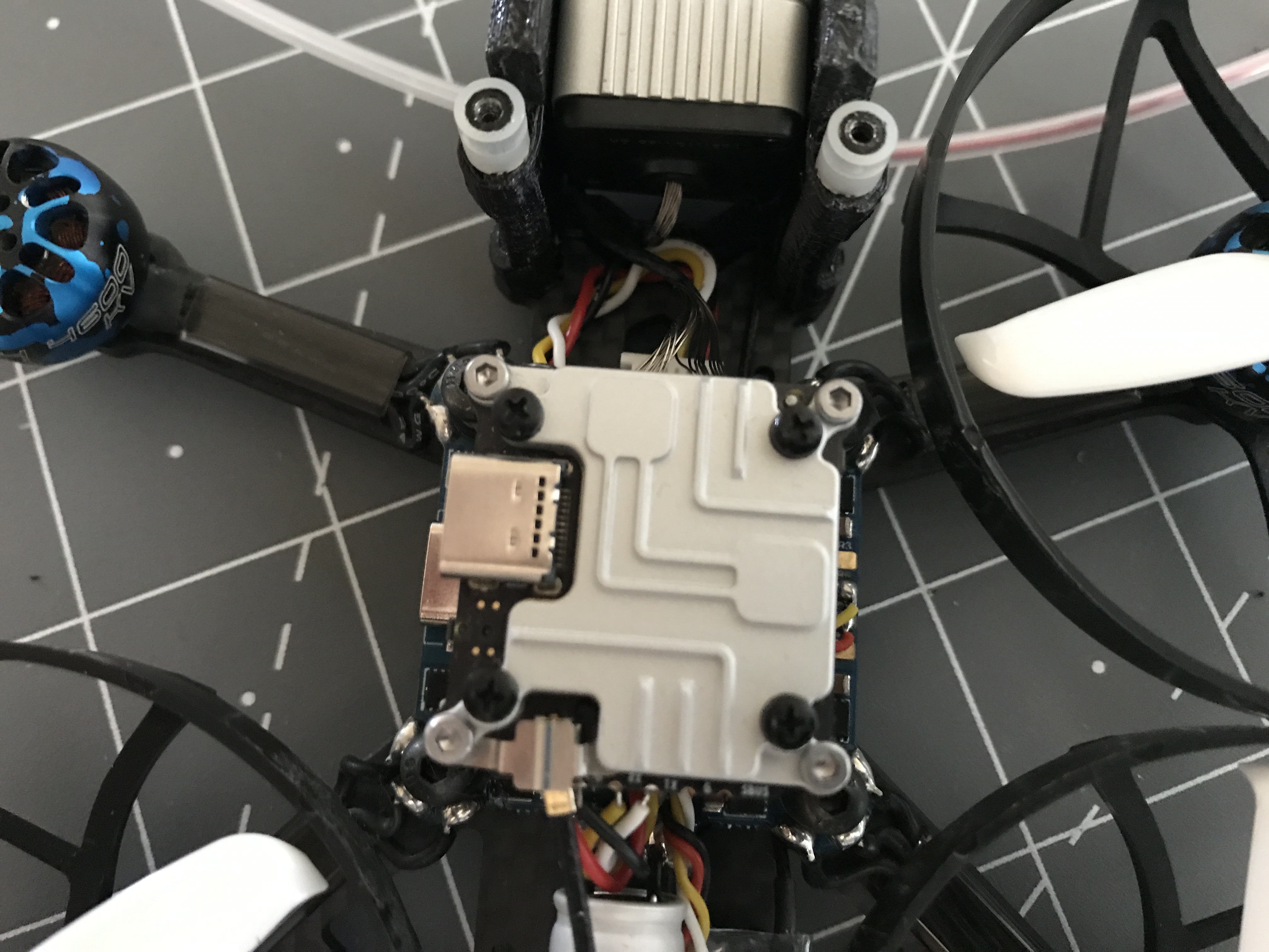

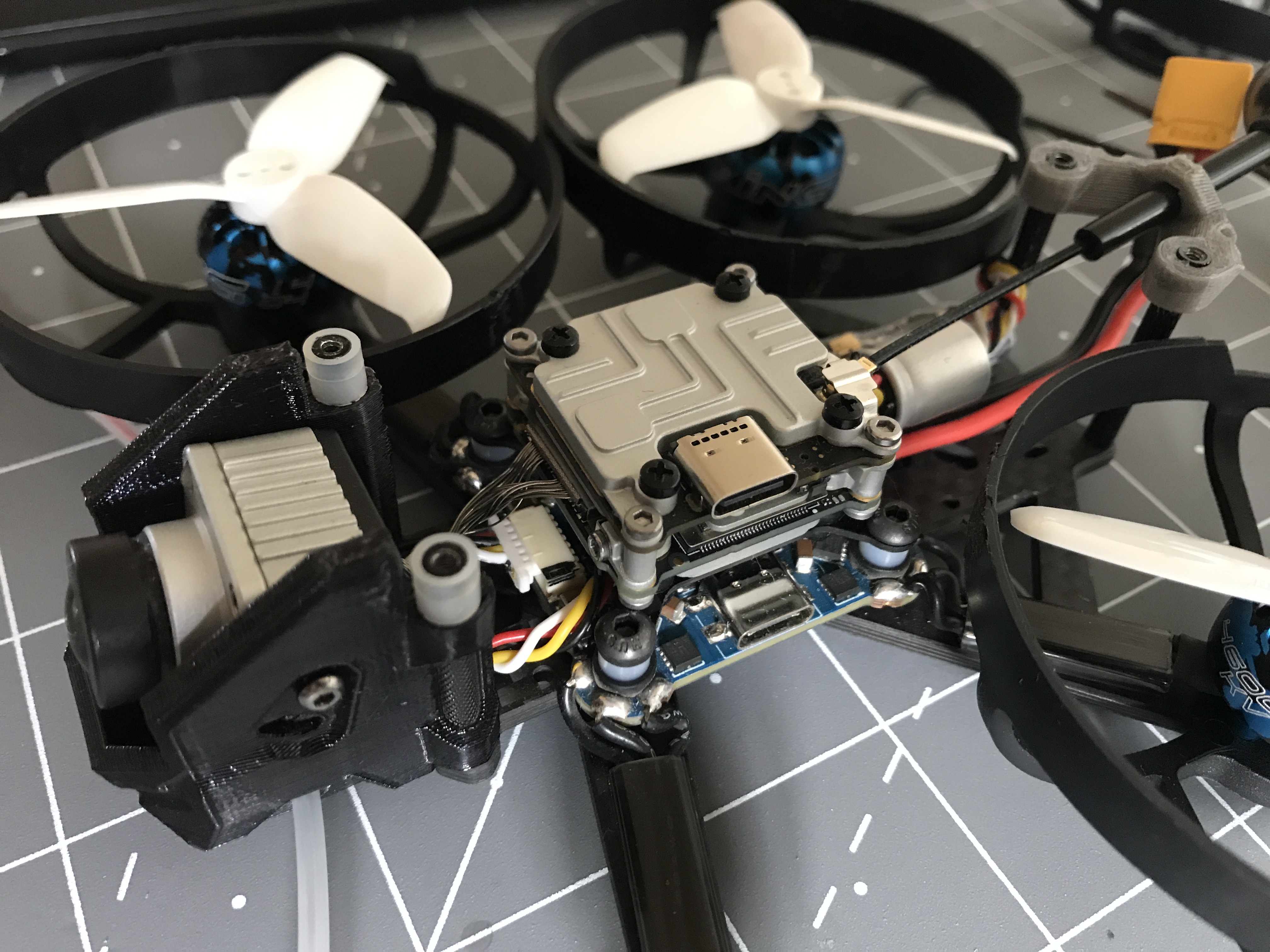

This isn’t any longer on my bench, but thought I’d share the conversion of my iFlight DC2.
It was my first quad after entering the hobby just after DJI released their FPV digital goggles. I “researched” long and hard and settled on the more expensive (but future proofed) digital route. BnF manufacturers had just started making digital sub 250 models, but the only available solution was the DJI air unit.
At that point I had no idea what weight does to a sub 250g quad.
I ordered my DJI FPV goggles, a Radiomaster T16 S with crossfire, and an iFlight DC2. The time and frustration I suffered to get all this new kit playing nicely together is another story!
One of the reasons I bought the DC2 is I saw a YouTube video of someone flying it in their house, and saying it’s ok to fly inside or outside. Great, I can learn to fly my 4S digital overweight whoop in my flat I thought!
It was clear straight after arming and a very wobbly hover in my hallway that this wasn’t going to work. It was far too powerful for a complete noob to control inside.
The DC2 is a bit of a strange quad. Standard, it runs 2.3” props in prop guards but is also supplied with a set of 2.5” which fit with the guards removed. For its size it has a oversized power train in order to cope with lifting the weight of the DJI Air Unit and TPU mounts. All on 2.3” props. It’s basically too heavy.
So after one hover I decided to change the Air Unit for a Vista. Changed the prop guards so I’m now able to run 2.5” Gemfan props. Removed the Crossfire antenna TPU mount and remounted a new lighter antenna up front. It’s now 30g lighter, with bigger props, and flys great
Some bench pics.

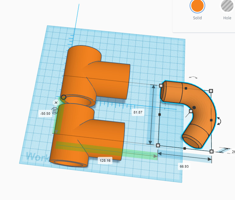

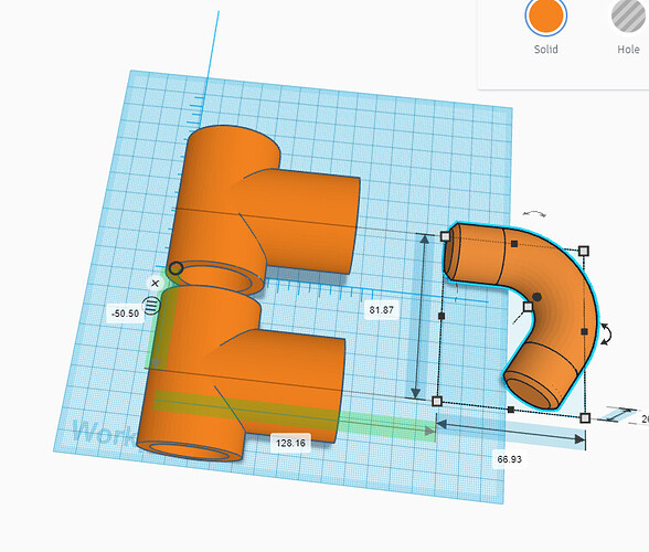

To try and improve my throttle control and low level manoeuvres, I am making use of some 6’ fluorescent poles I salvaged from my lads rugby ground.
Together with some 3d printed connectors, I should be able to make a race gate for our club field.

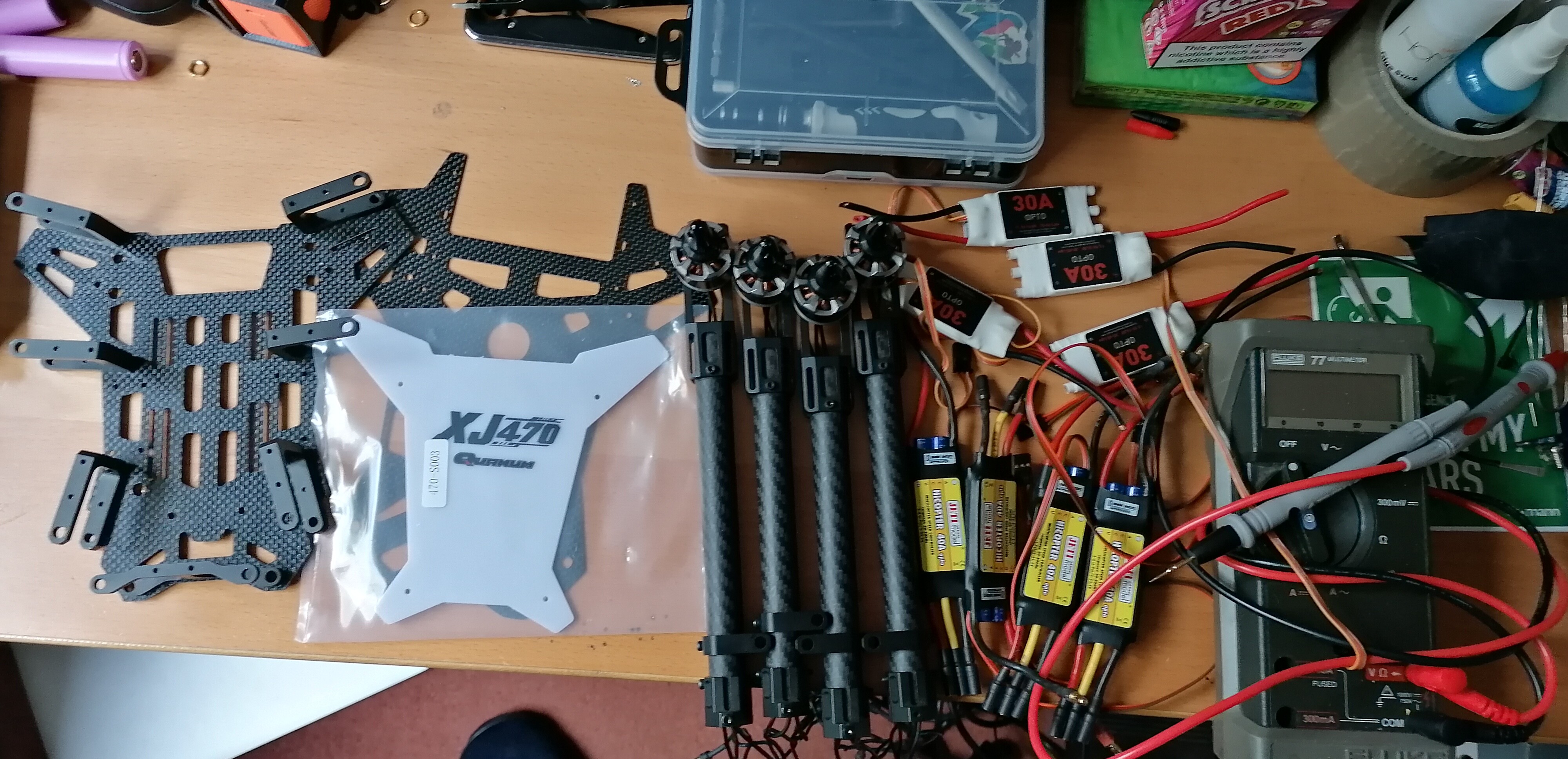

Today is a good day as I’ve managed to put my pants on by myself, though I still need pharmaceutical assistance to move about . So to celebrate I’ve decided to make a start on the Quanum X470. I’ve had a rummage in my bit’s box and gone with 4xT-Motor 2208 1100kV motors spinning 10x4.5 props, a Pixhawk FC, but I’m in two minds as whether to use the DJI 30Amp Opto’s (3s-4s) and use the Jeti HiCopter 40Amp (2s-6s) for a bigger build project.
I may also fit FPV gear to it but I’m not going the camera drone route as I want to use this to experiment with LiDAR and Optical Flow.

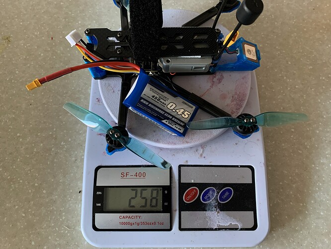

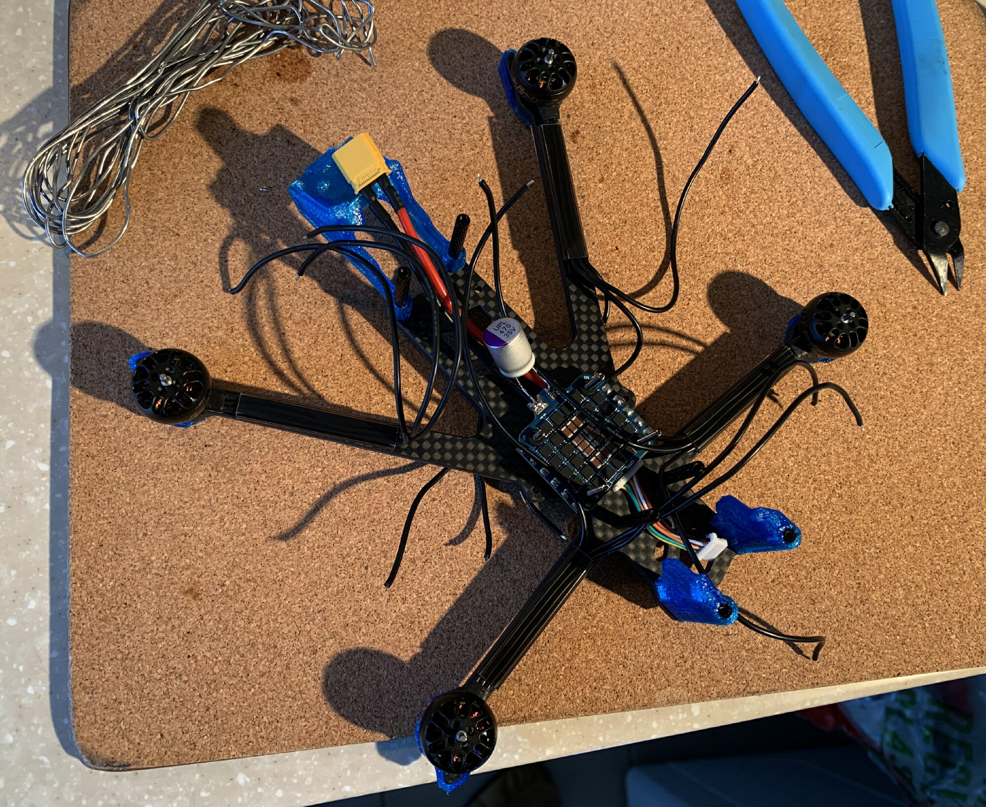

Sooo close to 250g - of course it would be under 250g if I’d bought a Caddx Vista for it, but I already had the DJI unit. Weight goes up to 278g with a 650mAh, and 291g with an 850mAh.
( iFlight Chimera 4 Deadcat )
