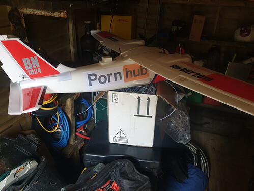

3D printed plane is coming along nicely.
Things are starting to work. Flight controller, receiver, servos, ESC, GPS, motor, control surfaces and landing gear all work.
Camera and VTX do work, but are not quite ready for fitting yet. It looks like I’ll need new batteries as the ones I have are either too big or too small.

I would have tested it outside… but by the time I got the 3D printed wheels on it was dark.

Haha love that plane :rofl: Looked great on the live feed yesterday when @DeanoG60 was chasing you :ok_hand:t2:
Thank you. It really is nice to fly. I’ll take it to the seaside next year
Make sure you post some nice coastal vids :star_struck:
Class stickers :wink: and love the plane but Karl can you explain this :point_down: :grinning:
