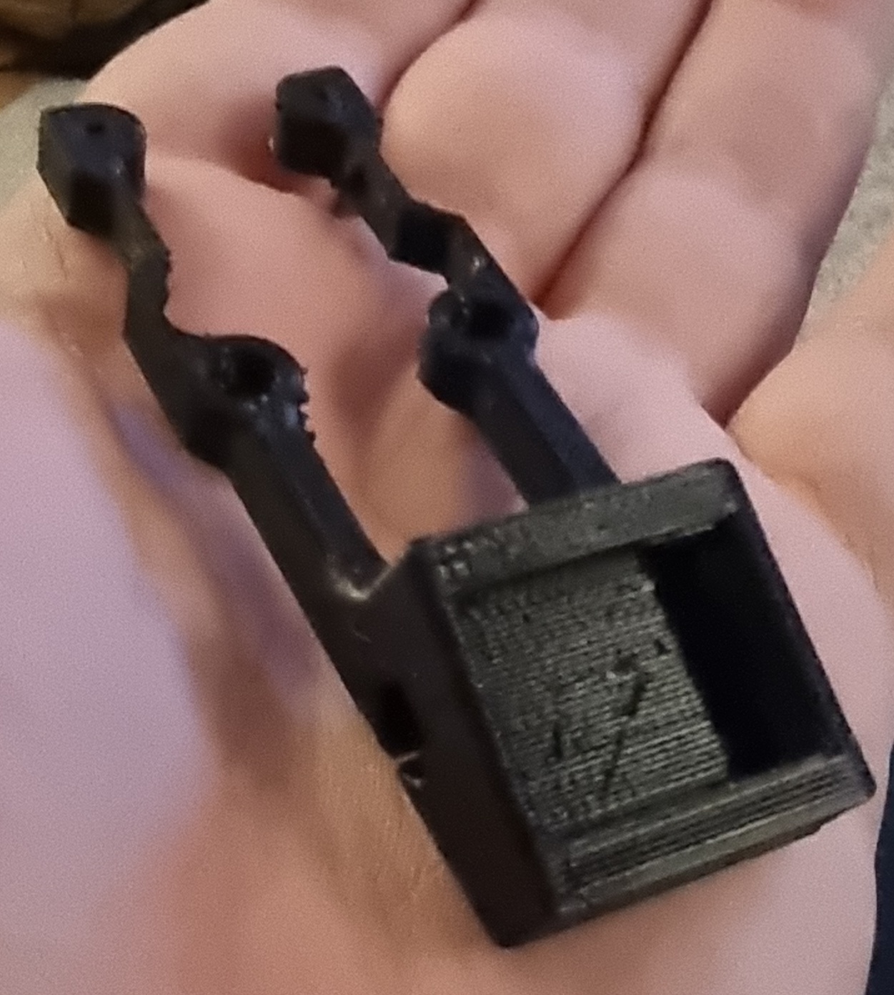

If you want anything printing Jez just ask ![]()
In fact I’ve actually just sliced that exact GPS mount for @SirGunner so its already loaded in my printer ![]()
I’ll print a couple out and I’ll give it you next meet ![]()
You’re a star. Thanks.

All printed Jez @Earwig will throw it in my drone bag, remind me to pass it on next meet ![]()
Awesome, ta.
That deserves a beer, or a coffee or something.
Nah man, don’t worry about it pal. Just pass on the kindness ![]()
