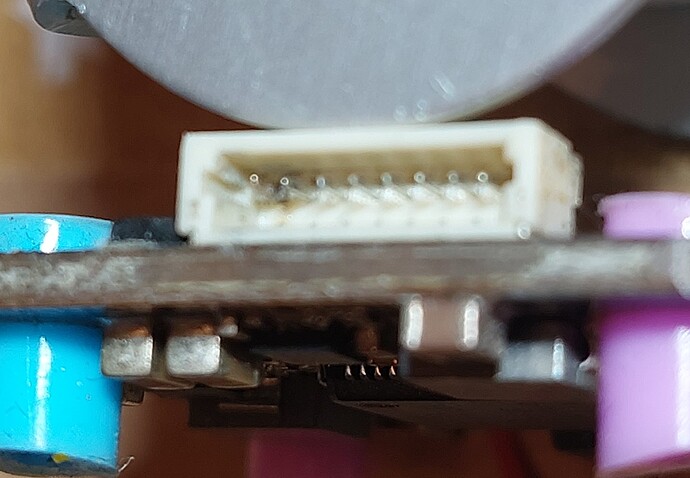

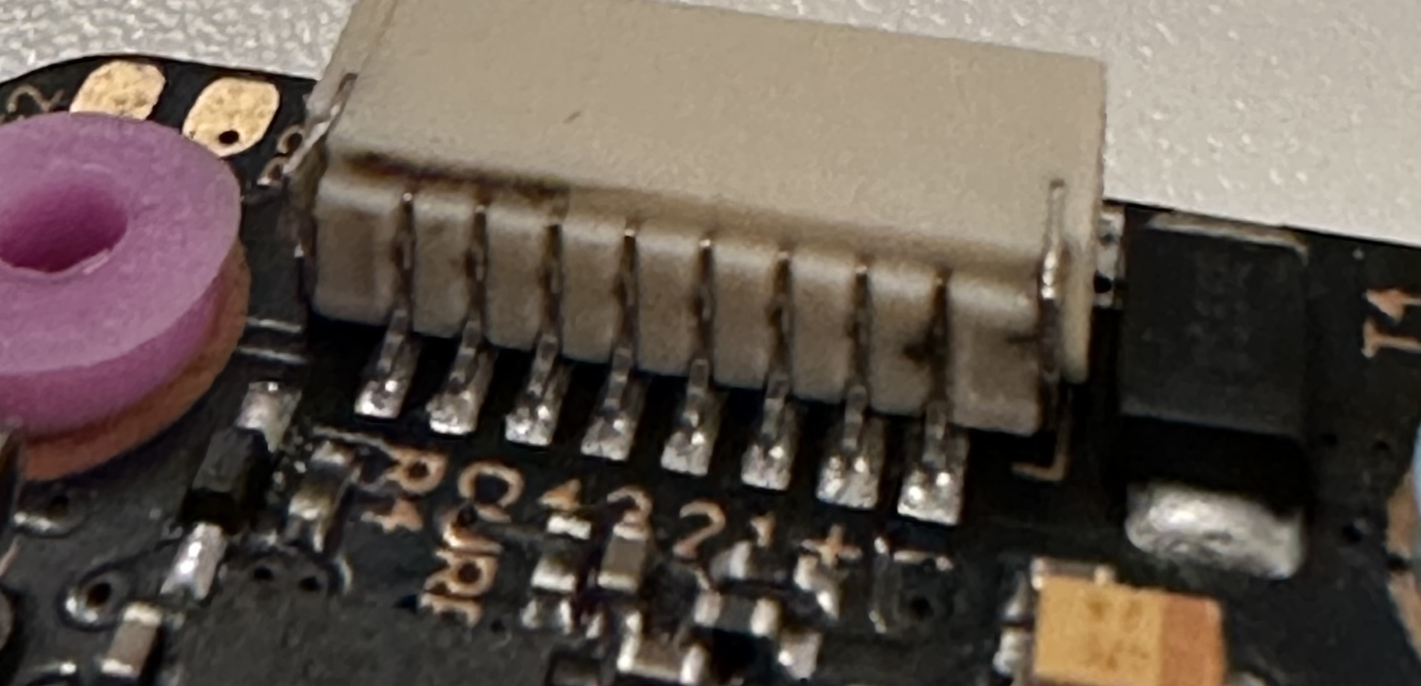

Its not the best of pics basically its the voltage pin for the FC, not sure how im going to fix this :man_facepalming:t3: maybe tag on to the back…
Wont it clean up? I use a toothbrush and alcohol cleaner. But something else may have blown
Could give it a go looks a bit melted and your right that might not be the issue I’ll test the back of the pin see if I’ve got power there :+1:t3:

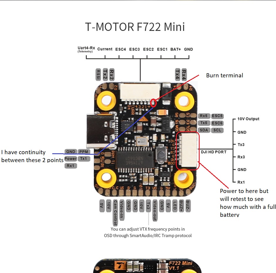

That’s the back of the connector between ESC and FC looks like the negative has burnt
Check continuity between that pin and ground somewhere else on the board.
Iv checked the below Richard, sorry but I’m between devices i.e my phone and laptop whilst doing this.
This the board as its not to clear on my pic’s

Hmmm if im honest not sure myself whether its split between the FC and the ESC ???
When you plug in a battery, do you get lights on the FC? If so and you don’t get the 4th and 5th beep from the motors then it’s got to be something to do with the signals from the FC to the ESC, which are 4 of the other wires on the connector. However it would be strange for them all to stop working as they are completely independent.
If you plug in the battery then get the 3 tones, then plug the FC into your USB port on the PC, does the FC boot up (lights on). Do you then get the remaining 2 beeps from the motors? Or for that matter, do it the other way around. plug in the FC into the PC and then the battery into the ESC.
Thanks Richard,and no lights on when battery plugged in but there is power around the board???
