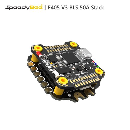

If you do need a new stack I recently bought one of these, even cheaper now at £50!
Select FC & ESC.
