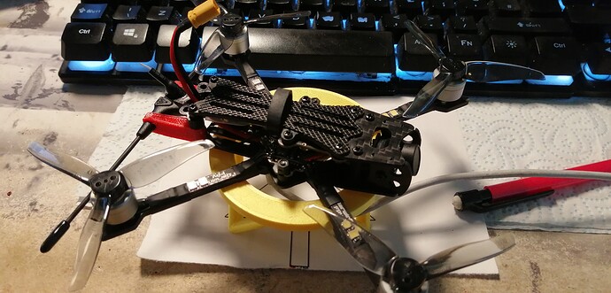

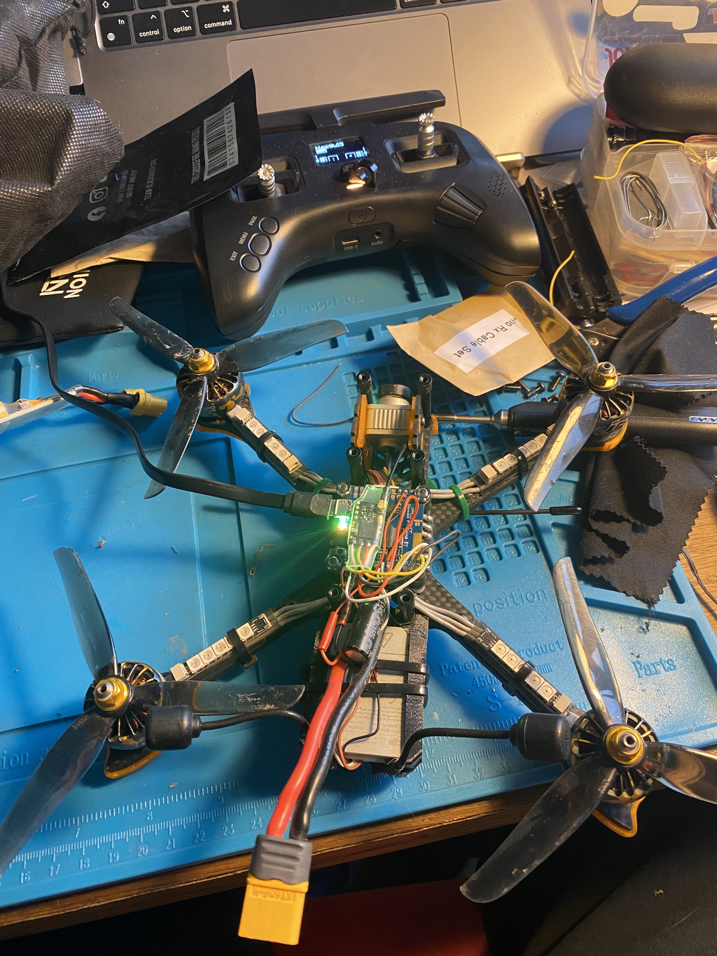

I thought this was going to be on my bench for a while, getting the CRSF RX on and everything configured, but it was actually less than half an hour.

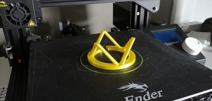

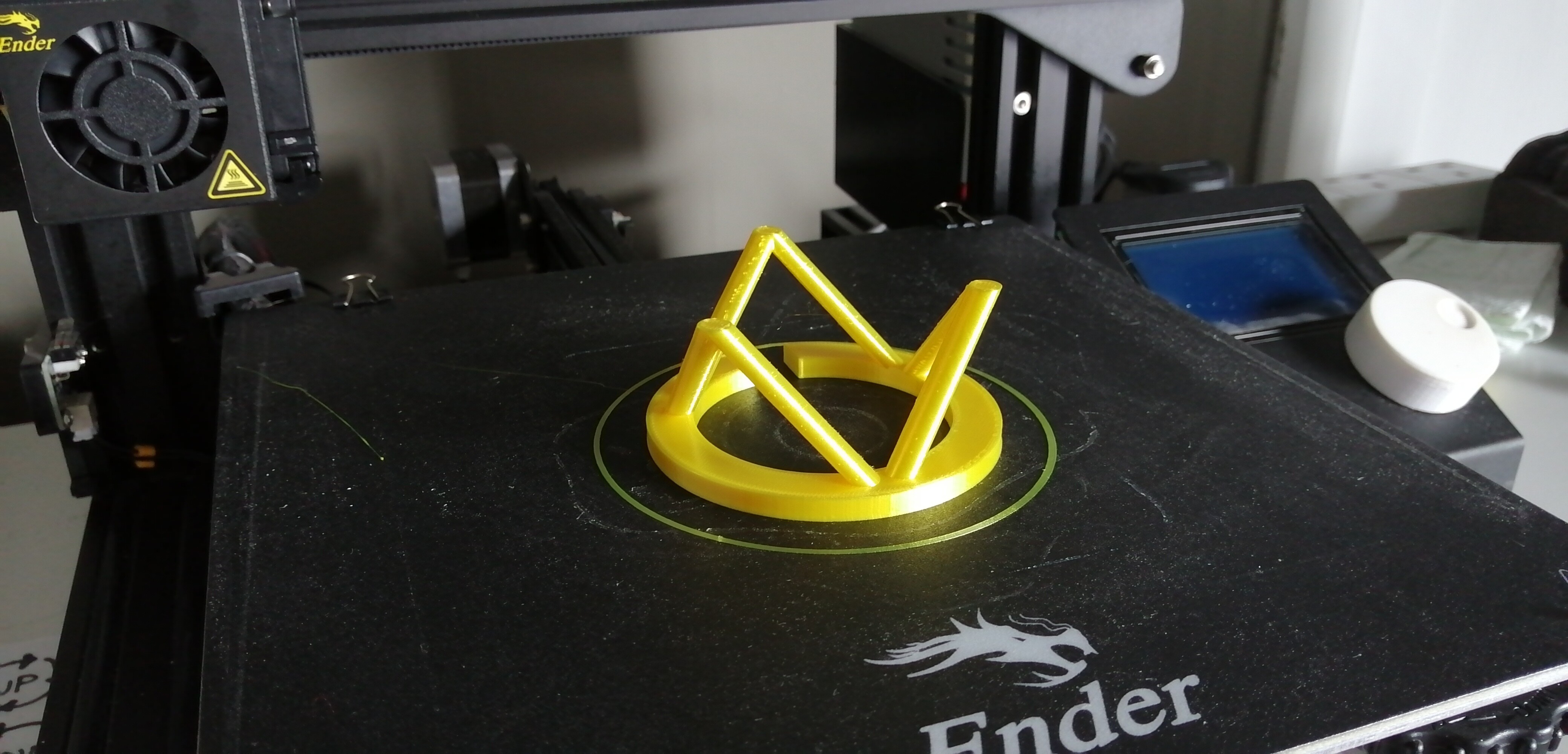

Having the USB port underneath is a little annoying, so I printed a stand for it.
I discovered during the “props out” reconfig that it has Bluejay on it, so the next task is to compose a suitable, 4 part harmony, start-up melody. :laughing:

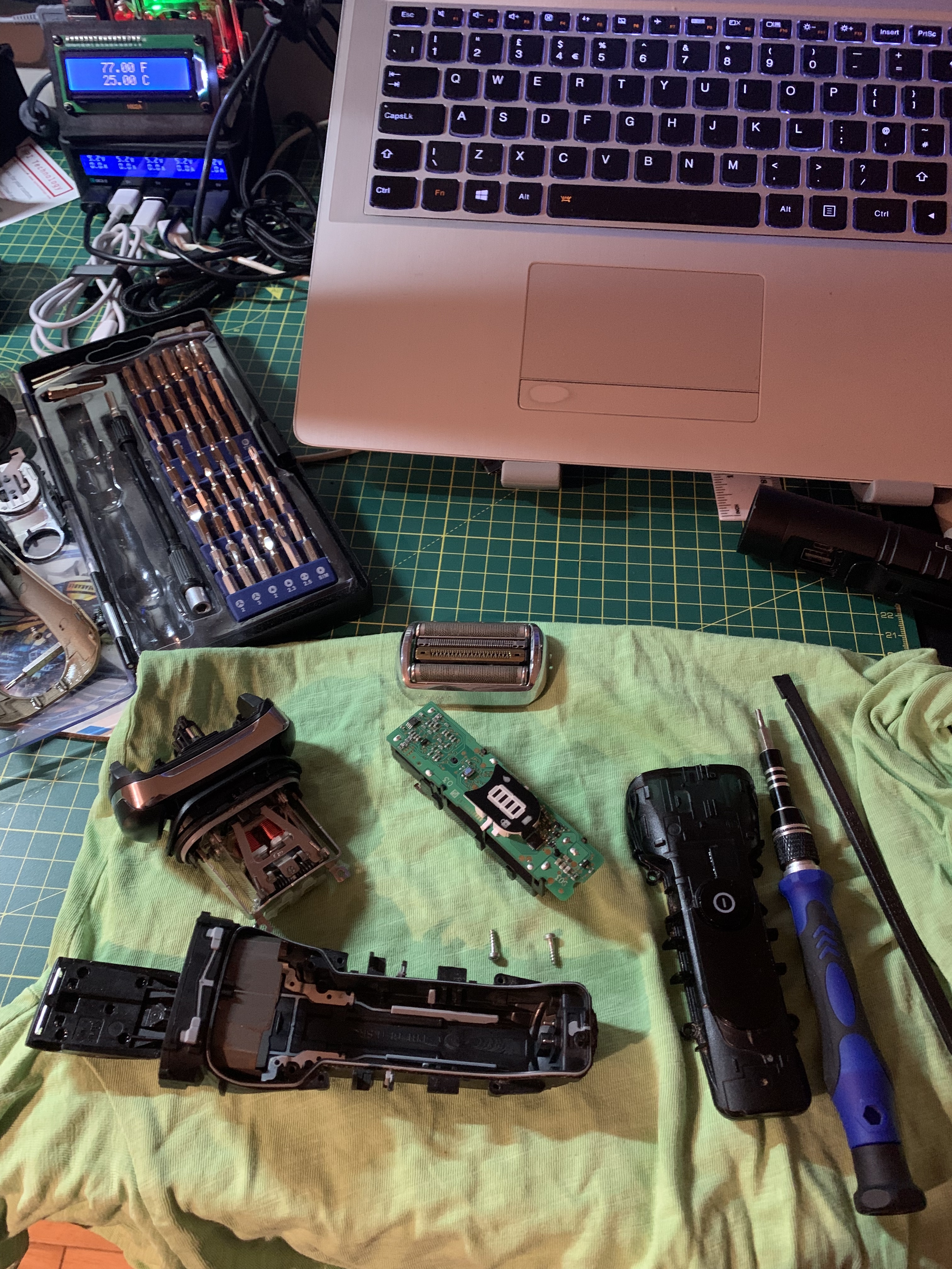

Me shaver :cry:
I’ll be on the bench soon after another few of these…mm
Hah… had the same ordeal a while back to change batteries of a very similar model to that… Everything to make consumers buy a new kit instead of just making it easy to swap batteries for a few quid… greedy bastards
Tell you what though, having had experienced some maintenance on the drones definitely gave me much more confidence to open it up and do the job…
The battery on this one just pops out :grin:

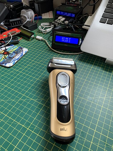

The problem was water ingress on the switch, its back working now :+1:
Lucky you then. I had to open pretty much like in your picture just to access the batteries, and then de-solder them, solder the new ones back and close everything up again… totally unnecessary.
Switch fixed and shaver serviced

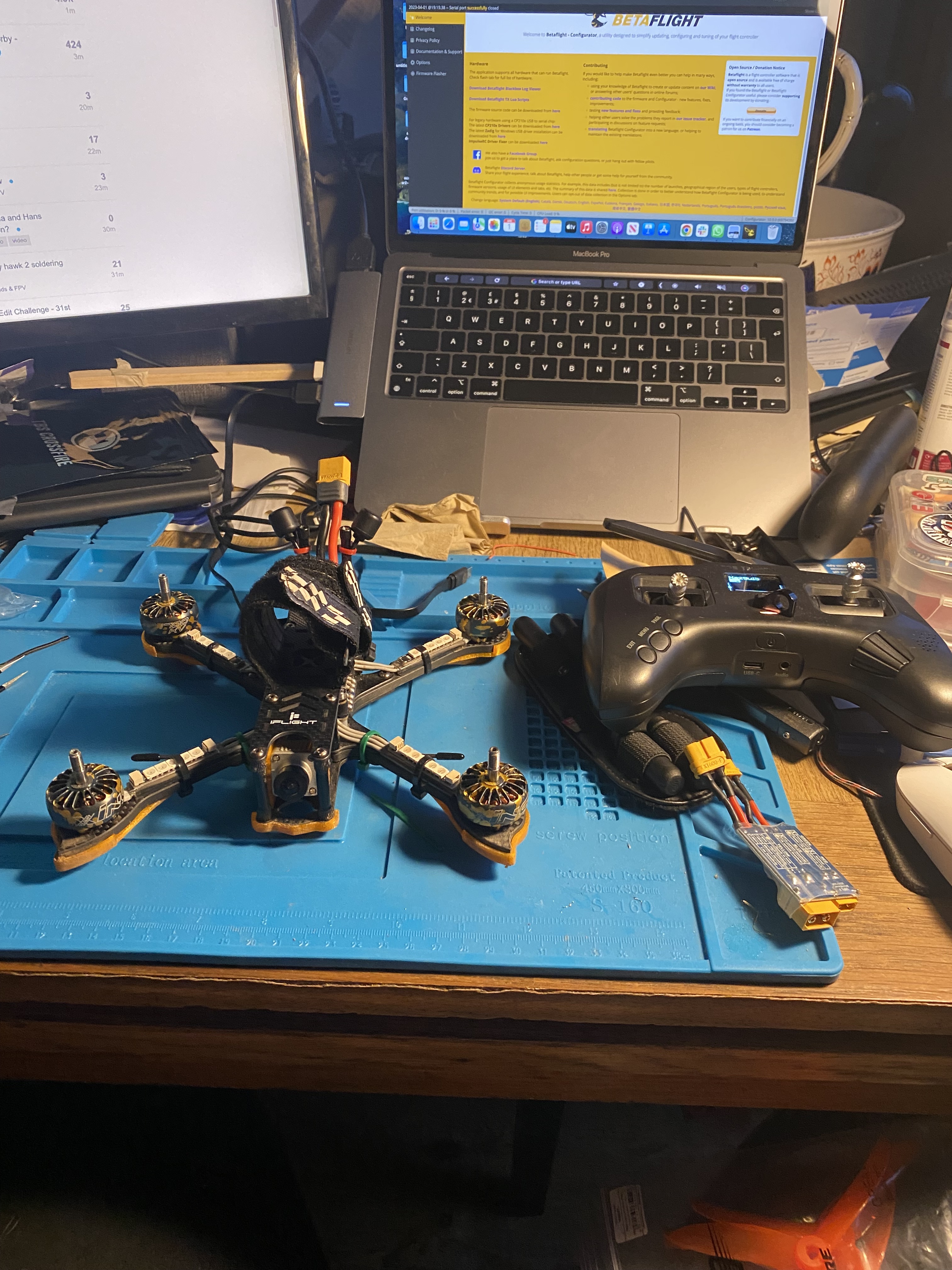

It’s been a while since I’ve done this but all seems to
Work as expected with props off.
Just added crsf as it previously used the air unit for rx.

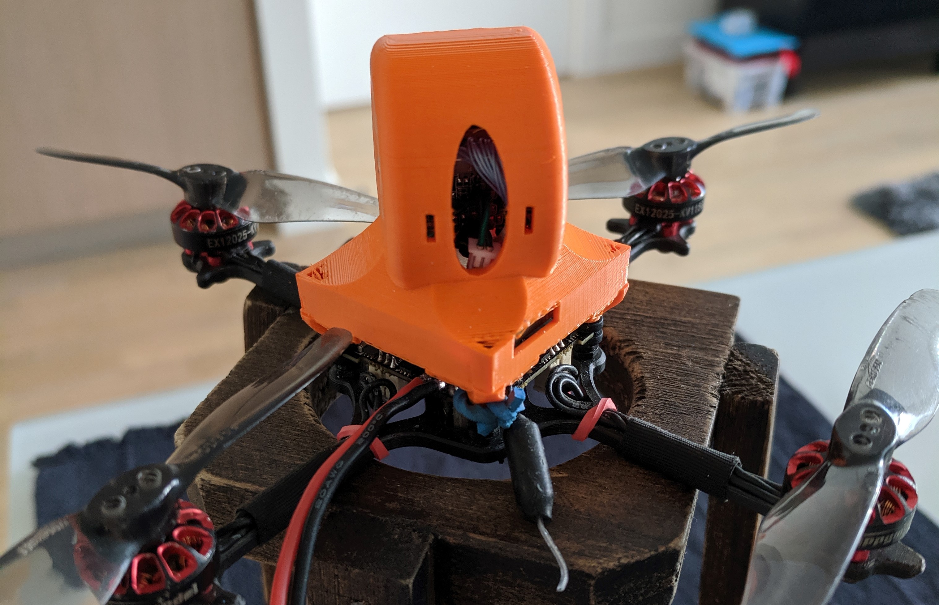

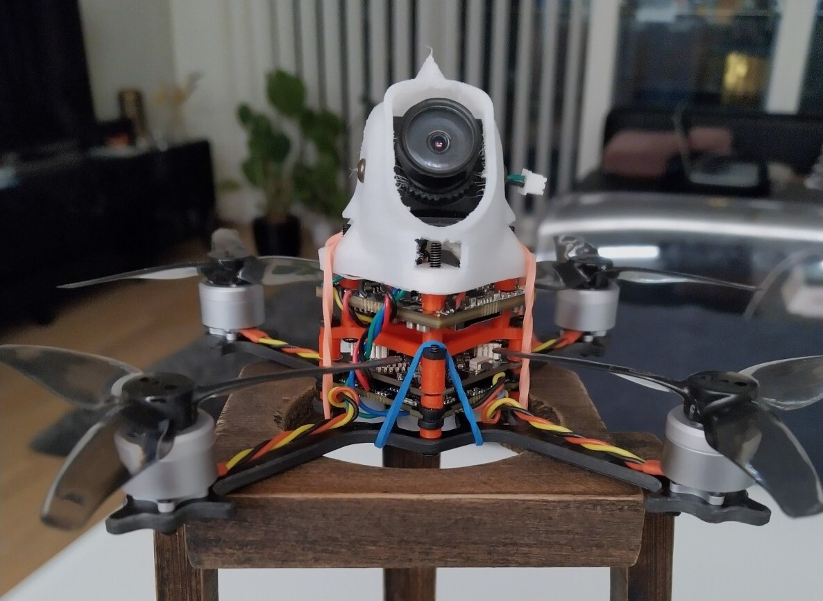

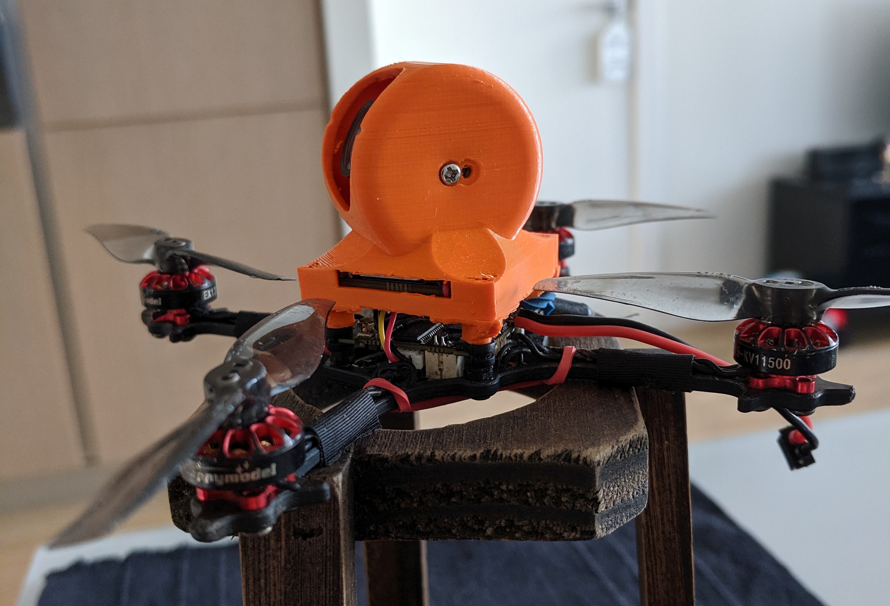

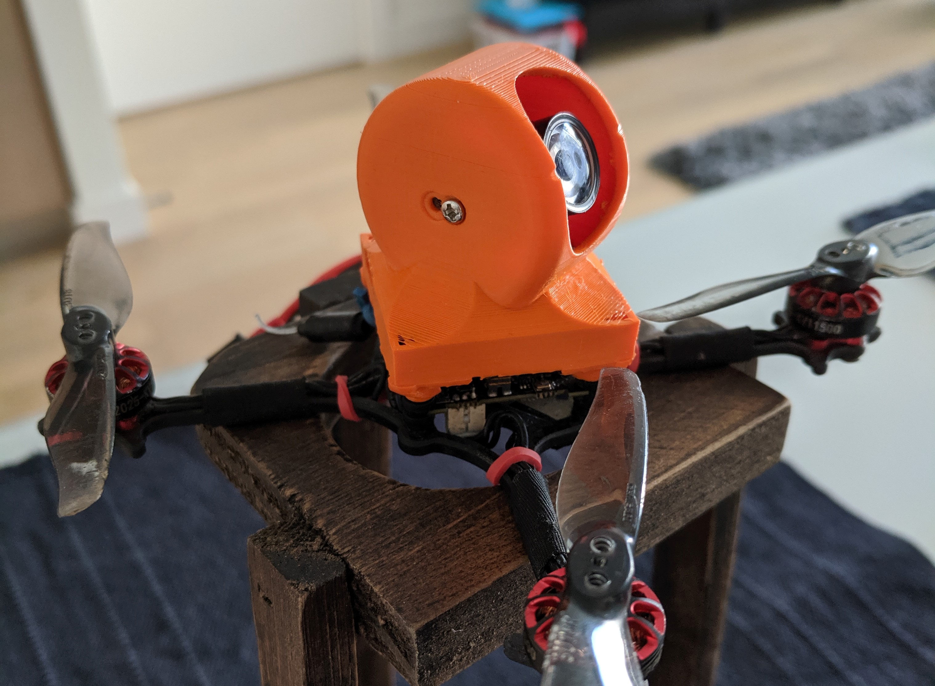

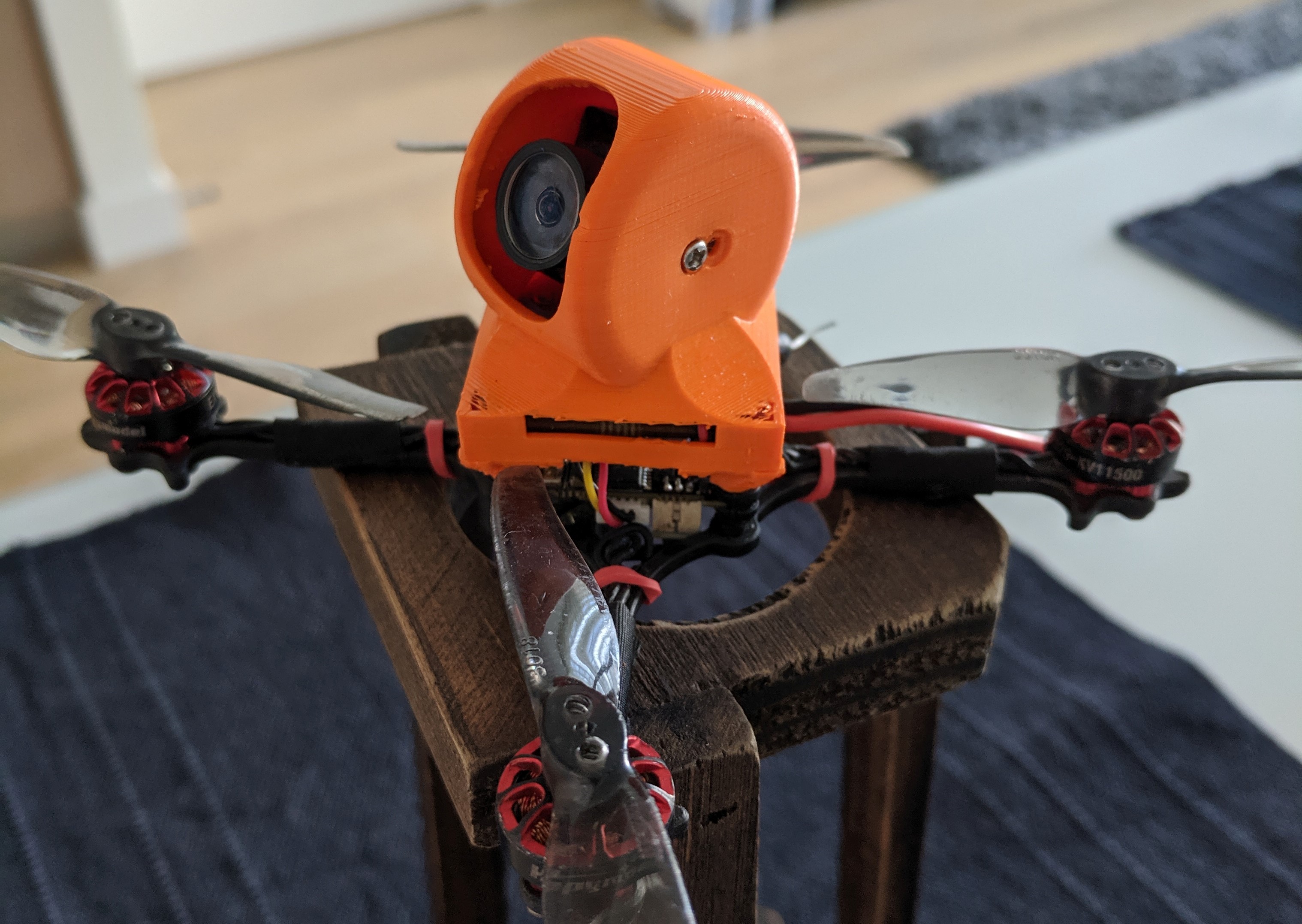

New outfit for the crux yet again… Since I put the turtle on it , the setup was too tall and I felt like the turtle board was a bit to exposed. Had a go on Tinkercad to put something together and came up with a design, which should protect it a bit better. Having installed it now, there are a few things I think could change to make it a bit lighter mainly, but will stay with this for now. The weight is exactly the same as with the high stack version. Will test how it feels on air tomorrow.
Shout out to @Steviegeek for the quality print :ok_hand:
This is how it was:
And this is how it is now:

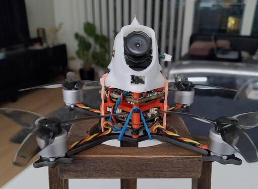

Finally finished the rebuild. Moved the UMT CineFlea on to a Twiglet 2.5" Frame. I am still not entirely happy with it, but it flies. Need to put QS on it and tune it a bit. Also needs the HQ 2.5x2x3 props I have to be put on it. Looking to take it out tomorrow and get some proper test flights.
Nice one dude… was wondering how the build was coming along and here it is…
Hoping to get some 3S Lipos by Friday for a quick rip down at Matlock. If it’s a good day i will bail out to the van and recharge them for a second session. Hoping my 300W Inverter will run my mains charger. The B6 isn’t operational right now due to some wiring issues. if not I will recharge the 2S Lipos and use the 85.
I am kind of tempted to buy another one and do another modified build. Maybe a 3". I don’t have any love for the original design, but @DaveJaVu seems to like his. I found it far too heavy.
Going to try 2.5x2x3 props tomorrow and order some 2.5x3x3 props and some 550 3S Lipos and see how much difference that makes. According to the spec sheet those motors can spin GF 3018 bi blades and 2020 4 blade (the ones in the picture). So 2.5x2x3 should be fine for 2S and probably 3S. i won’t know until I get it in the air tomorrow afternoon and do some tests. I’m thinking put the 2.5s on, set a motor limit of 80% and go fly, then if the max amps used is ok, increase to 85% and repeat. If it flies ok on them and doesn’t create massive amp draws, then they will become my main go to props for this build.
In the future I want to replace the vtx board. it’s one of those types with the outside of the holes cut away. Feels really loose. i’ve kind of over-engineered the bolts and used a number of nylon nuts on each component, before finishing it with the nyloc’s. But it shouldn’t fall apart in a hurry.
Why not check the amp draw on the bench with betaflight?
Test one motor at a time if needed and just hold it down firmly by holding the other arms, its not going to fly off or anything. Set it up so that the prop of the motor being tested has some space beneath it, like at the edge of the bench/table for example. That way you save time by getting the readings and making the necessary configurations instead of trying to figure everything during flight.
TBH a testing rig is on my list of to do’s. I was originally thinking of soldering an esc into the cheapest FC I can find and putting a multimeter inline in between VBat and the ESC. Then using croc clips or a motor connector to hook the motor on to the ESC.
For now I am going to try and get a few flights in on these 2.5x2x3 props and see what it feels like. From my hover test yesterday on a 660 Lipo, I think it will be a pretty good at 100% on 2S and probably far crazier on 3S. I hope the CNHL 3S 550 Lipos turn up tomorrow. Probably looking to fly no more than 10 packs on Friday. This week has been a bit of a train wreck for me. :wink:
So will let you know how it flies and hopefully have some DVR footage, not of me crashing. :smiley:
Was having a look at those CNHL packs as well. One thing I didn’t like is that they are much heavier than the GNB counterpart. They would lower the thrust-weight ratio I want to test out and reduce/restrict changes on the build, so might skip them for now.
Only 2g heavier. On my build i am generating somewhere around 500g of thrust at 100%, with an AUW of around 85g, on 2S. On 3S, I might have to add more of a limit, but since amps scale down generally in relation to voltage, maybe not too much.
