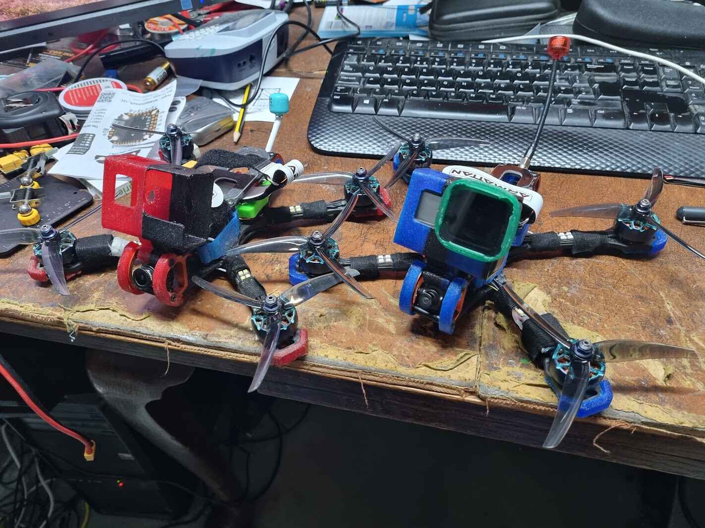

My Beavers are multiplying…

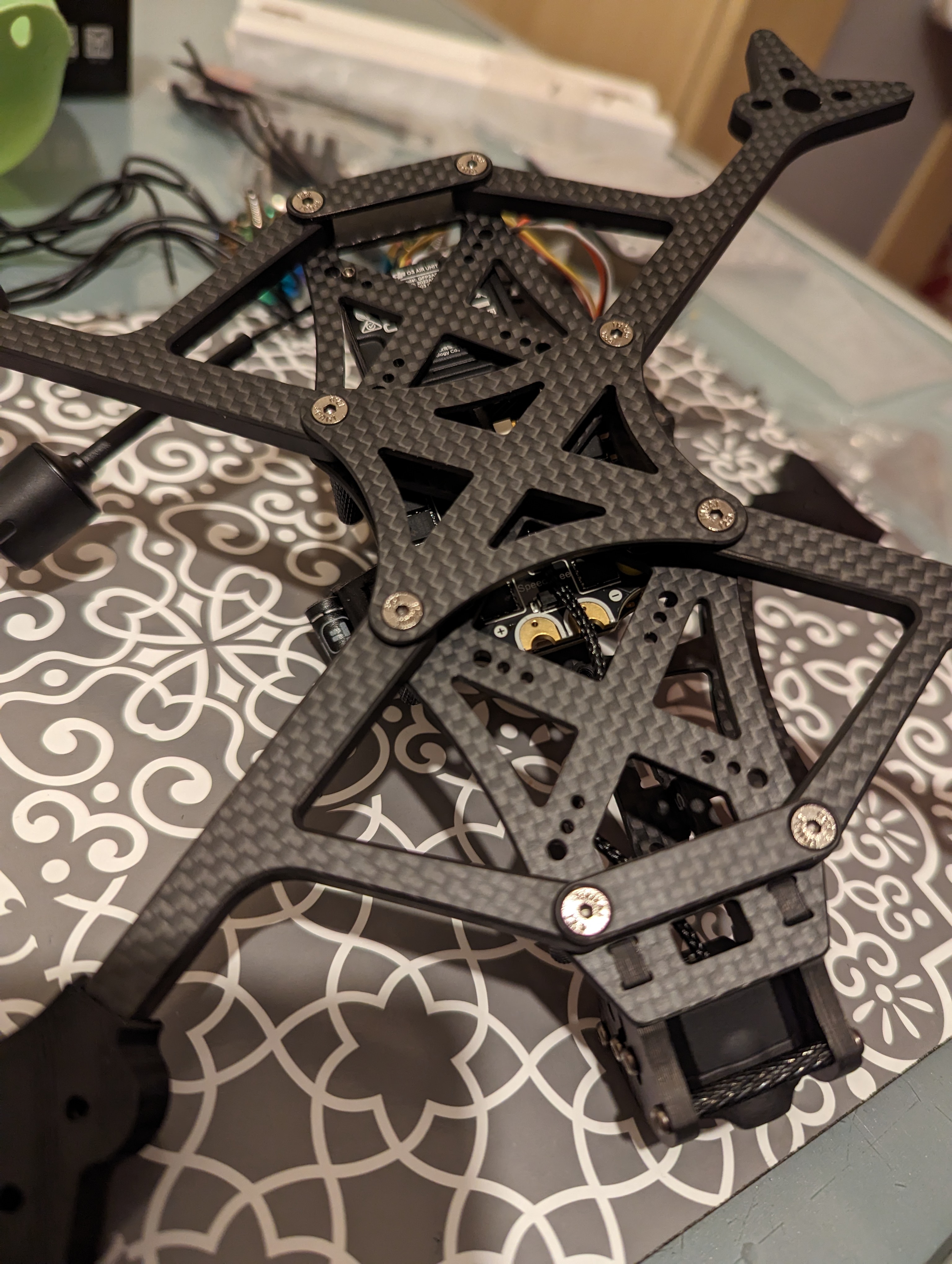

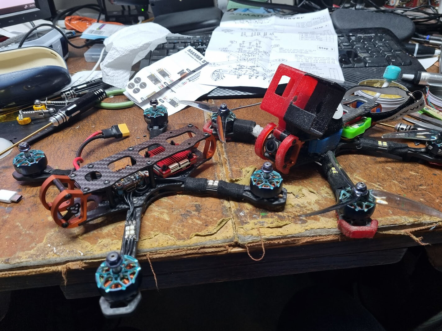

I wanted to upgrade my old QAV210, but the frame would not take a HDZero Freestyle VTX… so I’ve had to move the whole lot over. In the process I found the top plate had broken and the stack screws were bent. So a good move,
FC, ESC and motors work so far… I think I’ll continue another night,

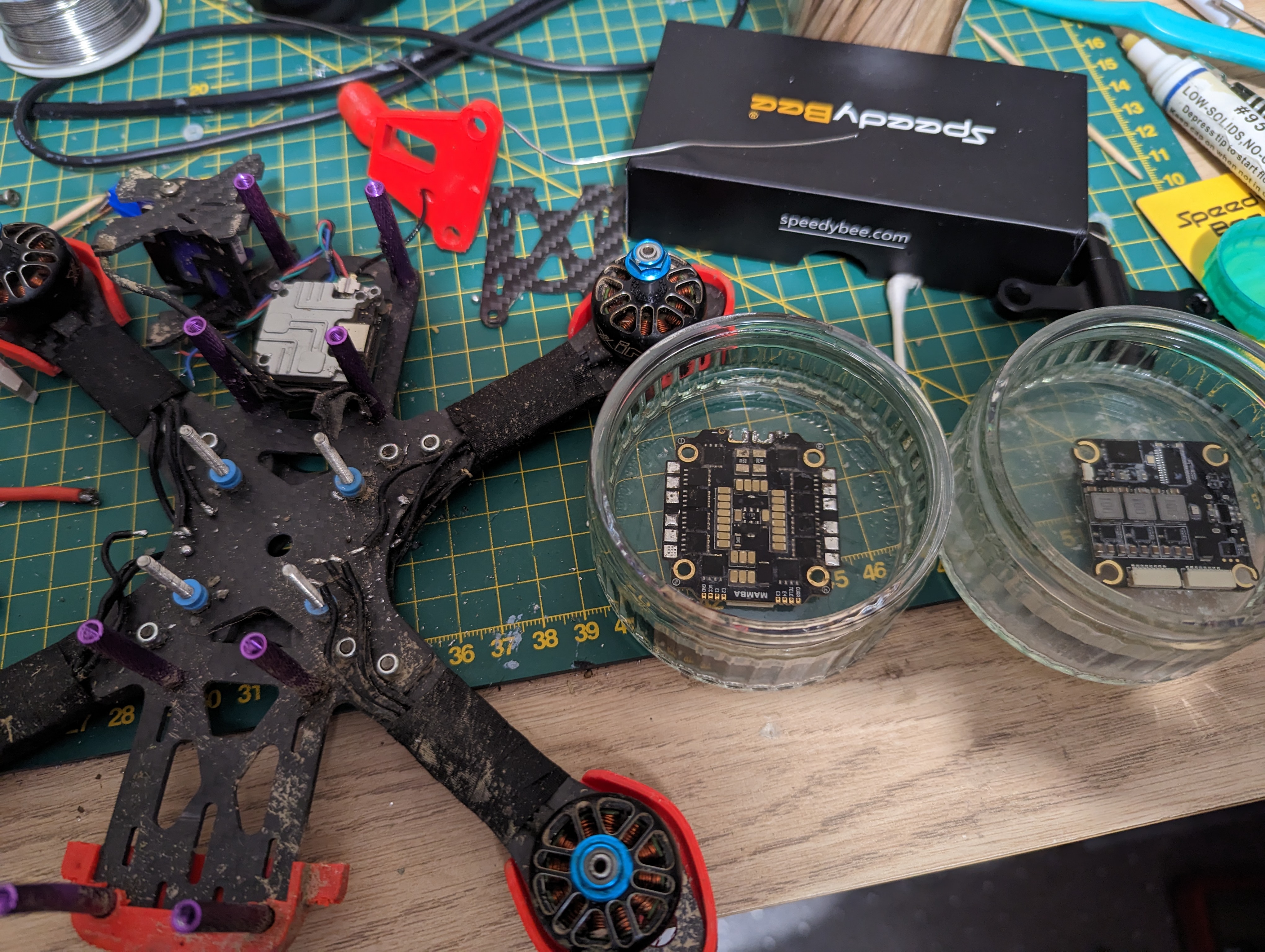

As I’m transplanting the FC and ESC of my old Martian to the new AOS 5 frame, unsoldered, and giving them a bath before going in…
Will be replacing in the old martian with a new Speedy Bee stack.

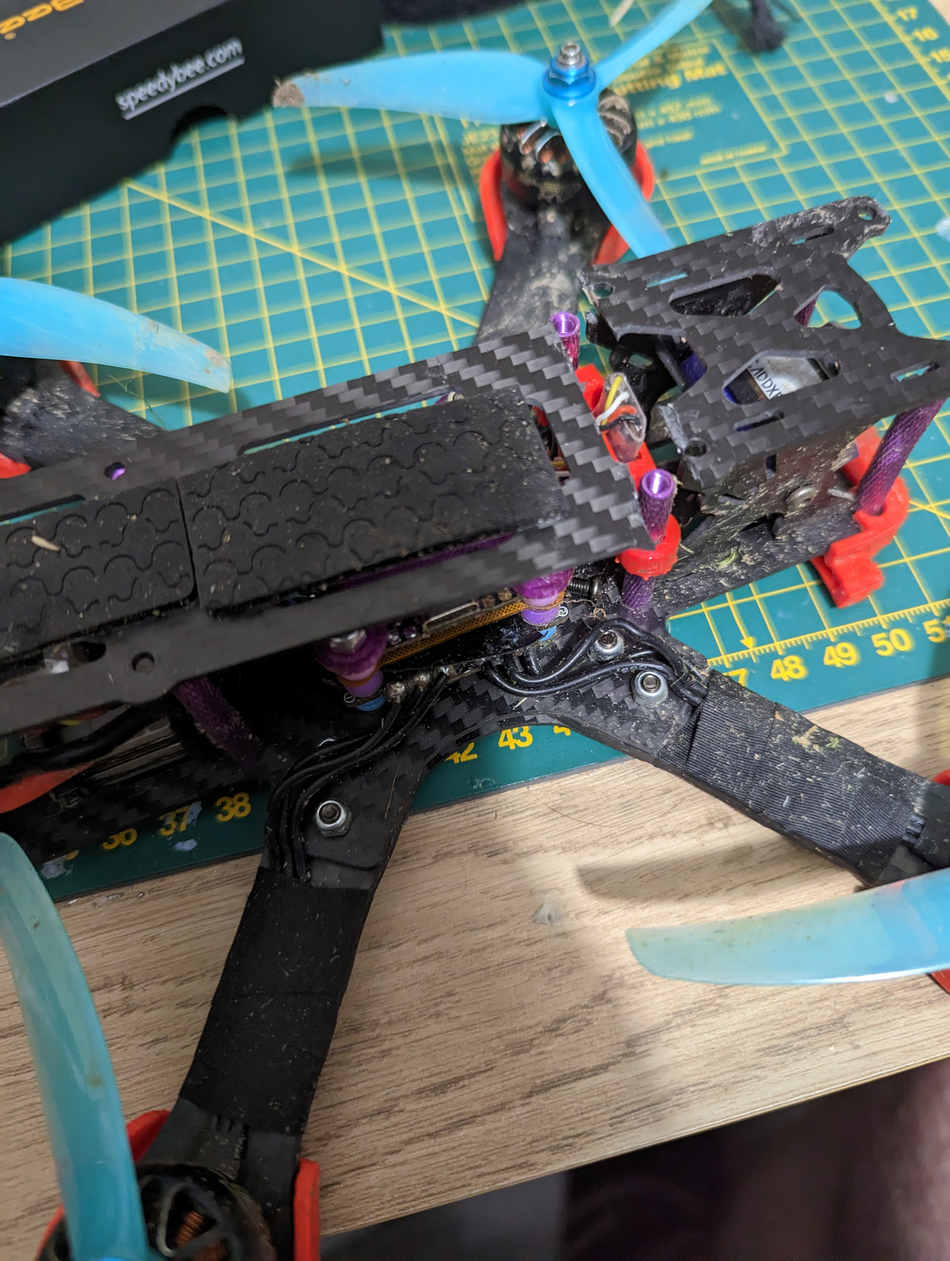

Also when taking off the top… the “new” martian frame… oops, have a spare top plate for that, might even use the old one from the “dead” frame that snapped, lol

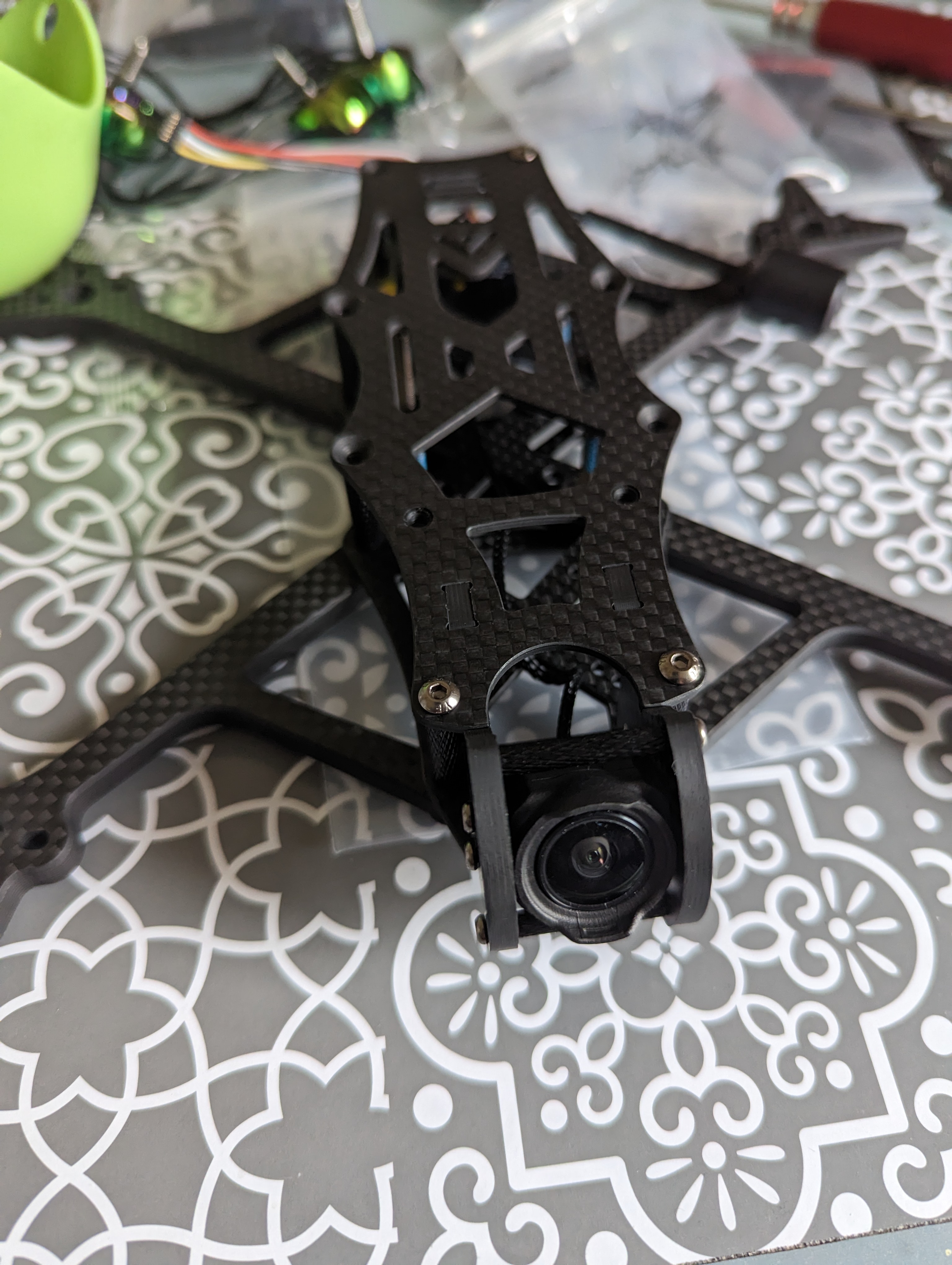

Both me and @clinkadink had noticed the front two screw holes on top plate aren’t counter sunk. Interesting that one, we’re guessing that it’s probably for strength at the front, or maybe (less likely) as go pro and the like mounts will go.
Anyways, the O3 fits in like a beaut :slight_smile:
Never seen counter sunk holes on a drone plate.
There ya go… A thing of beauty… And weakness added…
TBH being my first “decent” frame, the smoothness of the carbon fibre compared the finger cutting martian, is lovely :slight_smile:

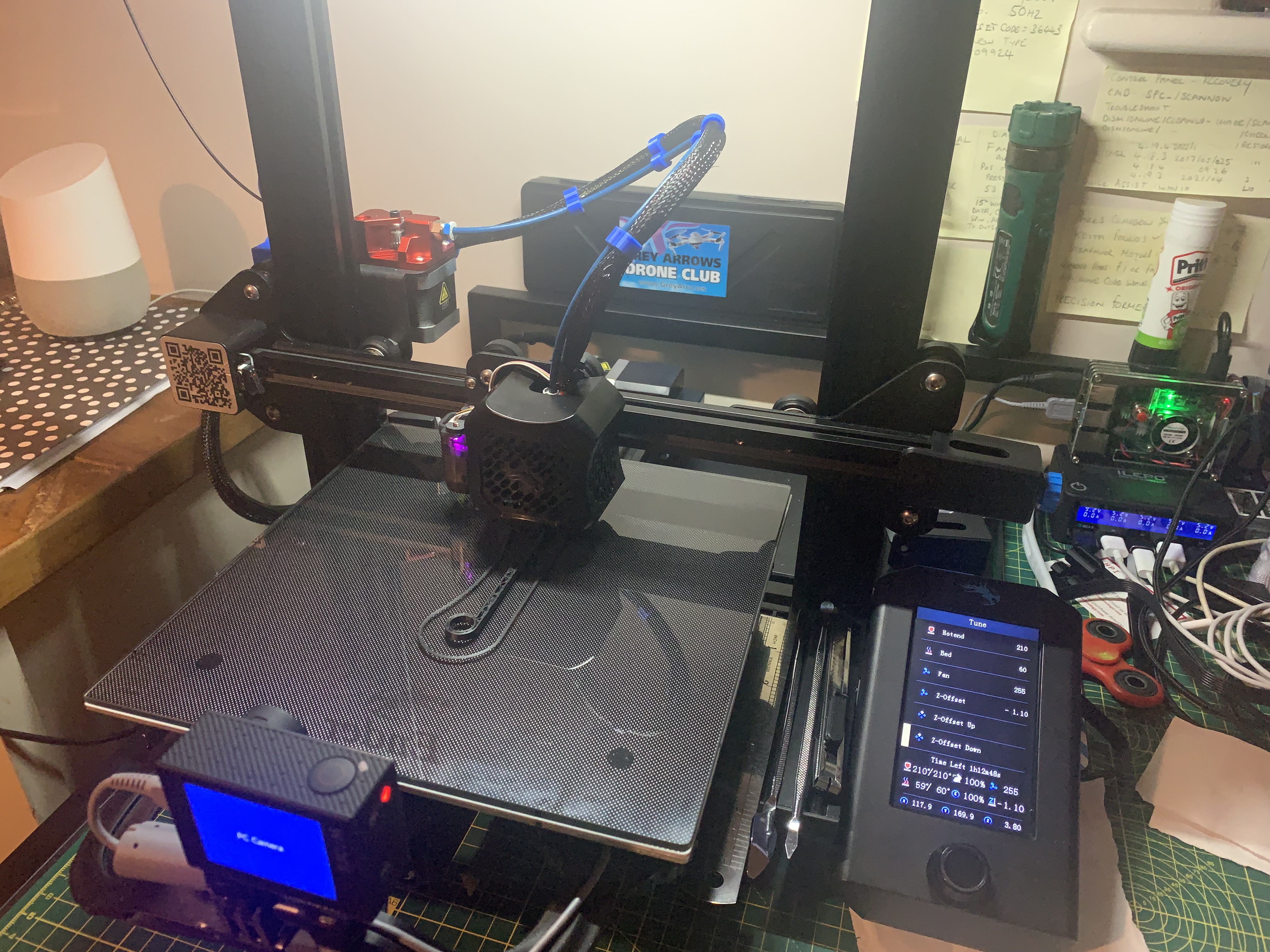

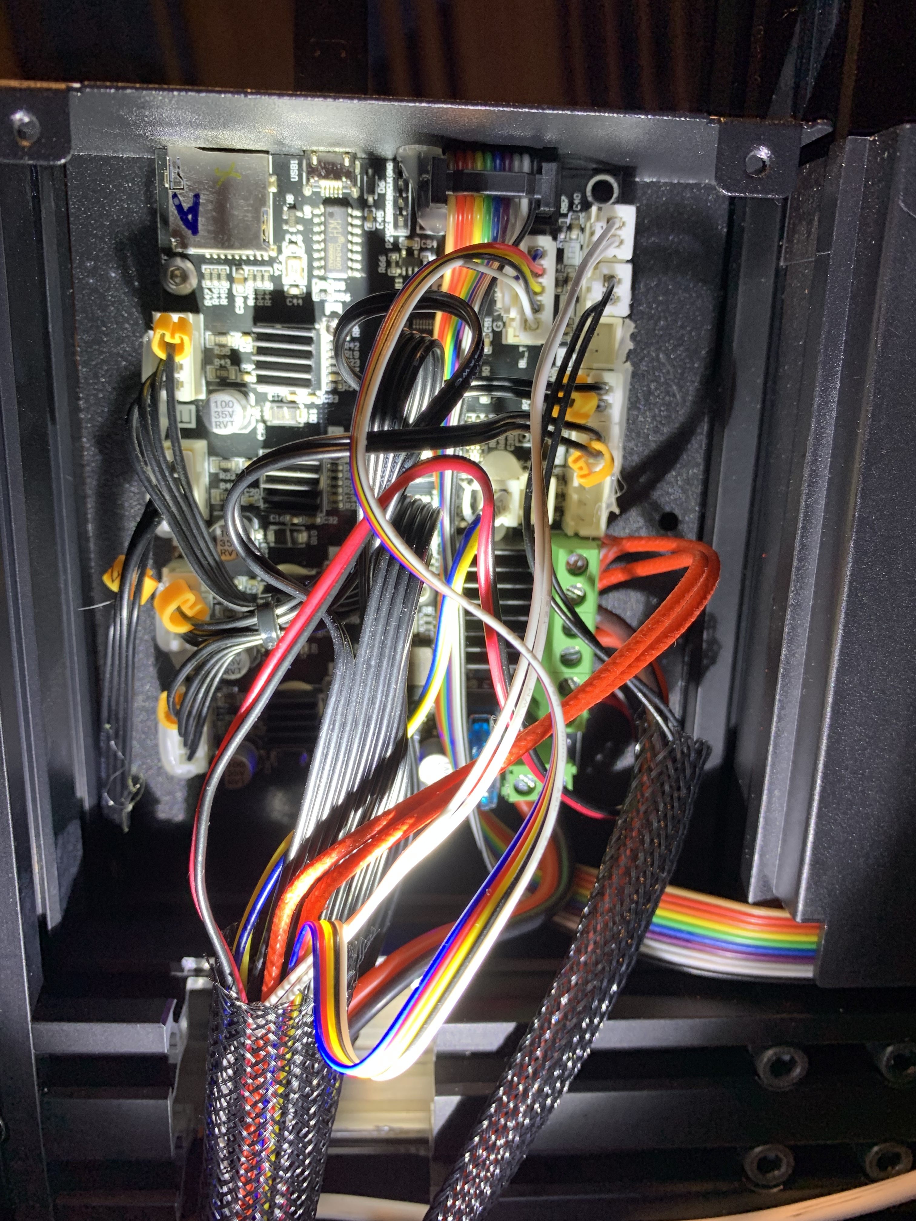

She is resurrected :grinning:
What broke Wayne? :thinking:

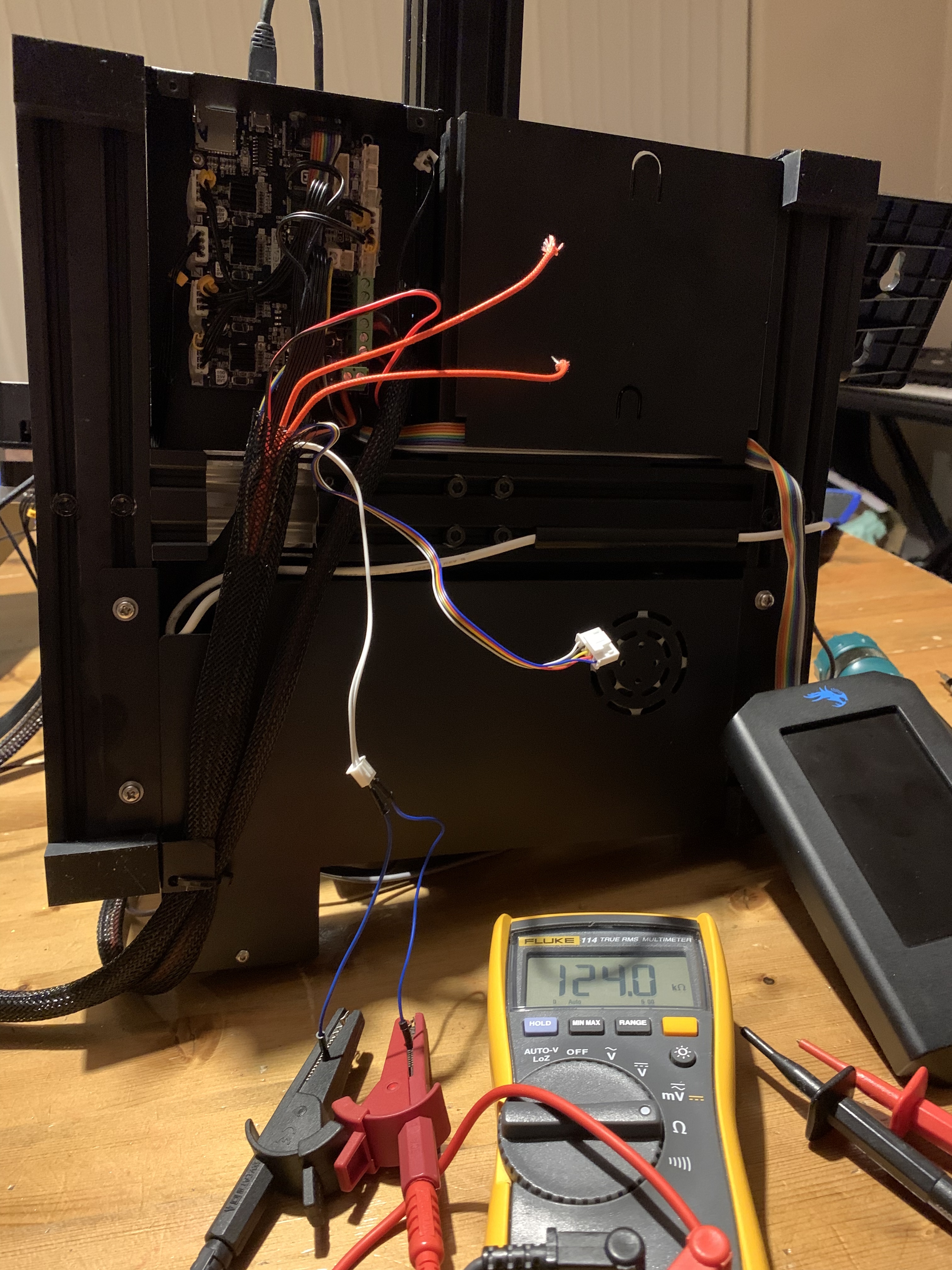

The board, it was giving a constant max temp error and wouldn’t start up, at first I thought it was something simple like the thermistor’s but when tested with a meter they where fine. More diagnosis led me to the board, I even tried recompiling the firmware to use a different pin on the STM32 CPU (which is still work in progress) but that didn’t work
Learnt a lot about 3D printers in a few weeks of owning one :grinning:
The compiling and altering the firmware is interesting, it havs various diagnostics built into it you just have to find it in the code to use it
And its fully open-source :+1:

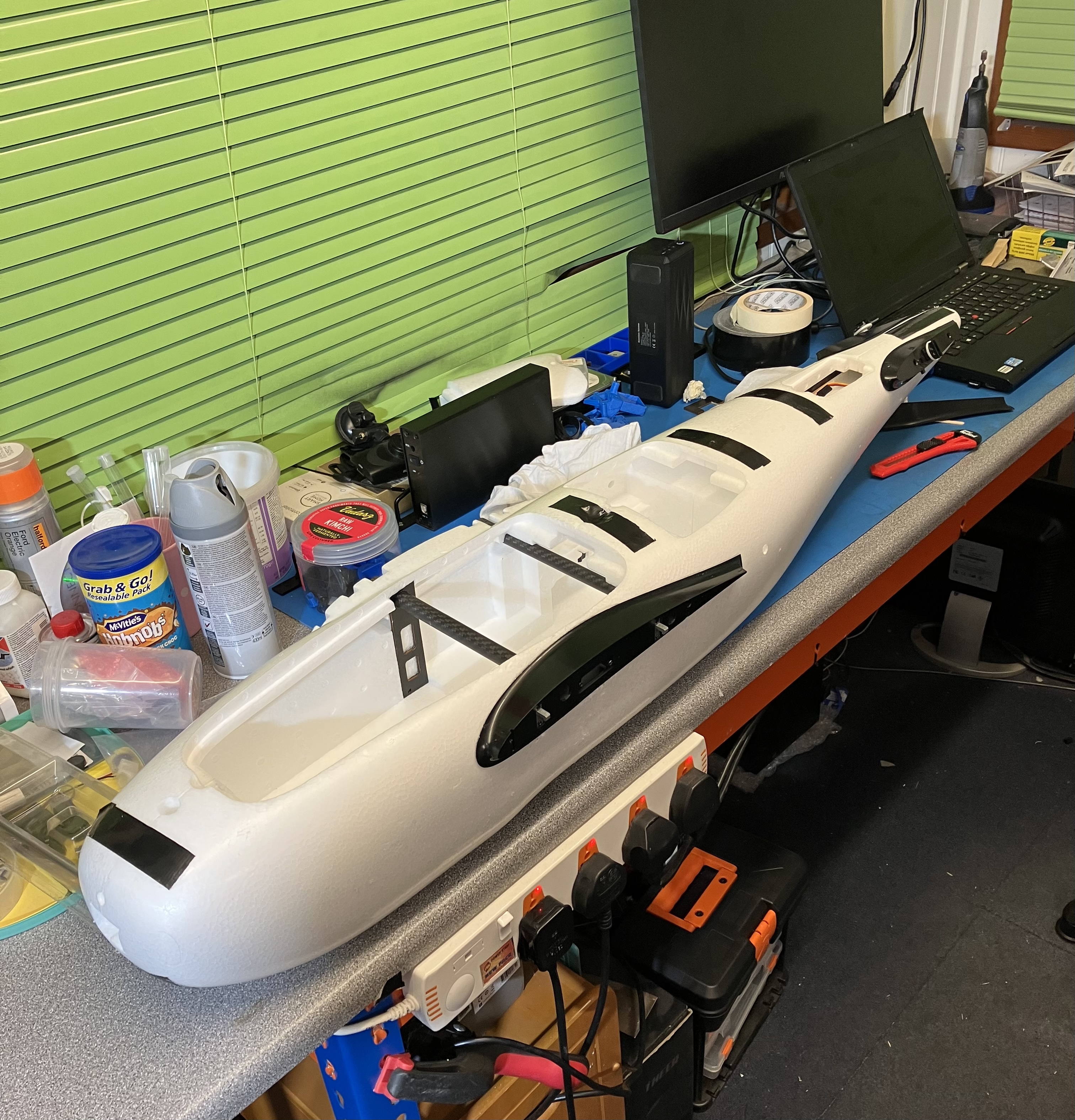

Started building my ‘Believer’ Vee-tail plane.
Slow and steady on this one, no rush, but targeting to have it flying well for the Big Meet 2023 :crossed_fingers:

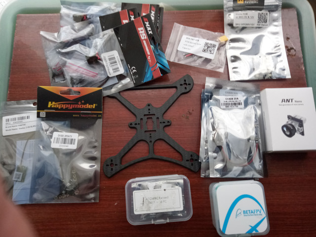

Now have most of the parts for the 2-3S RS1108 build.
  • 3" BetaFPV Twig XL Frame
  • AtomRC Exceed F411 FC
  • 4x 20A Chaos ESC
  • 4x Emax RS1108 6000kv Motors
  • HQ 2.5x2x3V2S (Biggest Props I have, so will use these until I get some bigger props)
  • Matek Micro PDB 80A
  • FrSky Vantac ELRS RX
  • HM OVX303 VTX
  • Caddx Ant Nano
  • XT30 Battery Wire with 100uf Cap
  • BetaFPV Dipole Antenna for the Vantac
  • BetaFPV Canopy (which might be too small for this build)
Will be looking at starting it this weekend.
