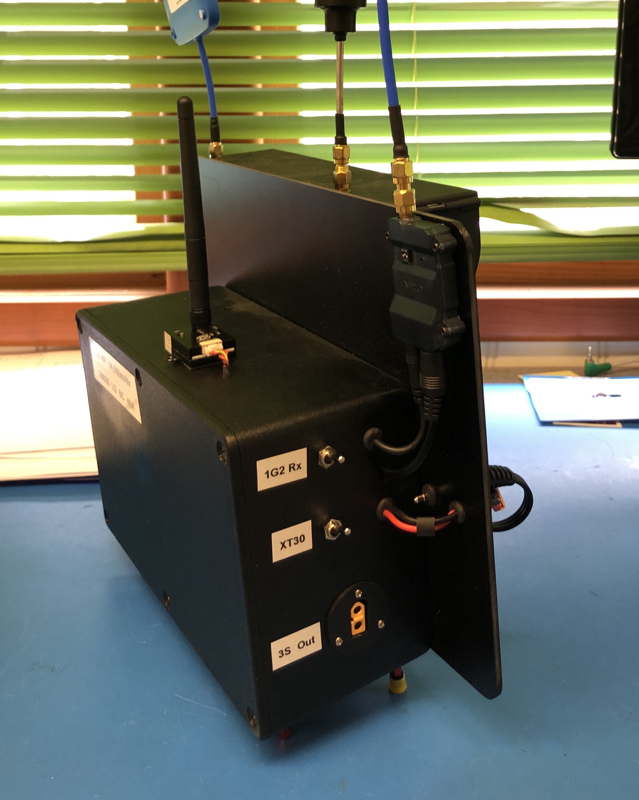

On my bench today? …

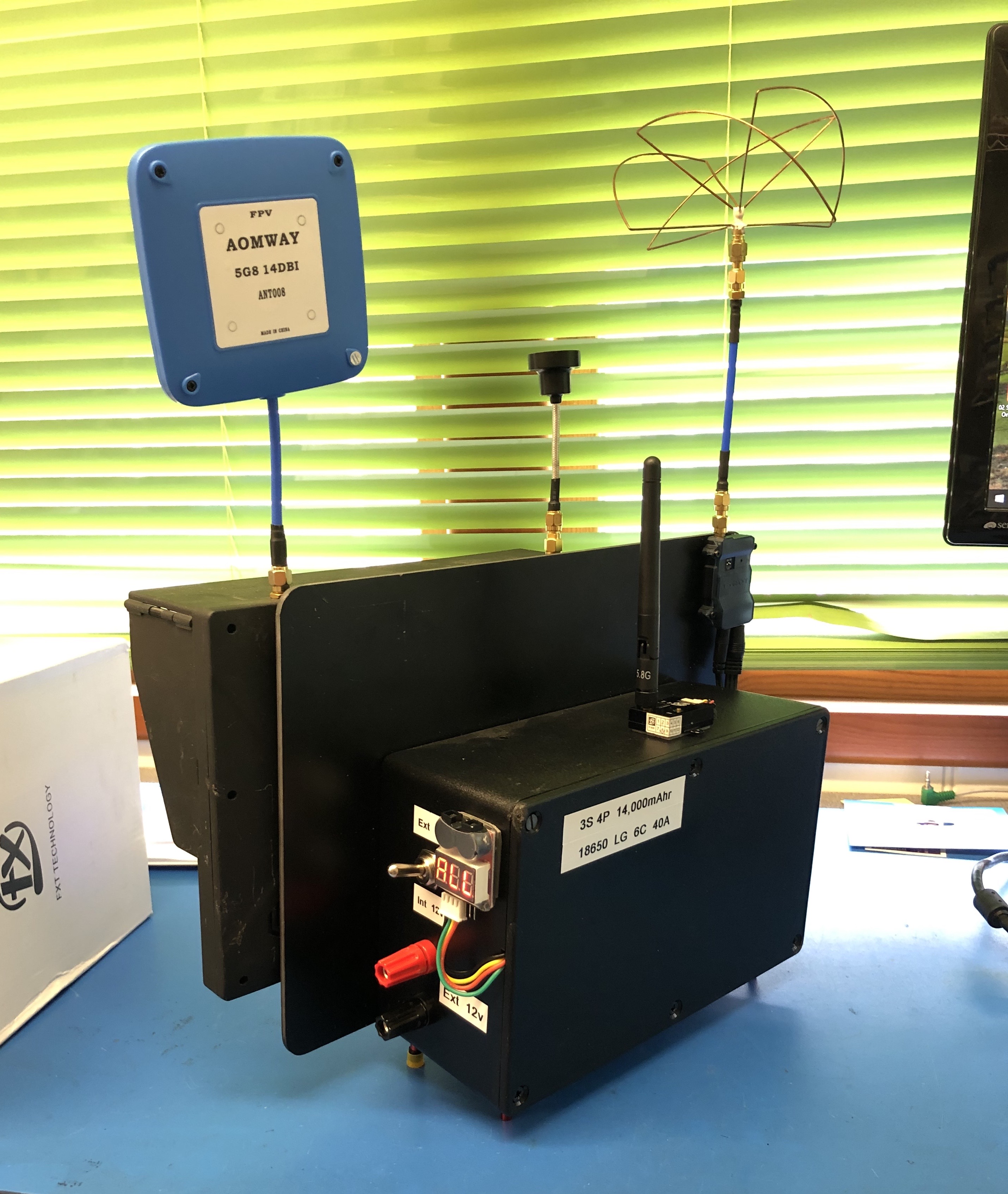

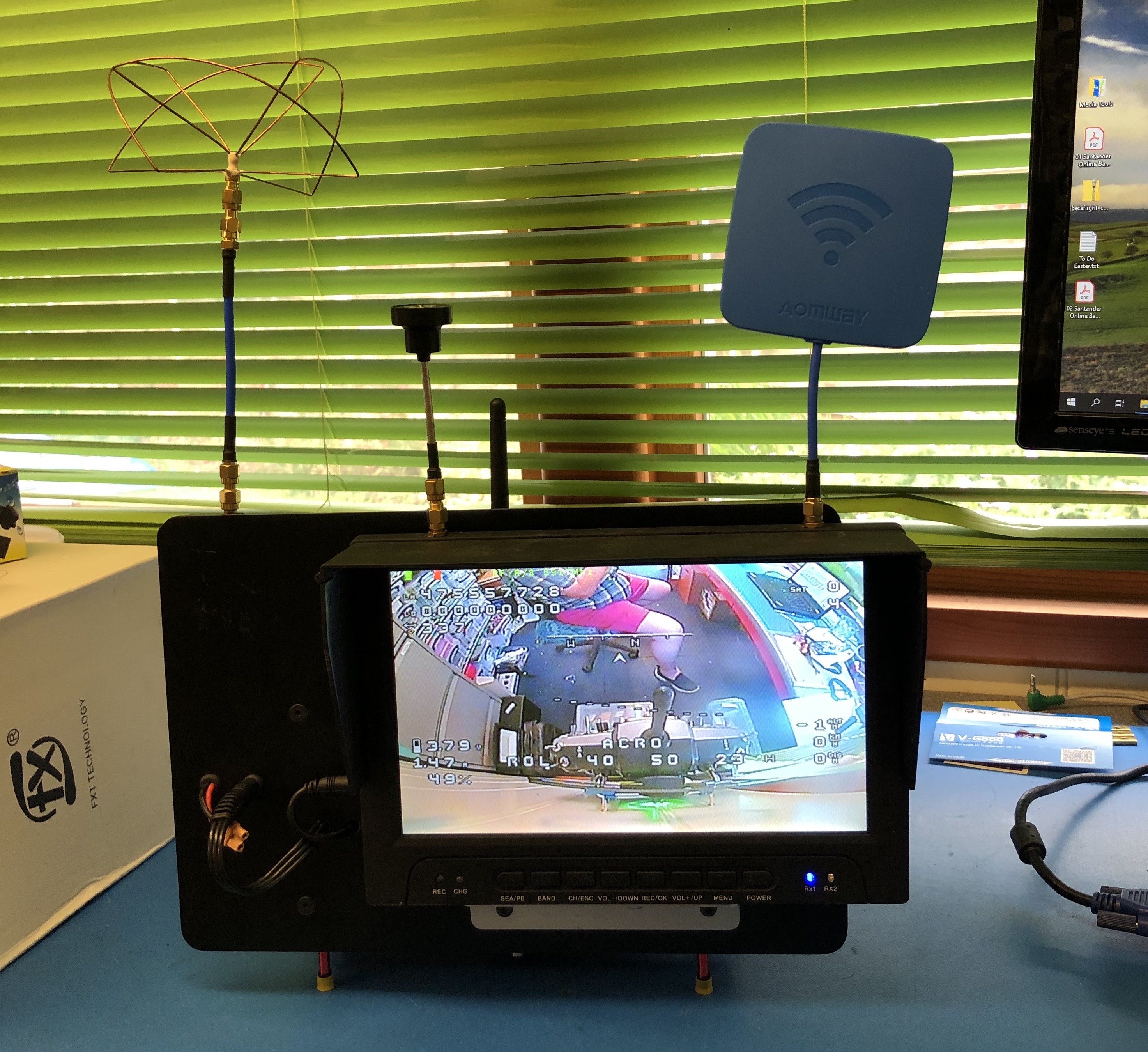

I’ve finished my Ground Station, (not to say I won’t change it sometime in the future)
It gives me:
  • a bloody good 9" monitor display with diversity 5G8 receivers built-in, a DVR and own battery recharged as required.
  • a Li-Ion 18650 battery pack, 3S4P at 14000mAhr, primarily for charging monitor and powering receivers but beefy enough for some LiPo charging as well
  • the GS can be powered from 12v external battery also, switchable
  • XT30 power outlet
  • XT60 power outlet
  • Tarot 1G2 Receiver, video and audio into monitor (and DVR), also to a 5G8 25mW transmitter to relay signal to FPV goggles.
  • cheap cell monitor to warn if pack going low.
and of course a tripod shoe so I can have it at eye-level.
Cheers Steve :slight_smile:
Like the repeater idea. Very well made! :clap: :clap:

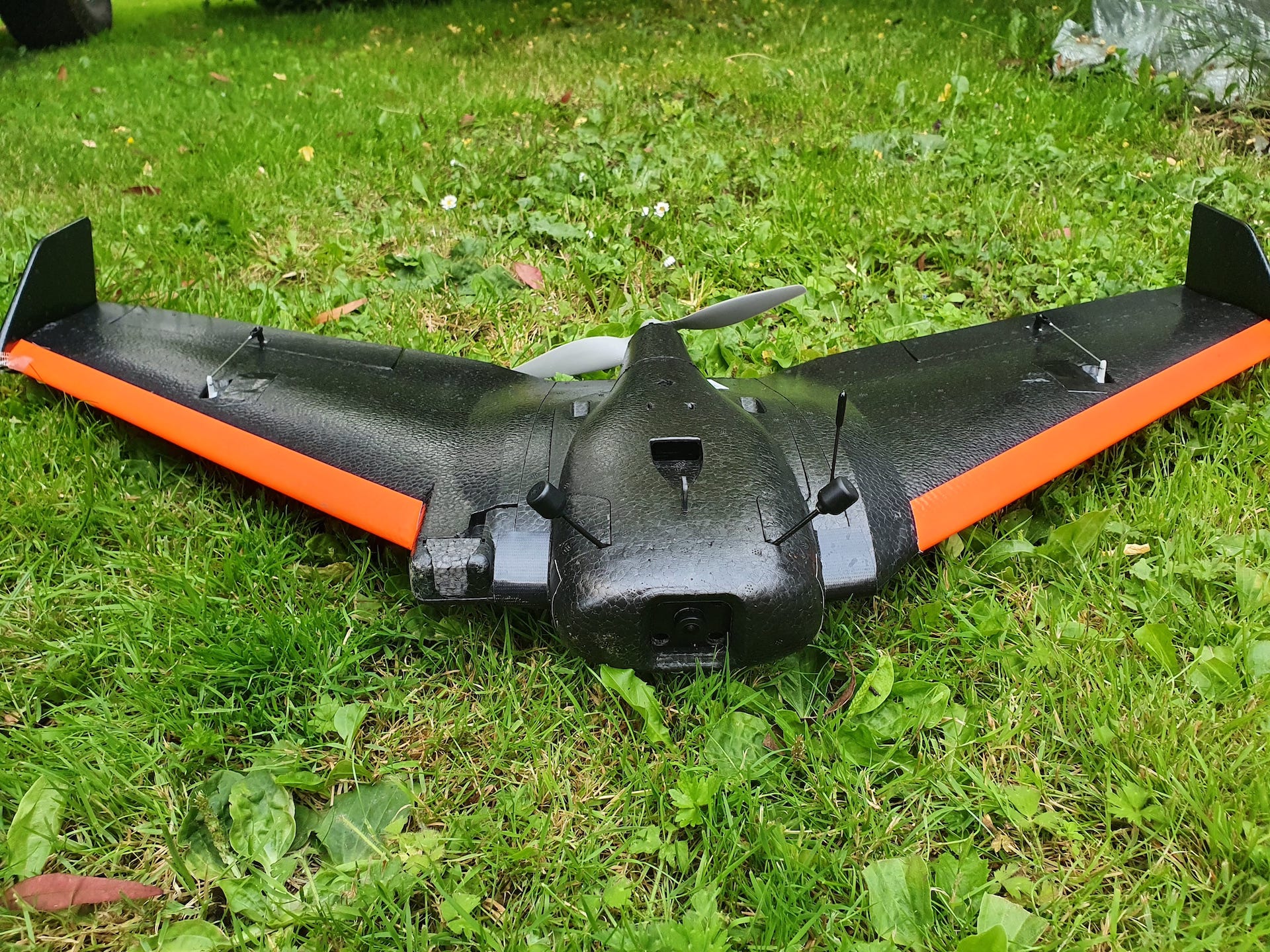

Just finished installing DJI fpv kit in my AR900
Keep us posted, sounds interesting :+1::grinning:
Hi,
How do you like the AR Wing?
I am considering getting one to replace my rather damaged F1 Wing
Cheers
Steve :slightly_smiling_face:
Got it to replace a well battered S800 flies fine what i do like is that there is a lot more room in the bay than the S800 so have more choice of batteries.

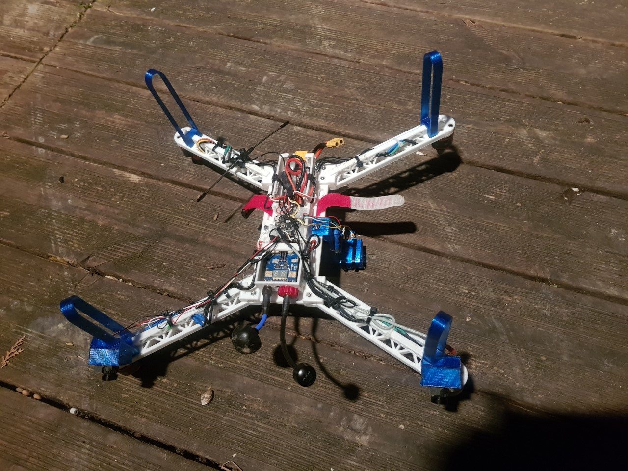

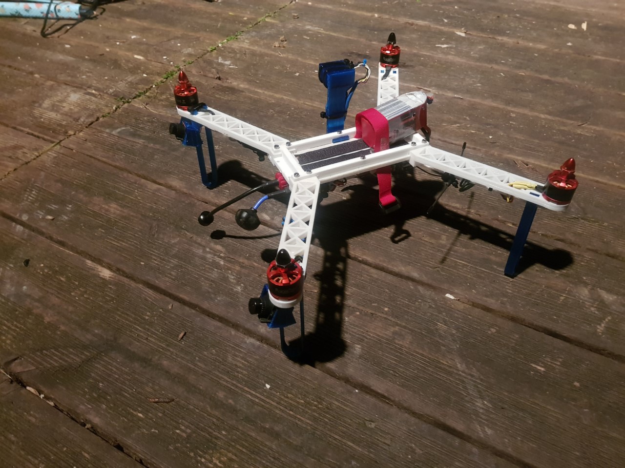

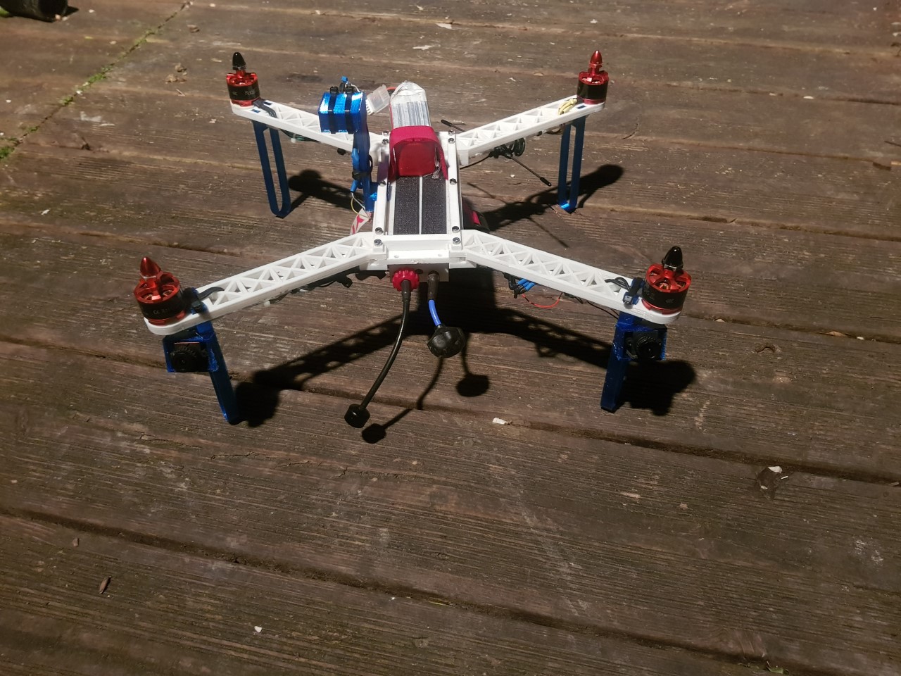

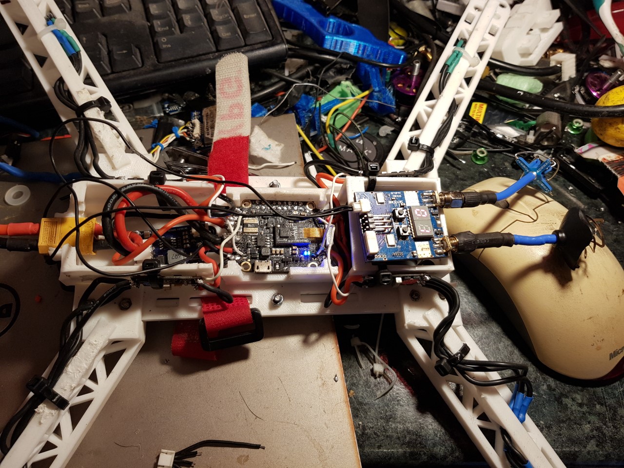

Well it’s a bit of a bodge with lots of cable ties and mishmashed wires, but I just built my stereoscopic fpv quad (10").
I haven’t flown it yet, but the image of my back garden through the goggles is much more realistic. There’s definitely some depth perception. It’s hard to describe. It does feel like you can really tell some objects are further away than others.
When building your own kit there’s no such word as “Bodge”. That word can be replaced with “Tactical”, “Experimental”, “Developmental”. Alternatively when someone else describes it as a bodge you can use many words, such as “ It’s my bloody build and I’ll do it how I want. Now piss off”.
I will be interested in how you get on flying under the goggles and whether you start to encounter some excessive eye strain with the cameras mounted so far apart. I know from experience with binoculars that are not collimated properly, especially large observation Bono’s, that eye strain becomes a big issue. The brain can still process the two images into one but the muscles controlling eye movement become fatigued quite quickly.
Nidge.
True words Nidge.
I did read somewhere that depth perception in humans degrades quite rapidly over 19 metres. Hopefully the increased separation will extend that. It’s just an experiment. Also, I have no way of changing the convergence of the cameras mid flight. I’m not sure it’s an easy thing to do. So the cameras are parallel. I’ll let @Steviegeek have a go too if his skyzones have turned up. It’s got inav and poshold.
