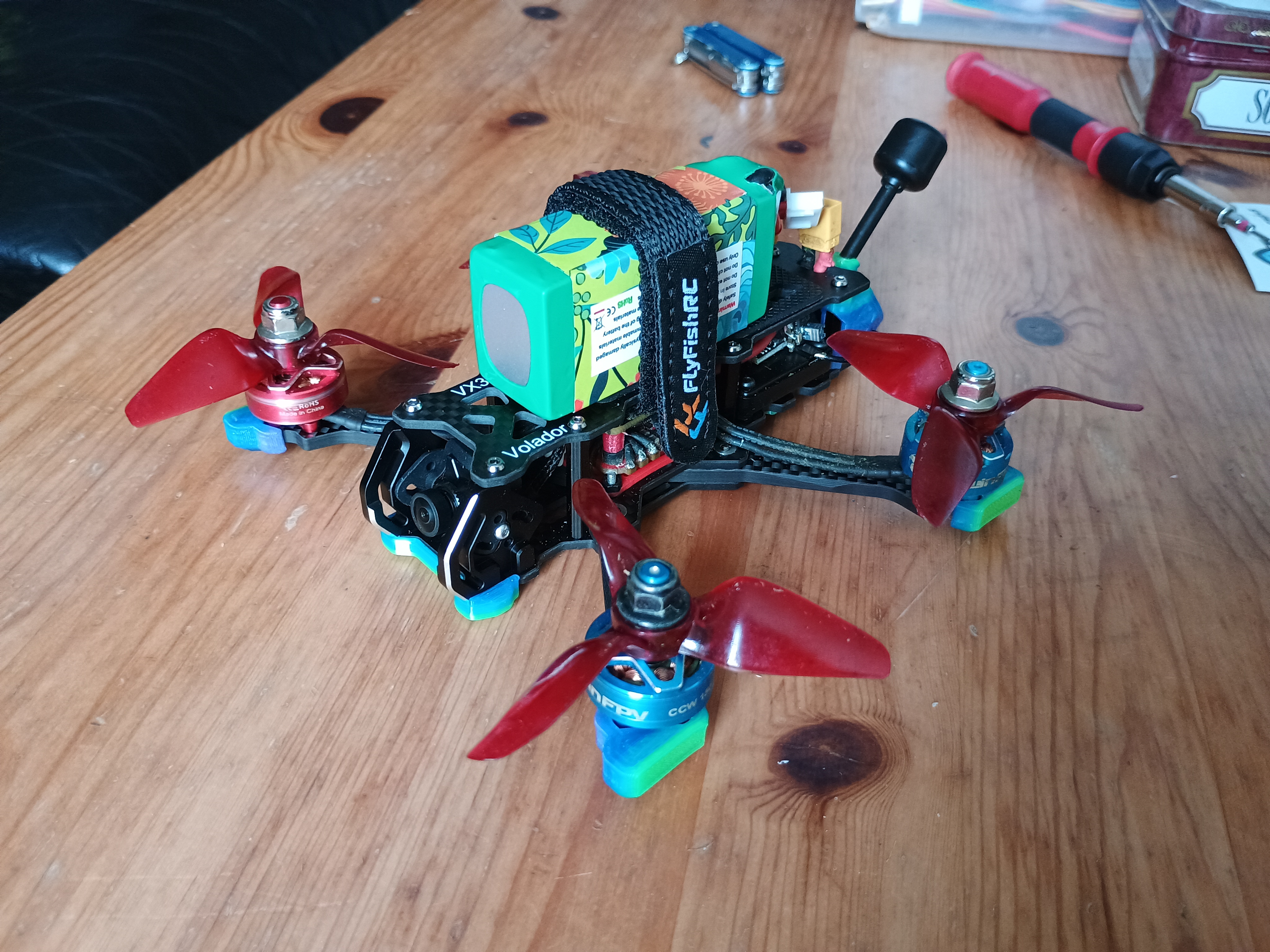

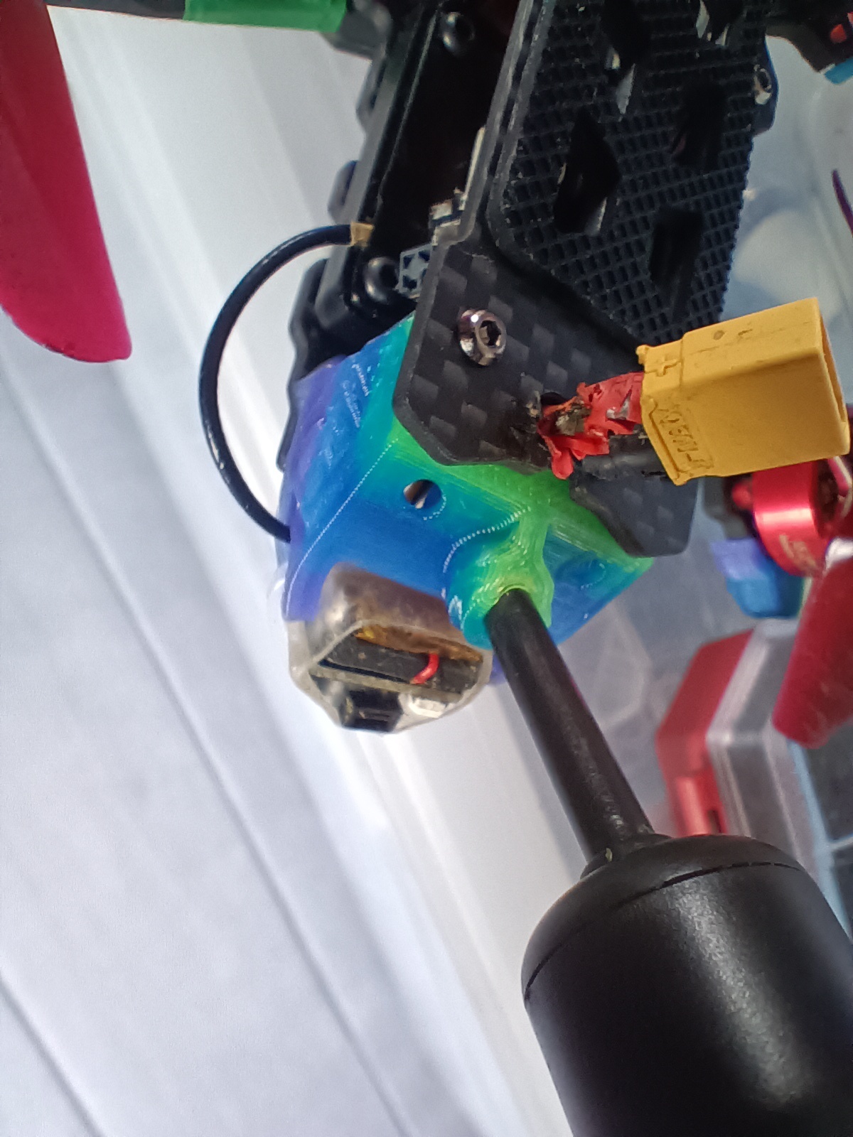

The Volador. Still not a straight swap; had to make an adaptor for the flight stack and drill out the VTX mounting holes to take M3s. But it’s streets ahead of the poor old Darwin 79.
However, 10 seconds into its first flight it suddenly flipped upsidedown. Fortunately I was only a couple of feet above grass but the frame has cut into the power lead and the was a little bit of sparks and smoke going on right there. :frowning:
I won’t really have time to look at it until after my holiday now. Hope nothing’s fried.

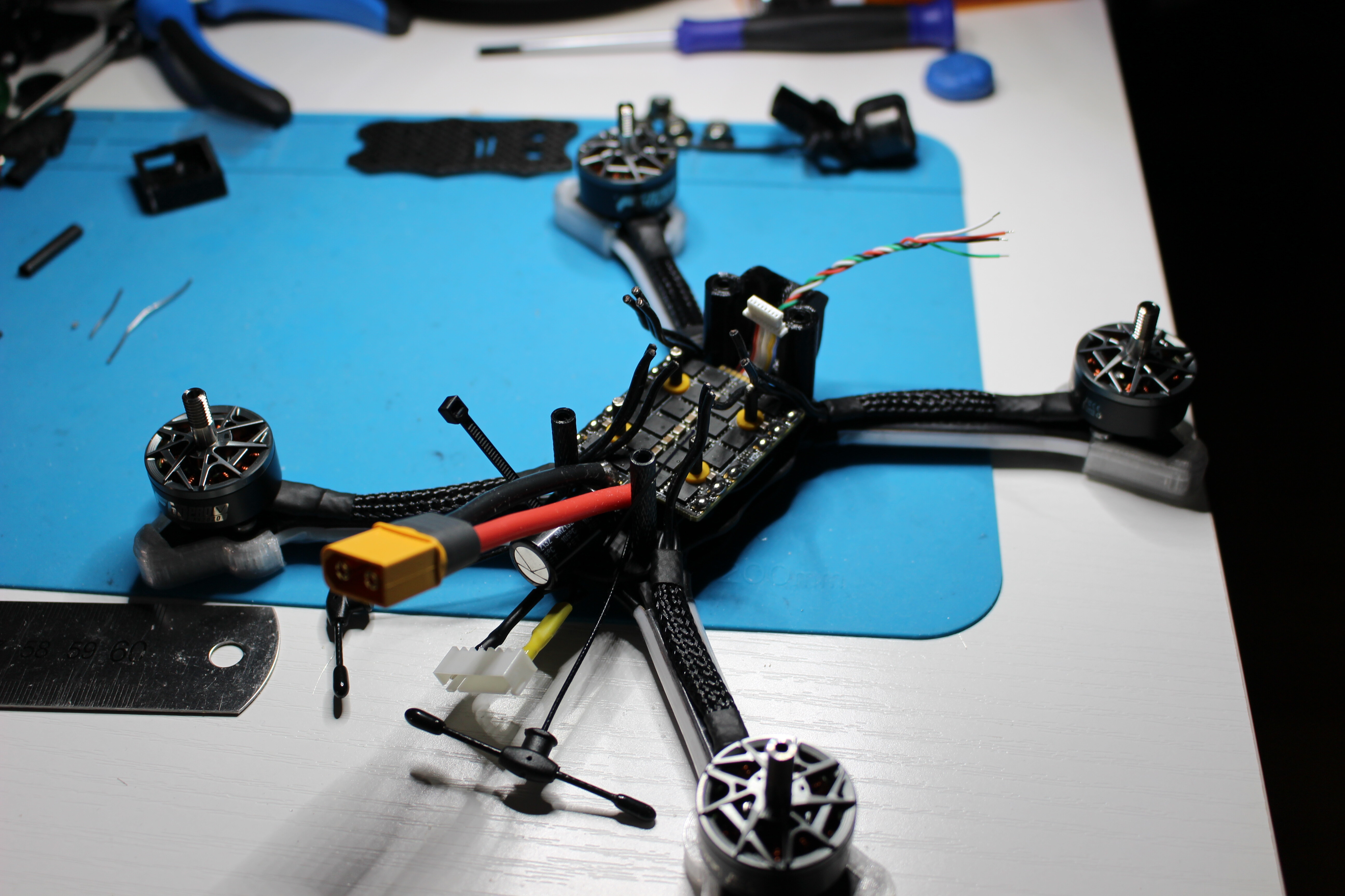

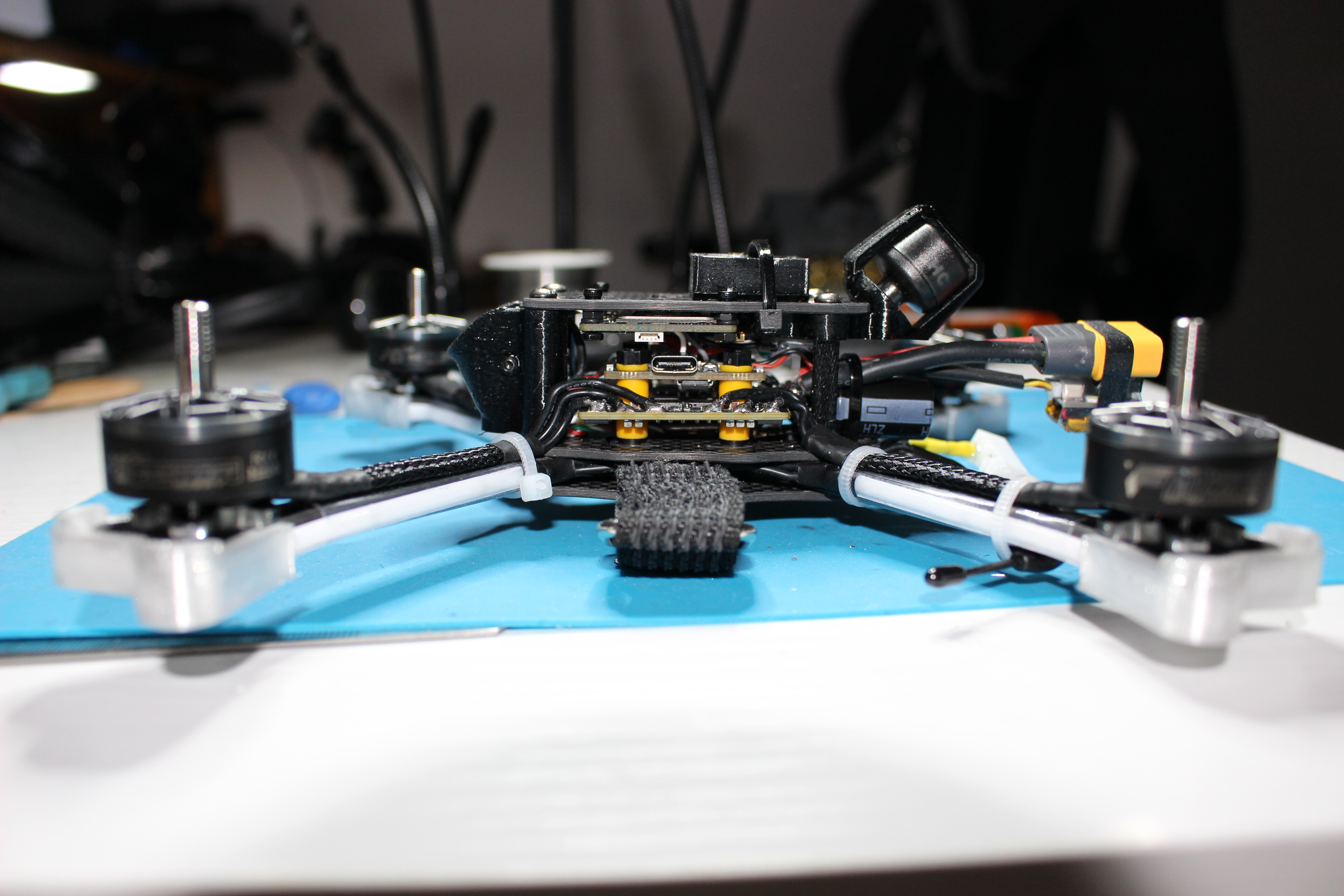

Last parts received today - should hopefully get its maiden flight at the WE (AOS 5R)

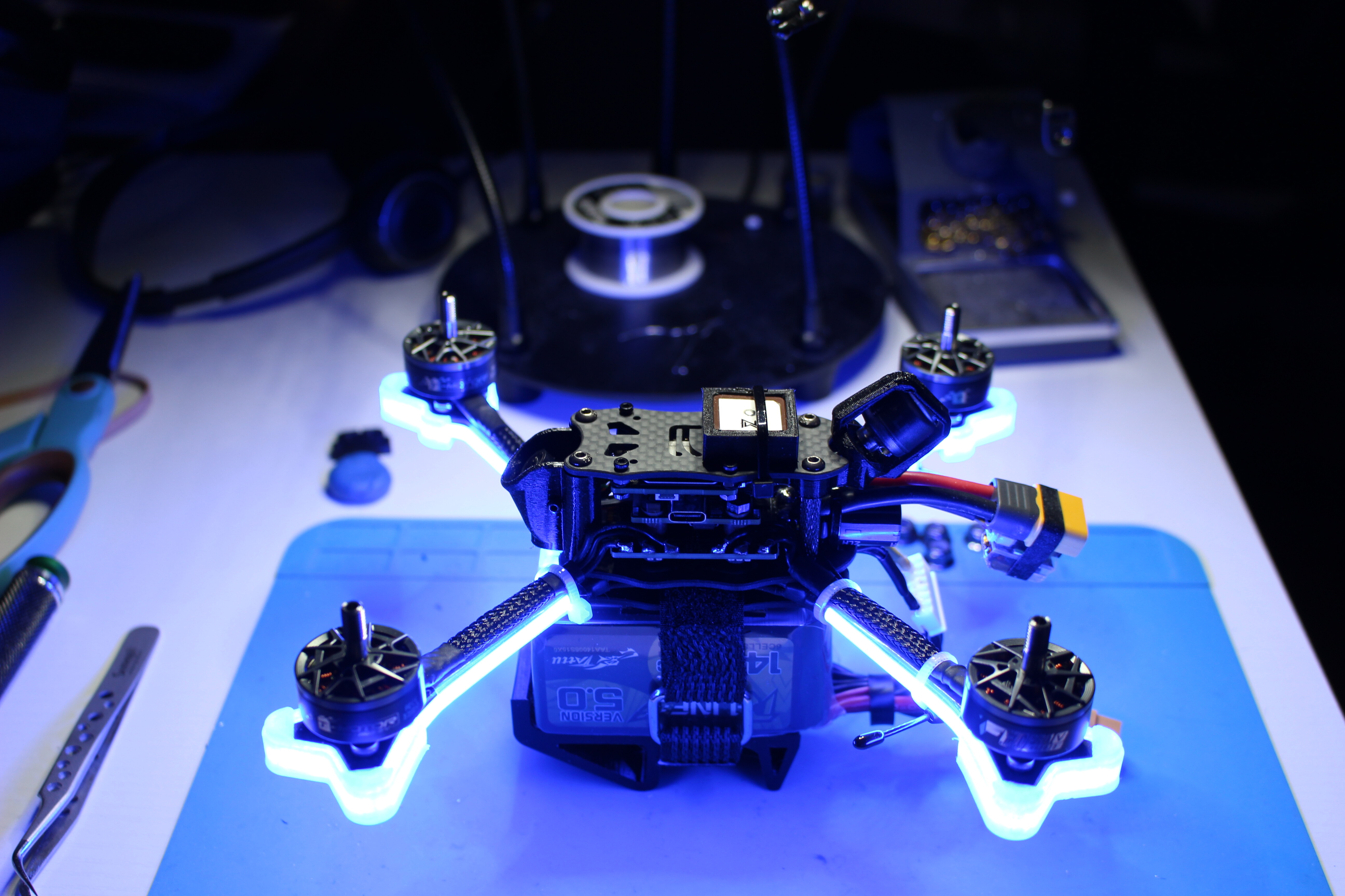

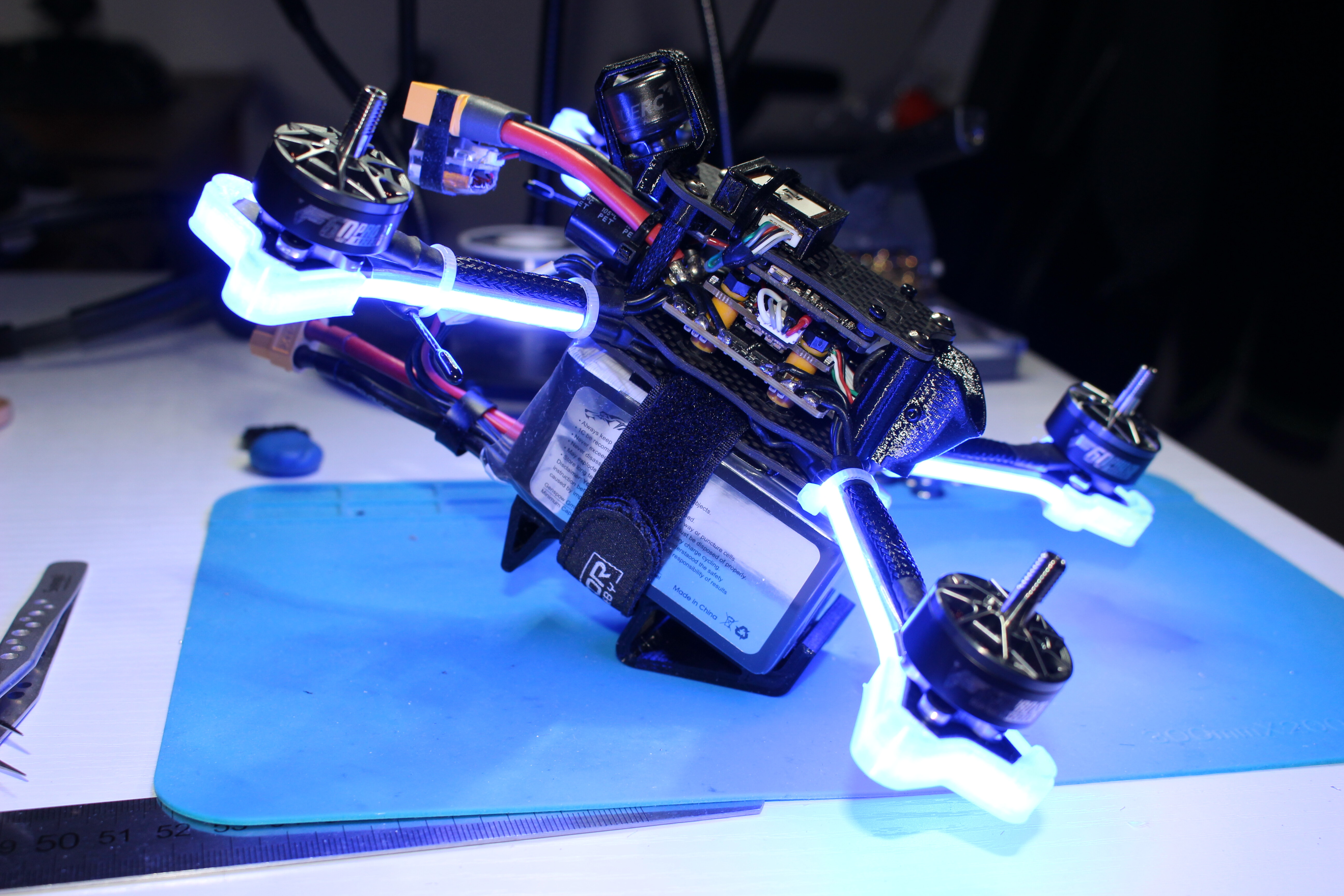

closed (just about) and ready for a test flight tomorrow :crossed_fingers: - lets see if I get any gps signal with the vtx on :sweat_smile:
uaw 560g with a 1400mAh
may need to rework the cam angle though - looks like 50 degrees - bit more than what I had in mind for a first flight :slight_smile:
Nice build :clap:
That’ll look good in the sky on Saturday night :+1:

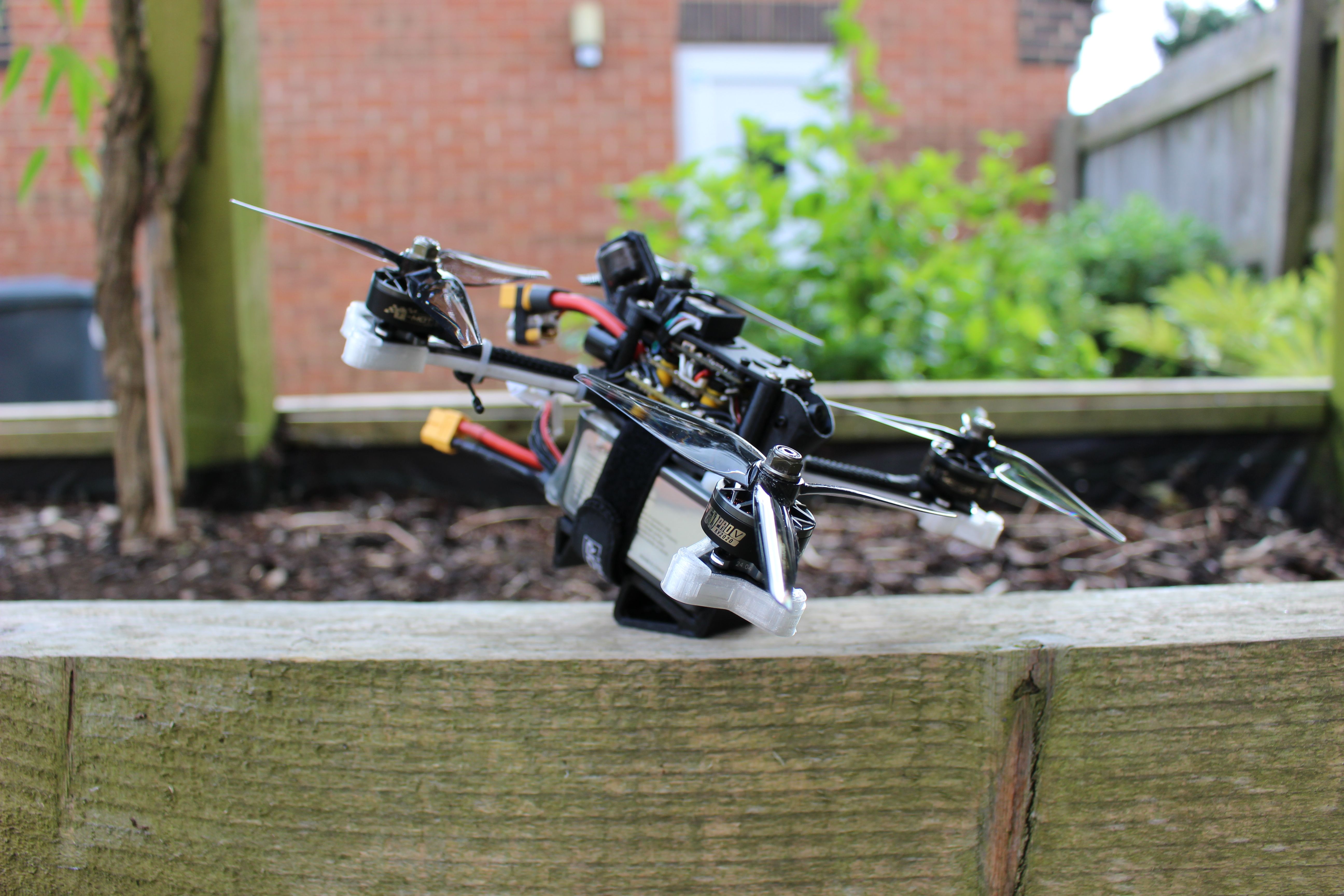

Its a wrap - flies beautifully with the karate race presets - my new favorite quad :slight_smile:

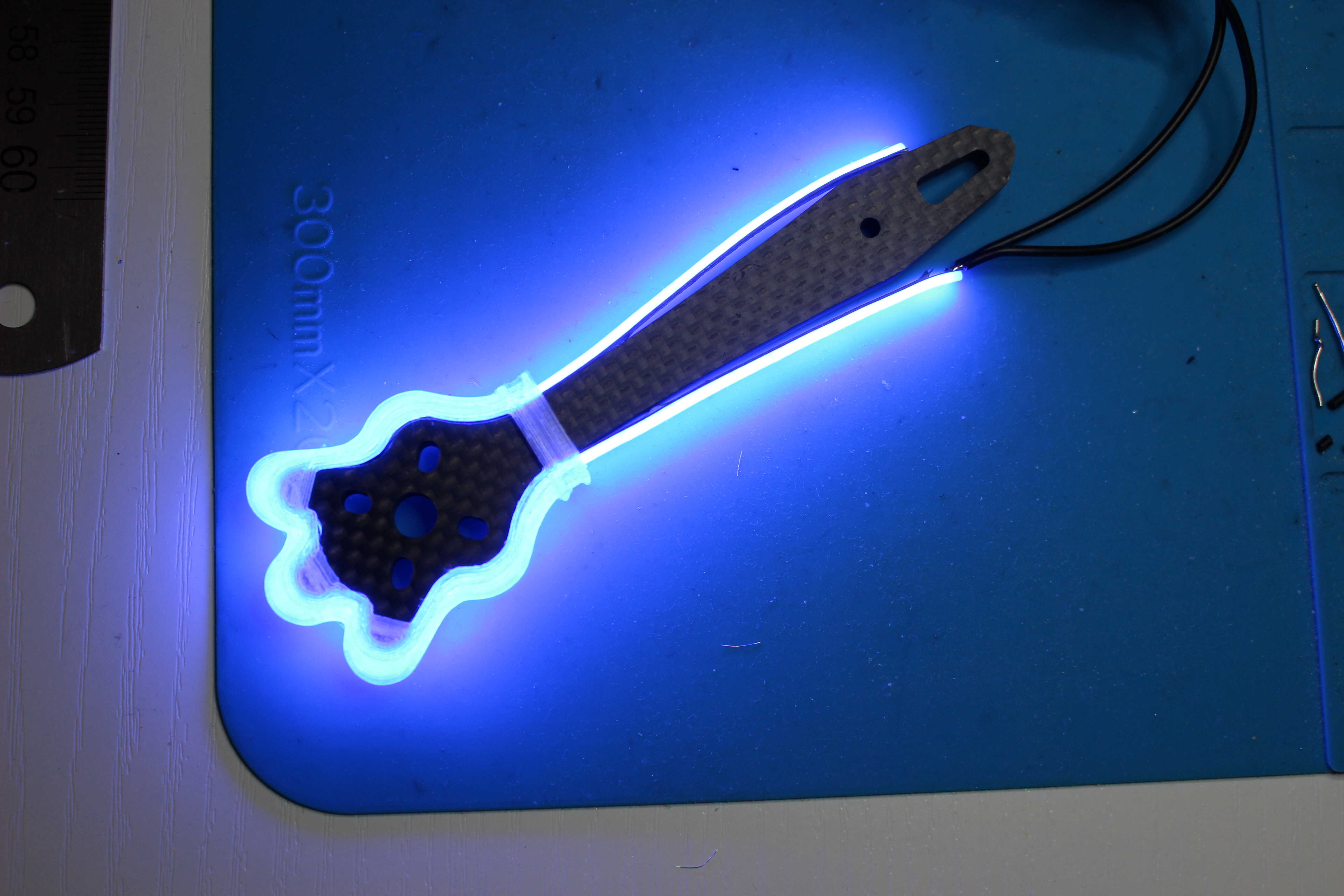

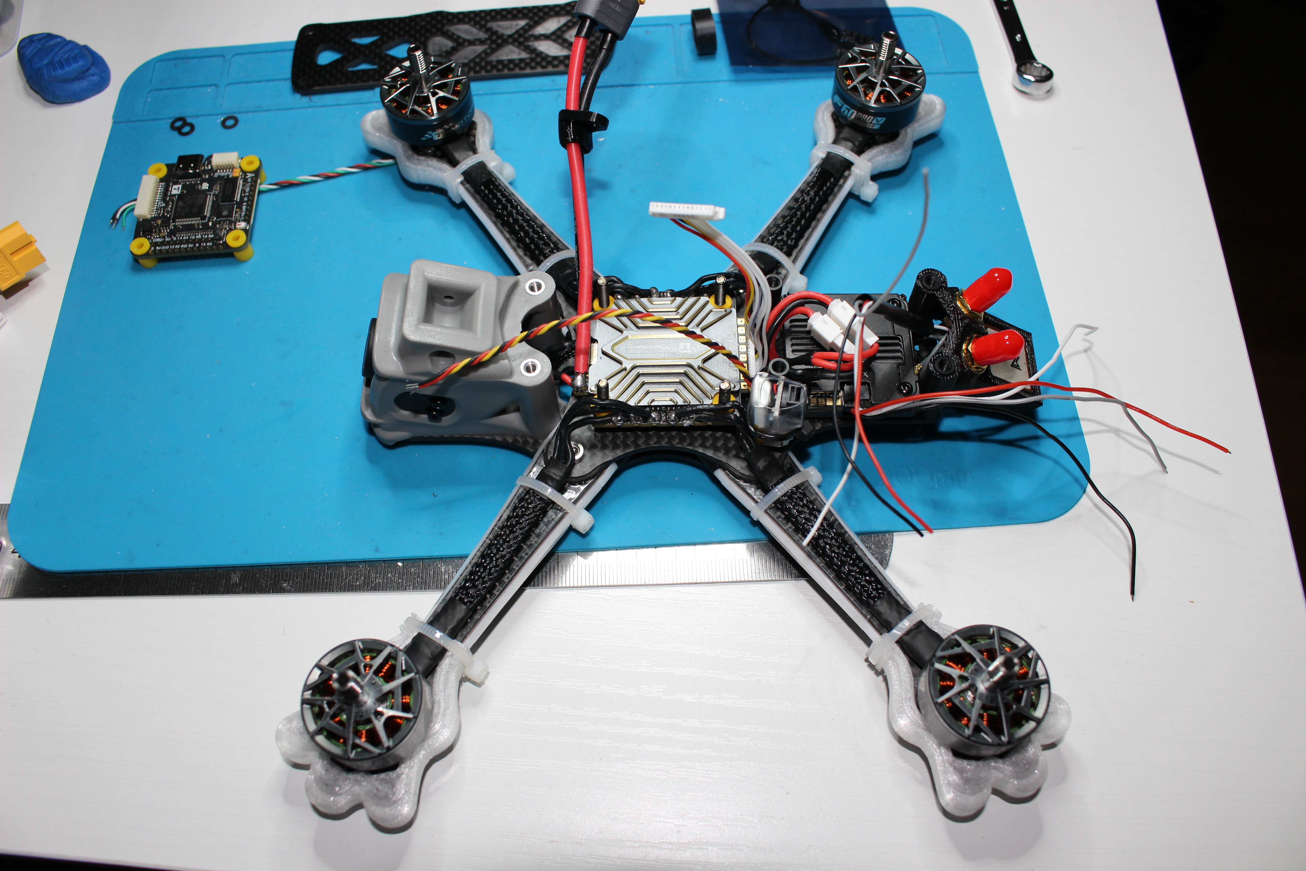

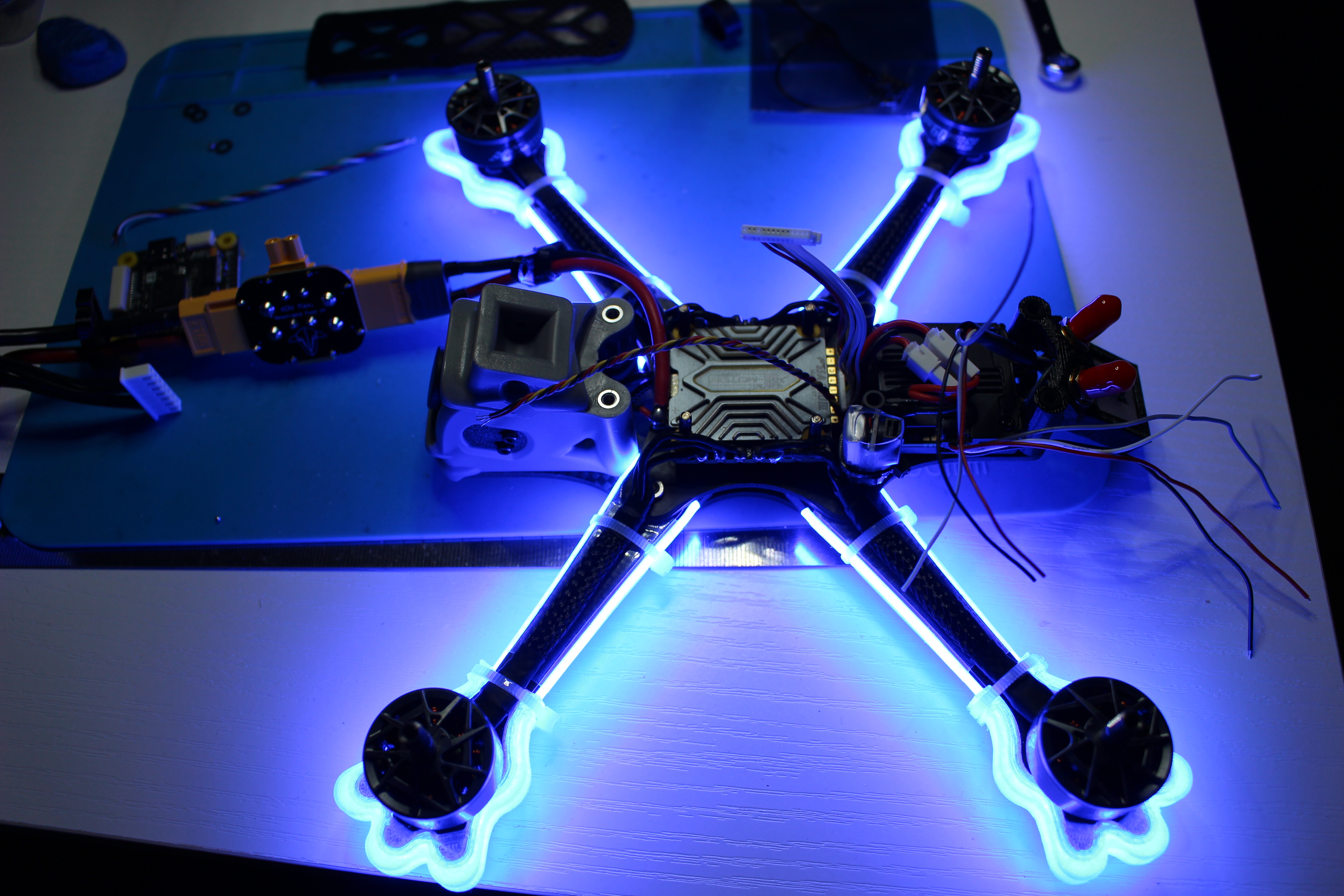

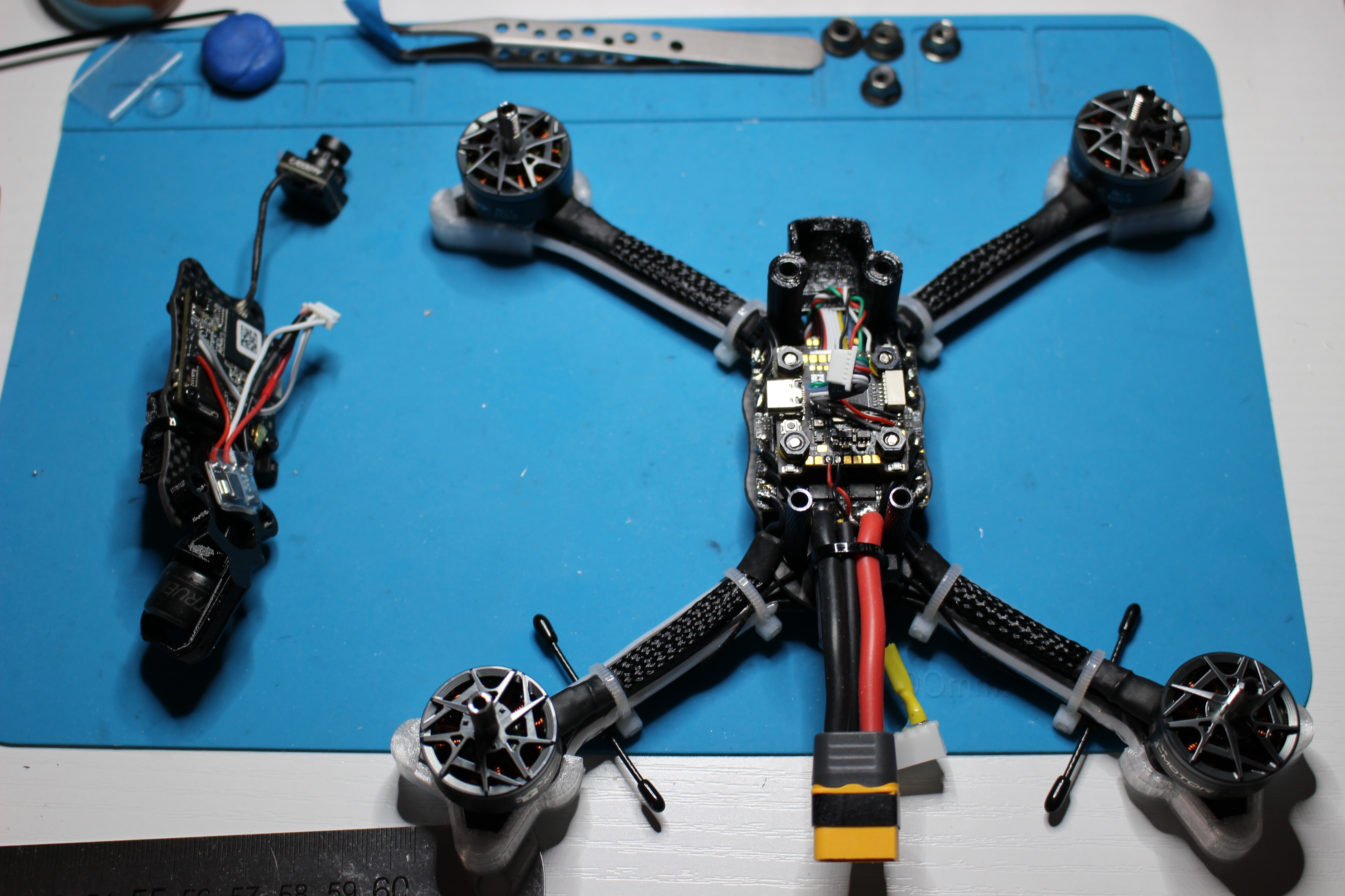

The plan seems to come together nicely - fitting in the new very tight Era 5" frame my signature LED’s ( :smiley: ) as well as a GPS and a buzzer (because why not :slight_smile: )

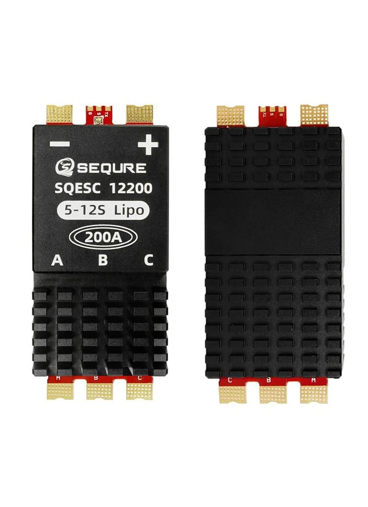

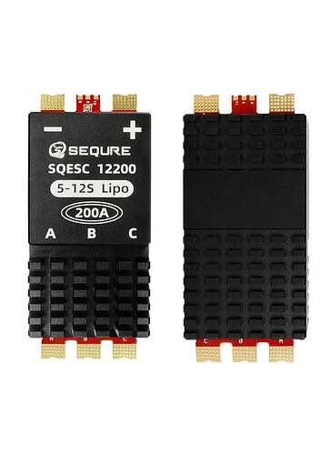

finally - anybody has any experience with Sequre ESC?
In a nutshell - ADP who was the prime supplier of the 12S electronics has just retired from public/hobby sales (to focus on military programs…) - so everybody is looking for alternatives and they seem few and far between…

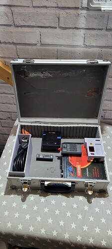

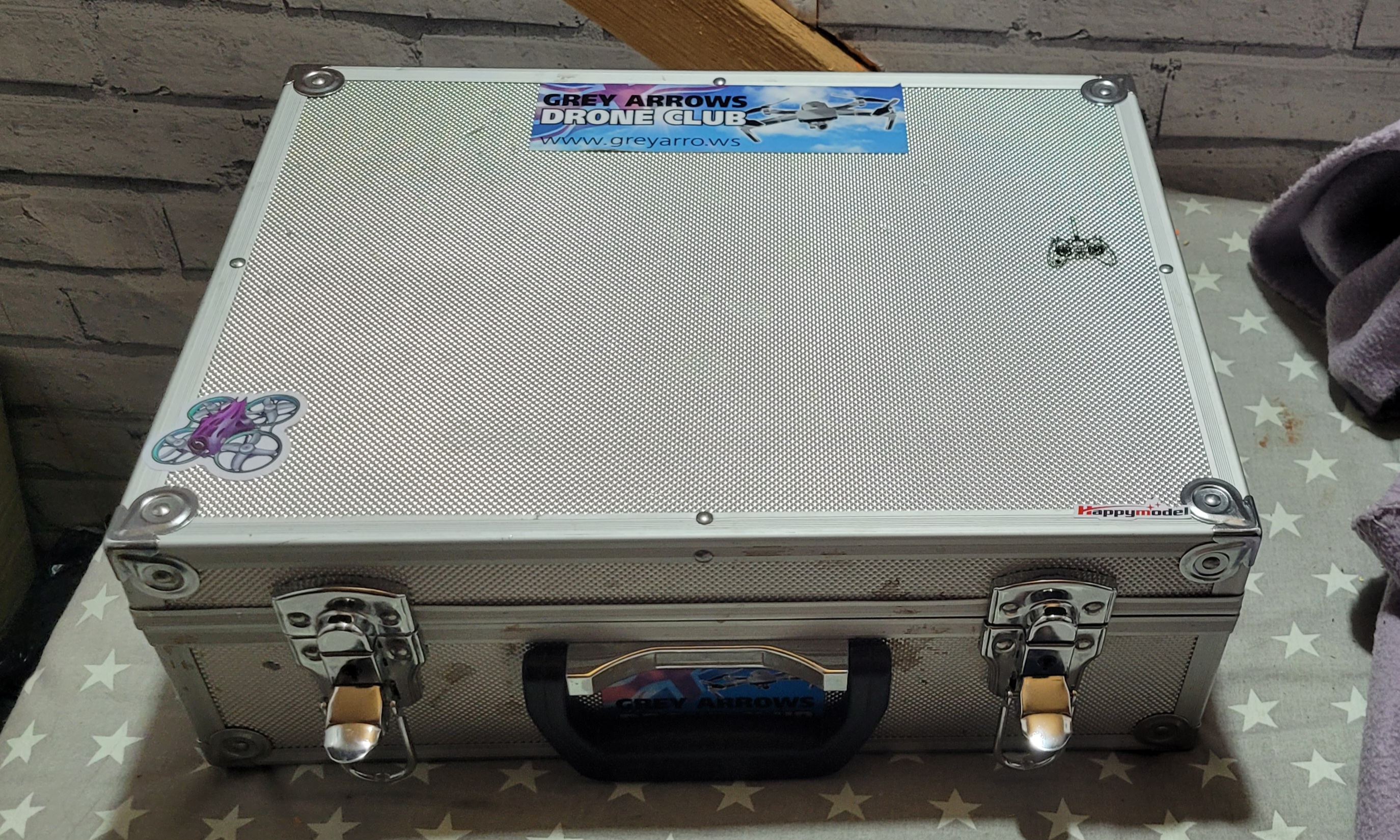

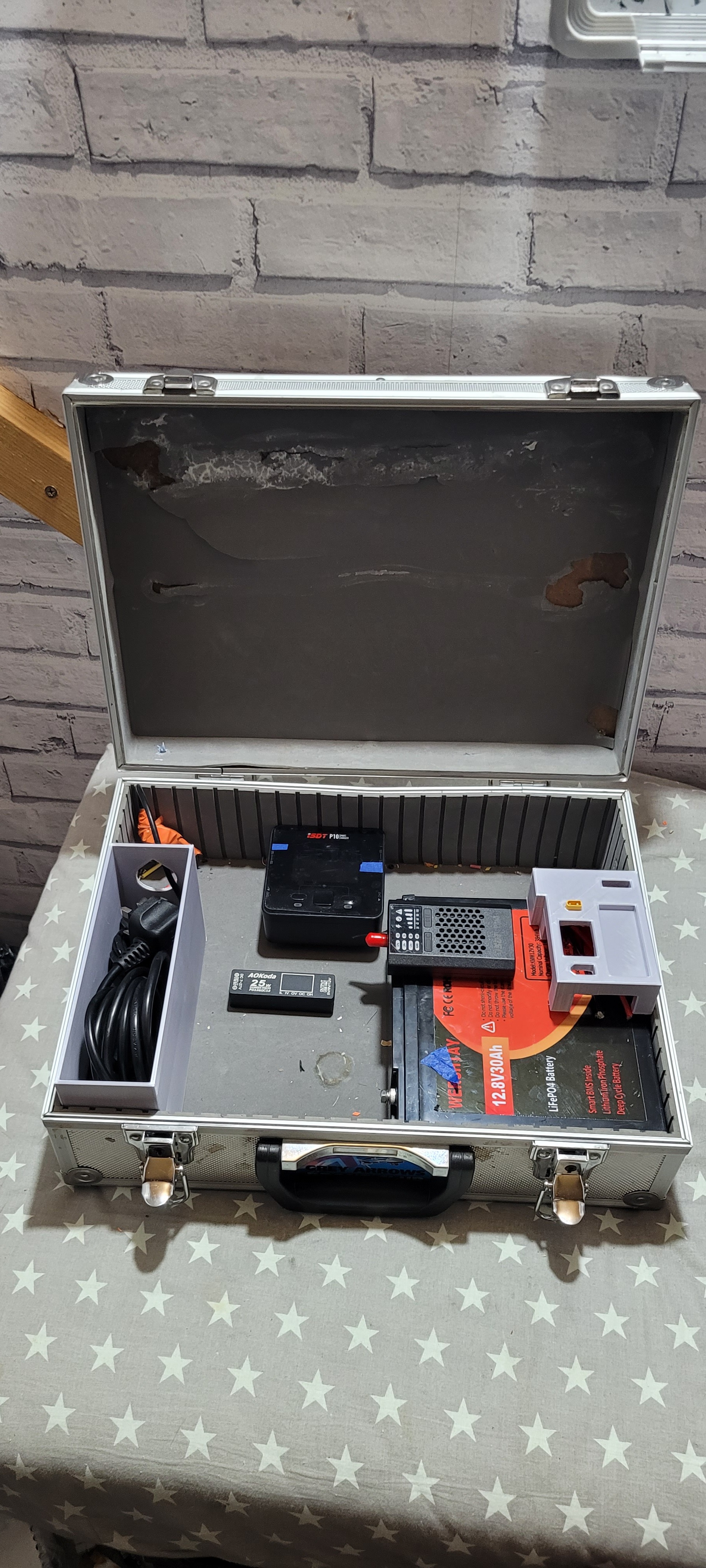

A flight case power unit.
Just waiting for last parts to arrive on slow boat.
Load of internal wiring to do with 7 switches. The design will means I can switch to power chargers from laptop or 30Ah battery. Or have the isdt charge the 30 AH battery. With switch to allow the AOKoda to discharge either XT30 or XT60 batteries to 3.7V via USB sink (cooling fan). AOKoda has a cut-of voltage you can define.
Initial testing have found a bug with the isdt-p10, it has a USB input but does not negotiate PD3.0 correctly. But I am not going to power this with USB.
OpenSCAD model to print out the supports
Will work out costs at some point - but less than half ECOFlow costs on initial estimate.
