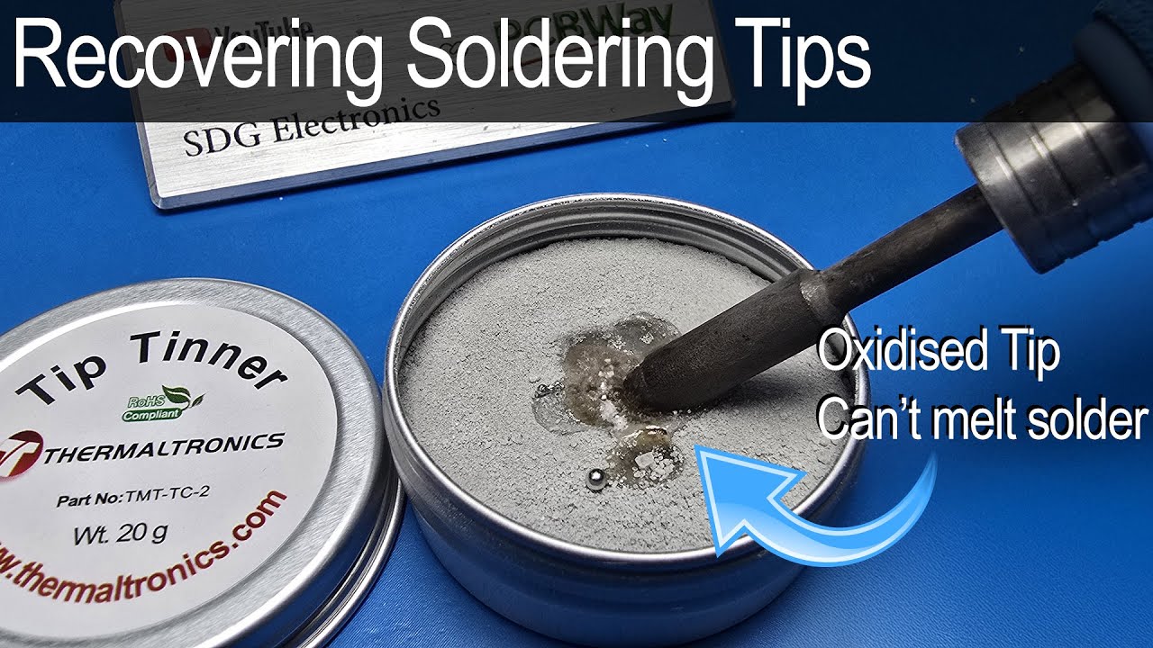

Very odd, but a YouTuber I subscribe to released a video about this in the last few hours, may help you.

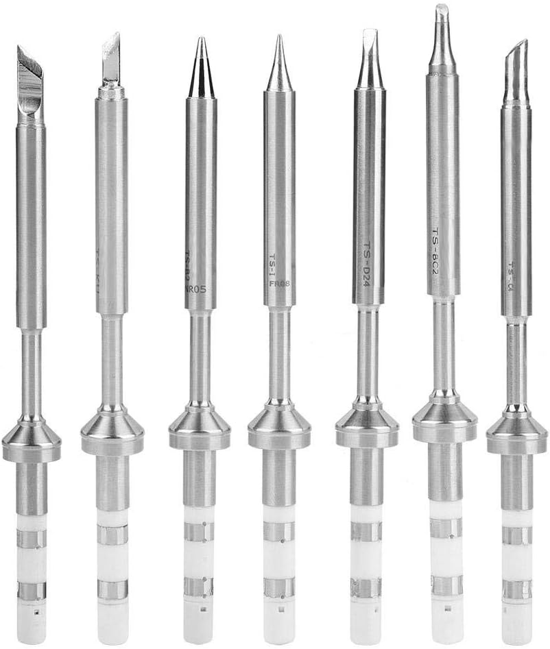

£14 no brainer if you ask me…
(assuming its a TS100 that is)
can probably get them cheaper from elsewhere.
As I’ve just checked that listing and that’s £14 for a single tip not the whole selection in the picture that I first thought. So have a shop around that was just the first result I found.
Cheers mate I have Sequre S1012 Pro so not sure if they would fit, but agree bargin as the tips for mine are a fiver eack on hobbyRc :sob:
