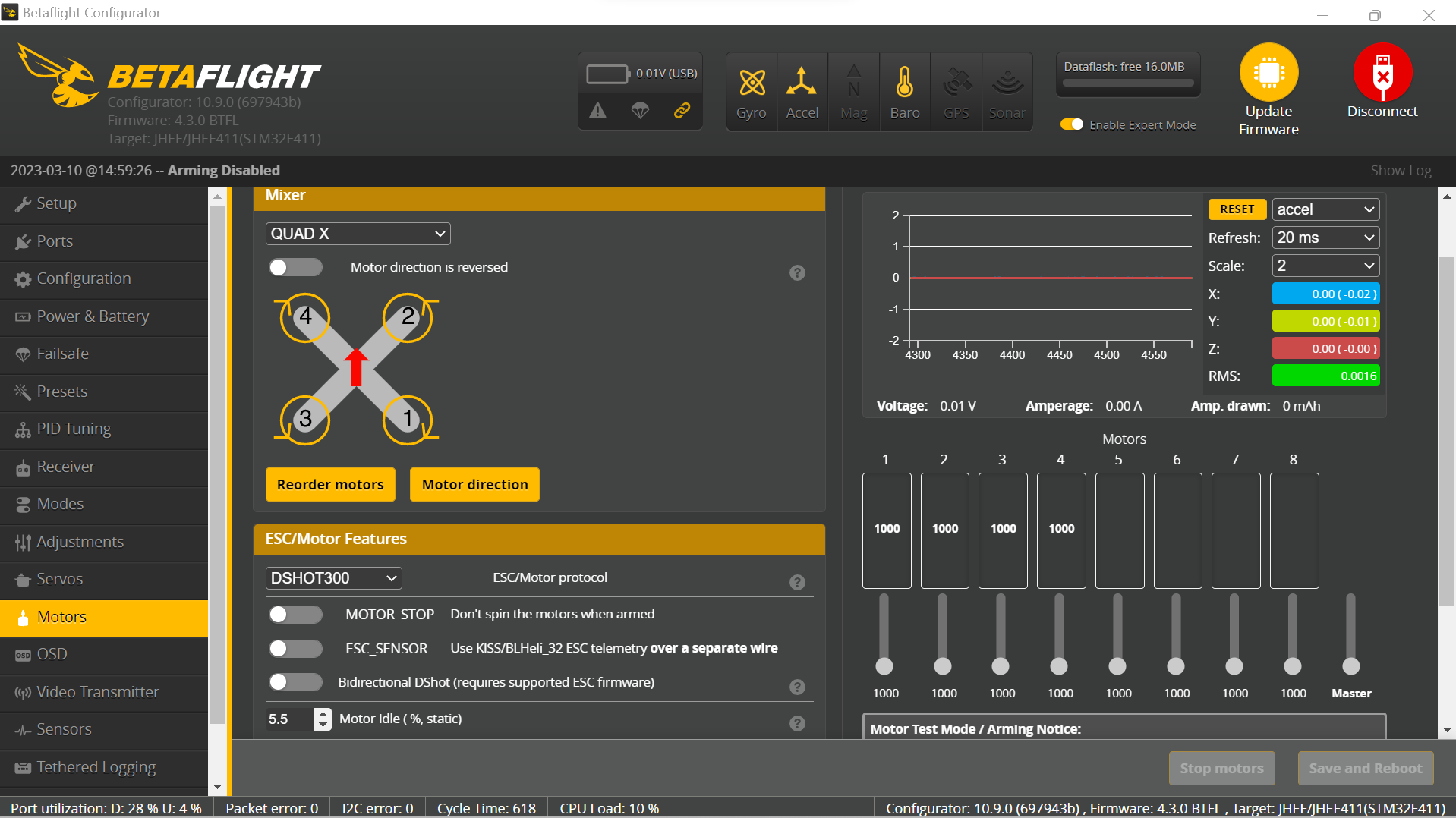

Can you screenshot the motor tab?
Plug a lipo in to see what tones you get
