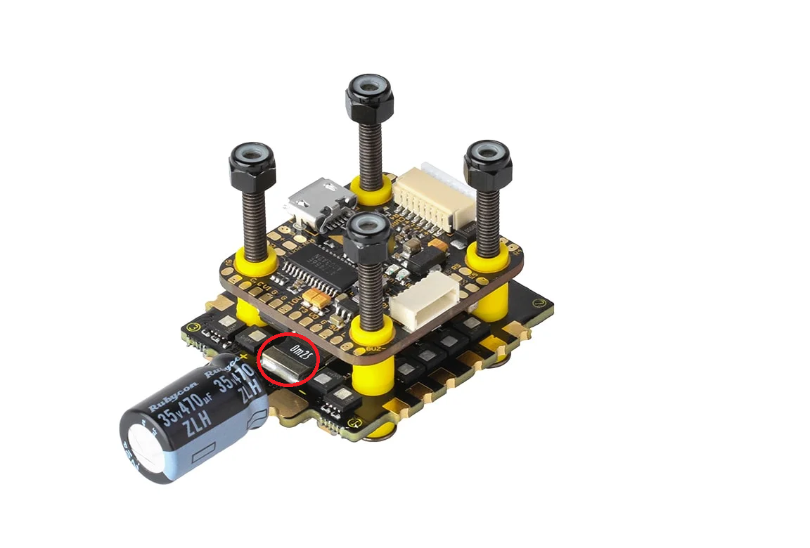

I do have continuity either side of this, not sure if I should but might be able to replace it :thinking
But did manage top track it down here :sunglasses:
Ok I can order 3 from China with P+P for $6, just need some advice as to if its knackered or not ??
You definitly should !
That’s the current sensor very low resistance resistor/shunt. Very very unlikely that fails
:smile:
Shit that blows that fault find right out of the water :man_facepalming:t2:
Back to the drawing board :weary:
