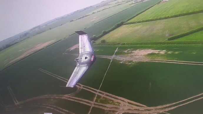

Nice… She flies (after getting loads of things working haha)
Great capture Martin @GunjaFPV love it :heart:
Well done Nick @BigDog for yur first flights today :+1:
And the full film
