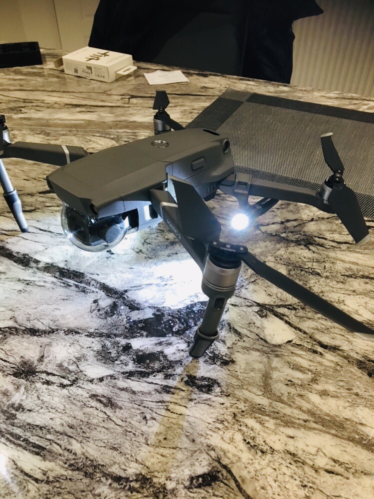

I fitted them to the front legs, used strong Velcro, UNTIL…I tried to take off in the dark and the flashing of the strobes fooled my MP2 into thinking there was an obstacle and it started to fly backwards trying to avoid the ‘obstacle’.
So I then fitted just the 1 strobe to underneath the craft so I could see it in the air at night.

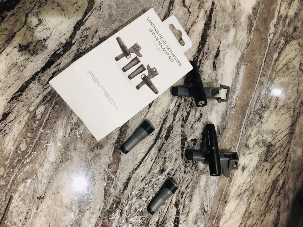

Since then I bought a set of pgytech landing leg extensions complete with Cree lamps, they cost about the same but fit better AND they don’t interfere with any sensors.

Did you ever try fitting to the underside of the rear arms as I had done, @Brian? I’ve never experienced any issues - 360 degree visibility - stay on 24/7 - don’t get in the way - arms still fold without removing them - can access easily to recharge - no impact on airflow - etc.
I did think about underneath the rear arms. And in retrospect after my scary flight it seems a good place. I thought I’d share my experience of fitting them to the front arms, facing forward.
I do like the strobon crees because they are small and light, however having had the batteries on them suddenly die in flight, I’ve decided to use them as a back up to the pgytech lamps and use one at a time so that I have a fully charged spare in my bag ready to change if required.
