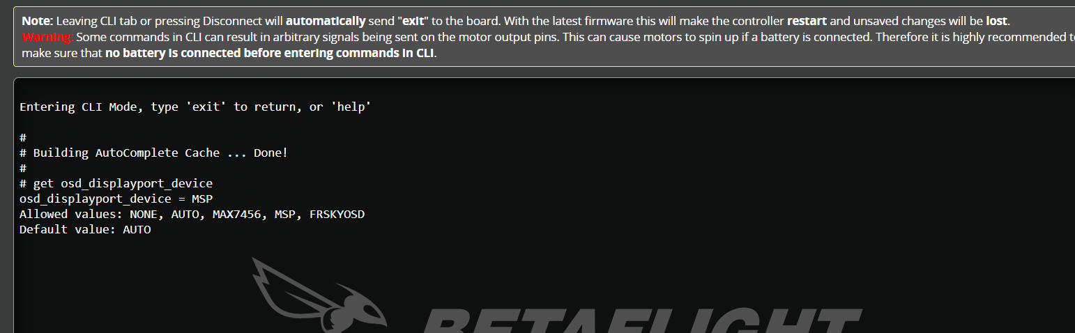

Ok not going so good Iv got the below in my CLI but not sure what its telling me would anyone be able to decipher ???
Says you’re using MSP for the output (which is correct). Obviously without the port config and what version of bf you running hard to tell.
