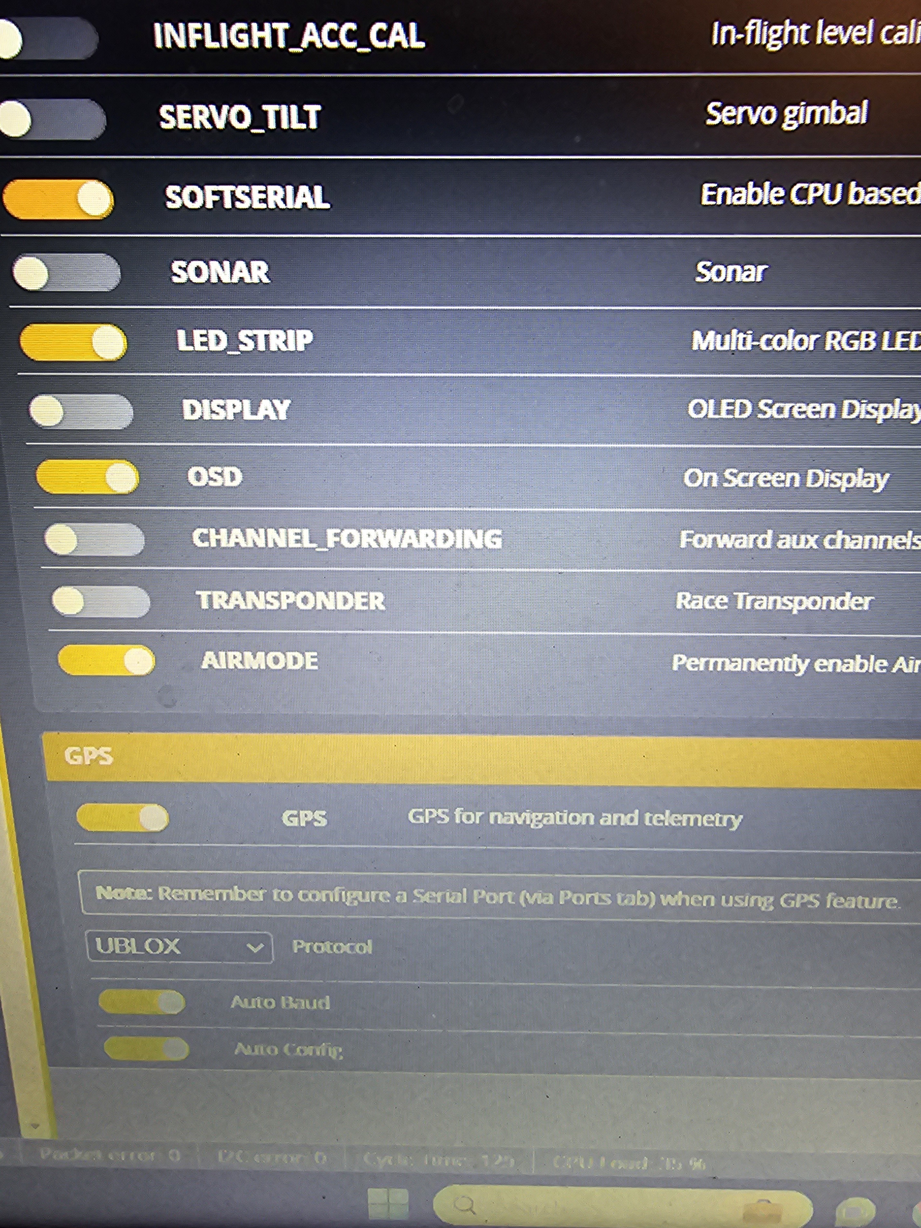

I’m not getting any OSD ion my goggles now iv set everything up as norm and even my RSSI so I can see my signal strength but nothing ???

Do you have it switched on in beta flight?
Yah I did mate thing is it’s the same on both quads that I’ve fitted crossfire to??? That’s why I wounded if I’d missed something when setting up the tango2 ???

Ok watch the JB vid and a little confusing :thinking: but doable, I also found the below but was wondering about the MSP as I dont have mine turned as Im sure in the crossfire tutorial I followed it said to turn it off. Would this be right ??? and if I turn it on and follow the below would that give me full OSD ???
I’d follow the WTF OS setup and turn on MSP in the ports tab to what ever uart you’re using for the vista/air unit.
uart1 is my OSD on my babycroc.
Also make sure you’ve got OSD turned on in the config tab.
:+1:t2:
I think the newer version of betaflight firmware might make it even easier by having a WTF OS drop down on the ports tab maybe I’m not 100% on that though.
