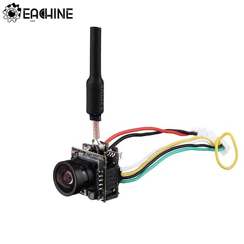

I mean really… my first FPV camera and VTX was Ā£10.50 shipped from china. Now I’m paying over Ā£100.

My first vtx was TBS Unify Pro32 HV £40 and camera was Caddx Mini Ratel £30. Just checked prices and theyre around the same price now lol I guess analogue hasnt suffered the price increases as much as the digital side
