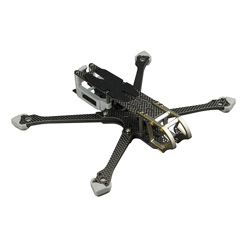

I’ve got this… very pleased with it, good price… and it’s in stock !
A frame with thick arms. 5 or 6 mil
to elaborate…
5"
enough space for HD Video or high power analogue
fixings for EDIT 30.5mm stack in middle and 20mm in rear position EDIT
Thanks Steve. I like the aluminium front end to protect the camera. I reckon I’ll make use of that. I was on the site when you posted, looking at the Lumenier QAV-S 5″ …
But yours is nearly half the price, thicker and better protection …

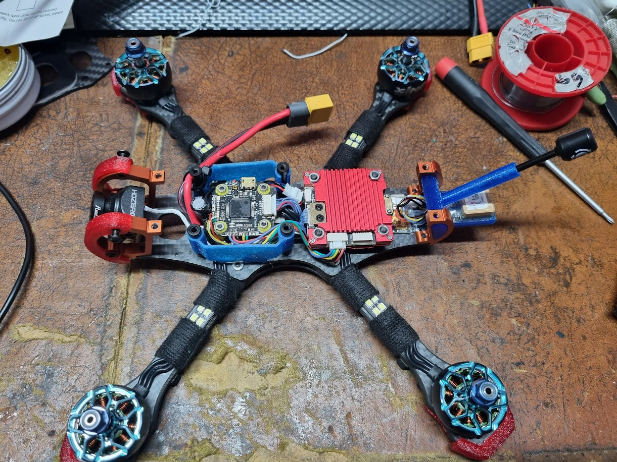

30.5mm x 30.5mm
Stacks, usually of FC on top, ESC on bottom. But you can put other things on these as well. The HDZero Freestyle VTX is 30.5mm
Usually used in 5" quads and above. The most reliable and easy to work on. Also the biggest.
My 6" Badger frame with 30.5mm FC/ESC and VTX
20mm x 20mm
Again square on. Usable in all quads from about 2" upwards. Usually a stack of FC and ESC, but my 4" quad actually has an AIO in 20mm. I’ve never seen another like it.
My 5" Beaver with 20mm stack in the front, 30.5mm HDZero VTX in the back

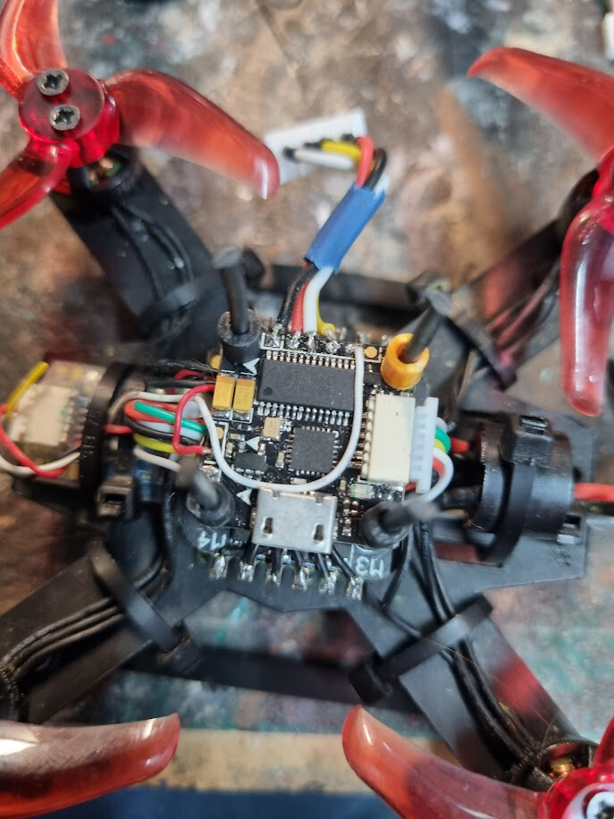

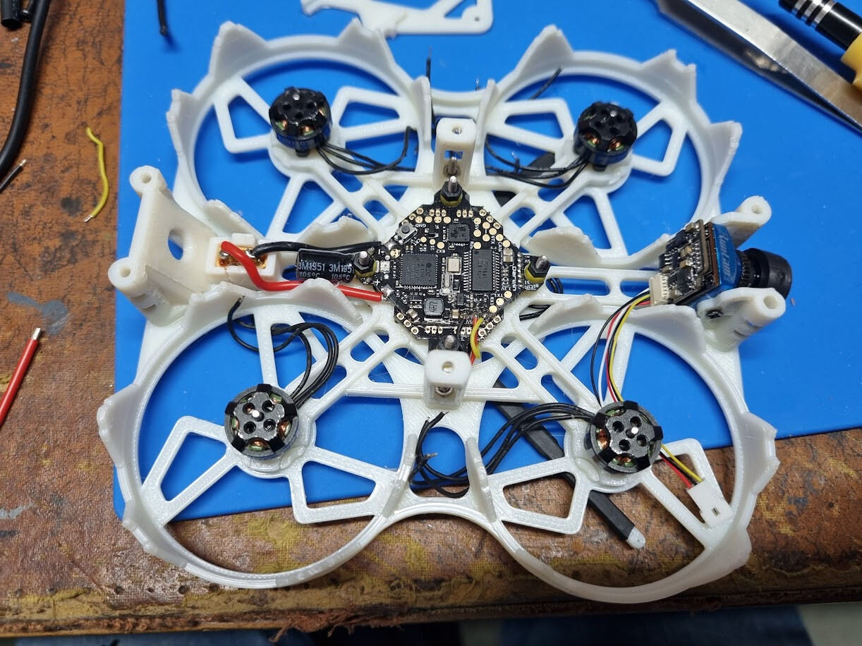

25.5mm x 25.5mm
The Whoop/Toothpick size. Almost always an AIO board of some type. However what is on the AIO does vary a lot. Put on in a diamond shape. All tinywhoops have this style. HDZero Whoop VTX is this size as are the Walksnail VTXes (for some unknown reason)…
Diamond F4 AIO board from happymodel in one of my tinywhoops.
25.5mm whoop AIO board in my defunct 3d printed 2" cinewhoop. It was too heavy.

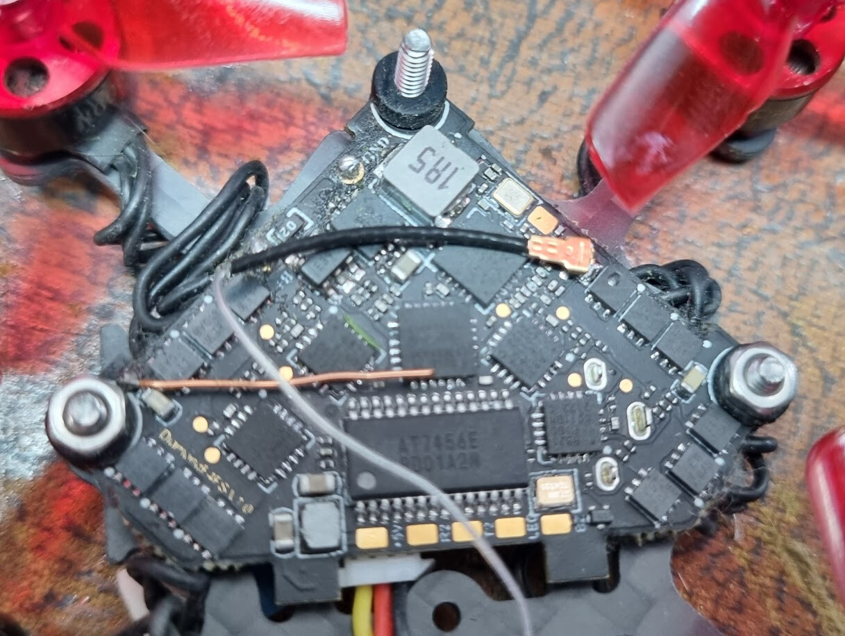

Last and most definitely least 16mm x 16mm.
A now rare (thank god) format for smaller quads. a square-on mini stack board. I started with these and almost every single one of them died. They were cheap and most definitely nasty. Too small to have decent components, they broke all the time. Avoid like the plague!
My first ever quad. A 2", with one of these horrid things in it.
