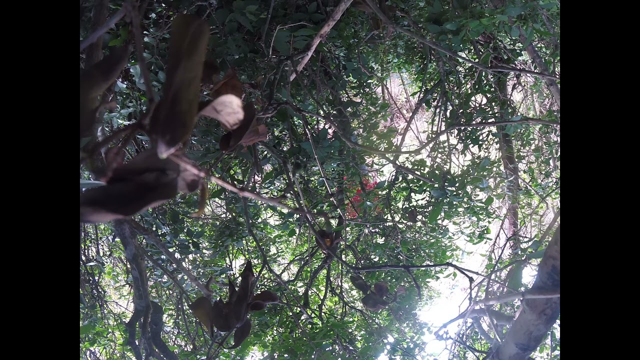

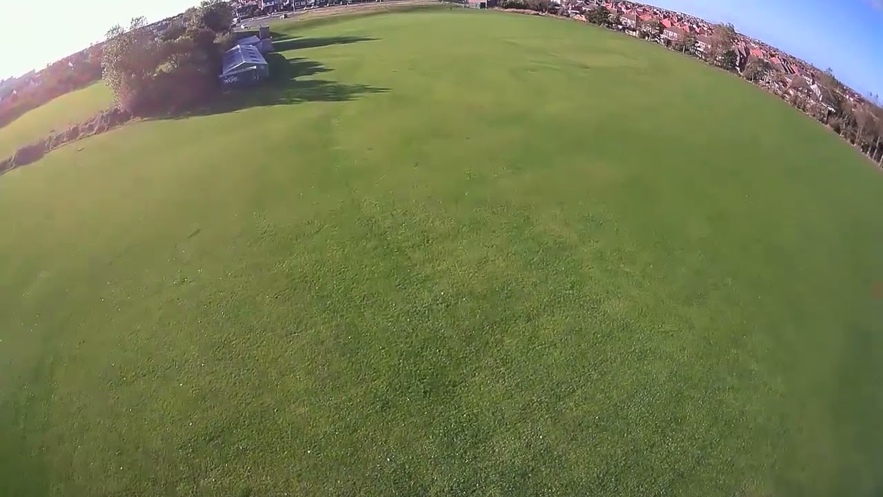

Flying back across the playing field the drone suddenly made an uncommanded nosedive into a tree.
Telemetry from the DJI Goggles shows RC signal strength dropping rapidly to zero, though video signal strength remained OK, and sound from the GoPro indicates the motors just wound down.
This was approx 80m from where I was standing, with the drone heading back towards me, and I’d previously flown over the same area albeit in the other direction - so very puzzling
Video also includes the recovery by poking it with a stick :smiley:

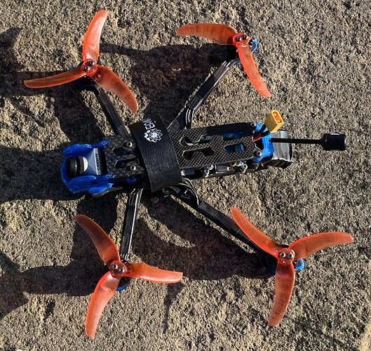

Certainly looks like a failsafe, have you checked your antennas etc? I started getting worse signal performance in previously good places and realised one of my antennas had broken so I got full signal in one direction and half on the other side.

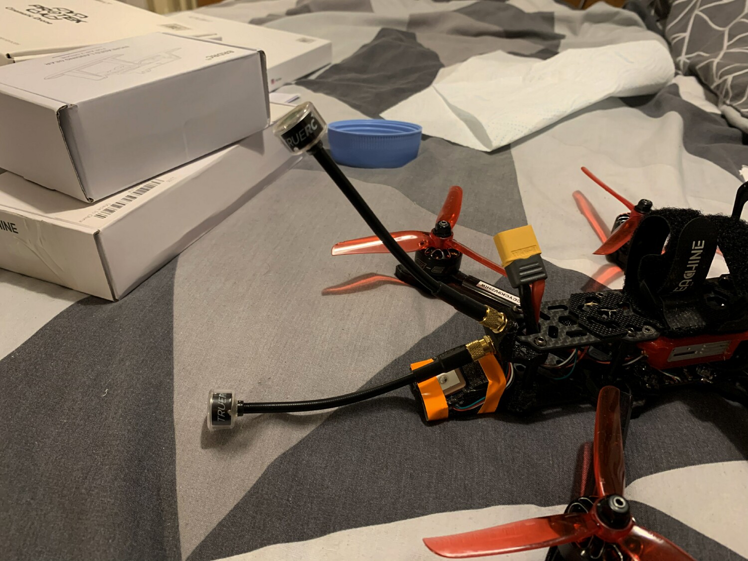

The antennae seem fine - though I’m not particularly happy with the way they are arranged on the DC5 ( see pic below ) so I’m currently 3D printing a new mount to relocate them
are those not the vtx ones?
The DJI air unit uses the same antennae for RC and video
Weird. Only thing I can really think is due to orientation having both blocked by the carbon of the frame and the battery was possibly to do with it…but even DJI gear should be fine at that range.
In that case the fact that you lost control and not video implies its a separate issue.
Yes, very mysterious.

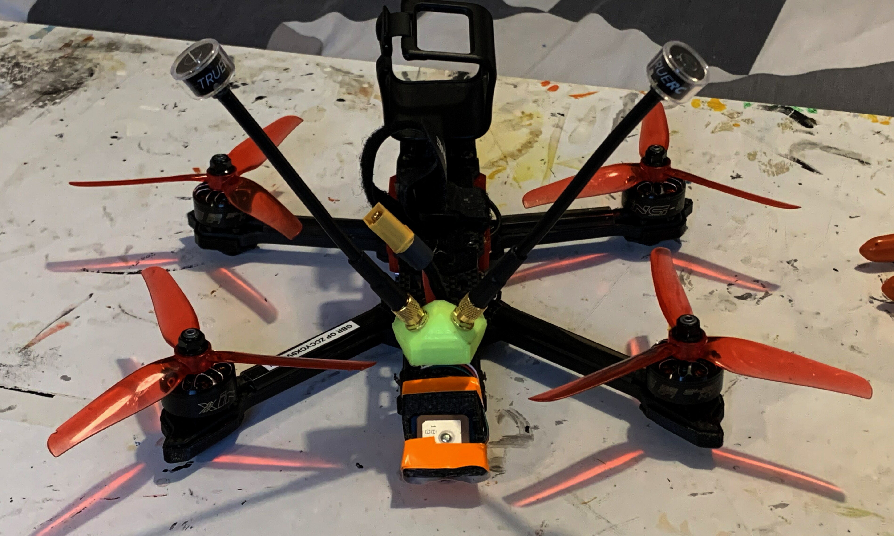

Antennae relocated and ready for a test flight tomorrow ( weather permitting ) :slight_smile:

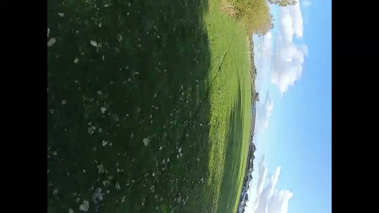

Unexpected object in the viewing area…

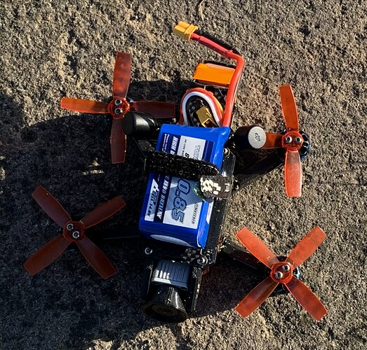

Result - One bent prop, one broken prop - and fingers too cold to be bothered swapping props ( Chimera 4 )
You have your fair share of crashes!
Did you get attacked by a flying crisp packet?
All part of the learning process… :wink:

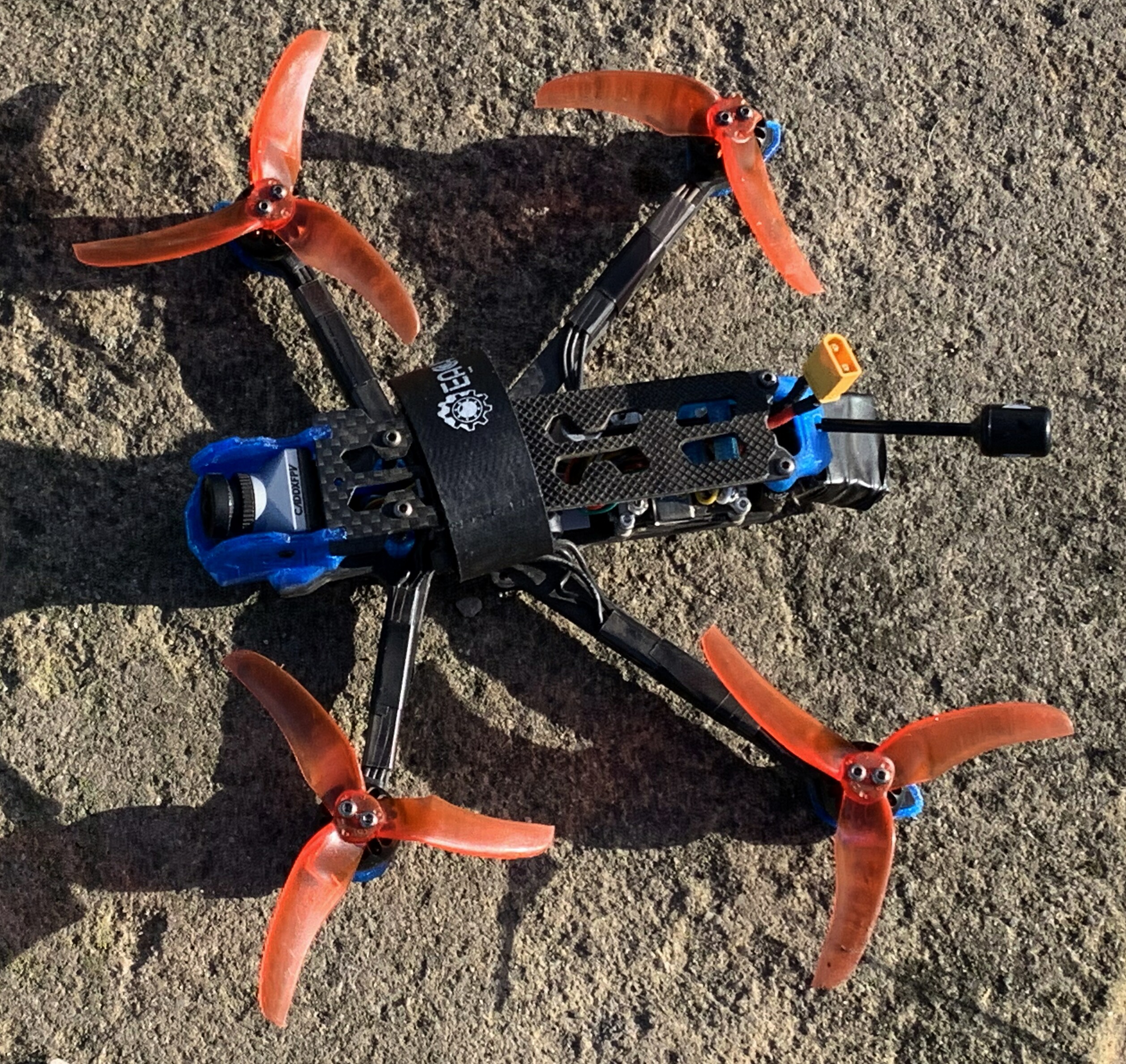

2nd crash ( 10th flight of the day )
Just one broken prop this time ( Titan DC2 )
That battery strap explains it…doesnt look remotely robust enough. Do you at least have a rubber pad under the battery?
Pic immediately above is a different drone :wink:
