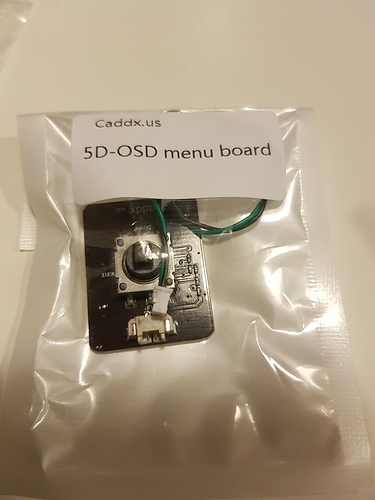

Also, what the hell is this?

Just to set up your caddix I think. For the on screen display. But just use the FC osd.

So first things first. The Caddx menu board.
That’s to adjust the menu options for the camera, basically something you use once and thats it, plugs into the camera and you can access its menu setup.
