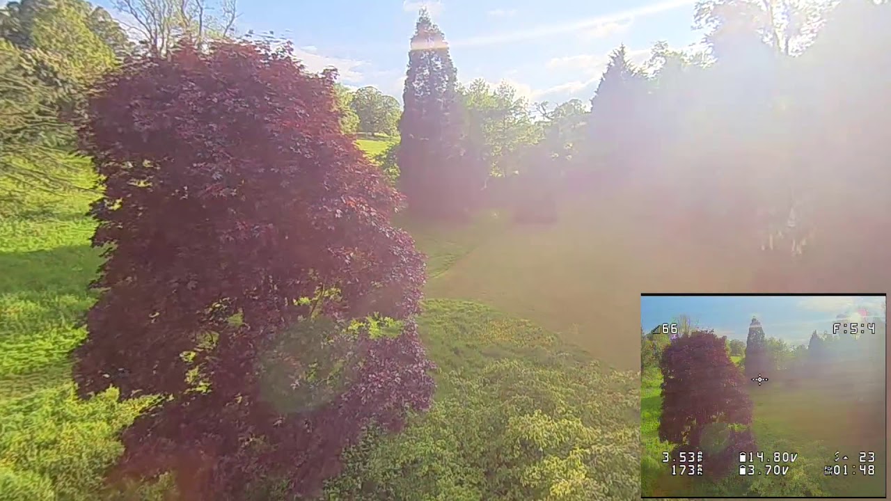

Took my quads out yesterday to a local part, here’s some 3" action, this is essentially the same spec as the Diatone R349 running on 4S
Just paste the YT url without using the link button … and you get the embedded player. I edited your post.
Nice. I got to learn how to do that video in video today.
Excellent choice of music! Says it all when you think most mavic movies are accompanied by enya!
