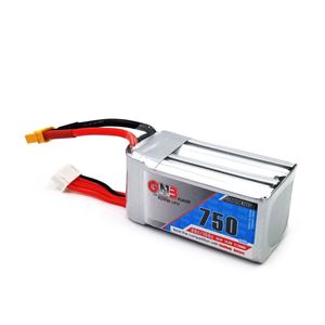

But the goddamn charger only has an xt60 connector! I guess I’ll need an adapter…

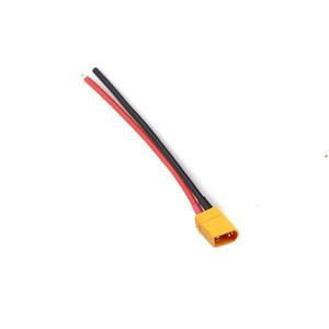

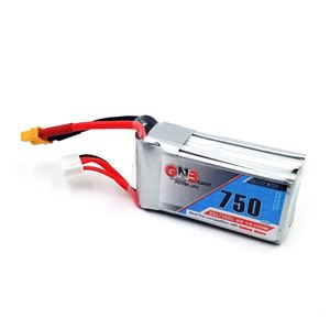

Yeah I had to make my own cables for charging my smaller batteries.
If your returning those batteries to Amazon, I suggest getting the ones linked below instead for maximum performance.
or
If you want something a little more docile to start out. Either way you should get roughly 4-6 minutes of flight time, unless you thrash the crap out of it :slight_smile:
You could also grab,
along with
And make your own charging cables.

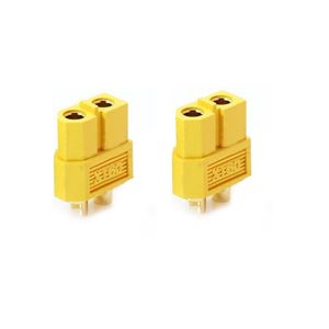

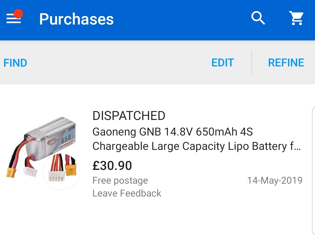

Thanks dude! I already have some of those on order from eBay.
These adapters should help with the charging yeah?

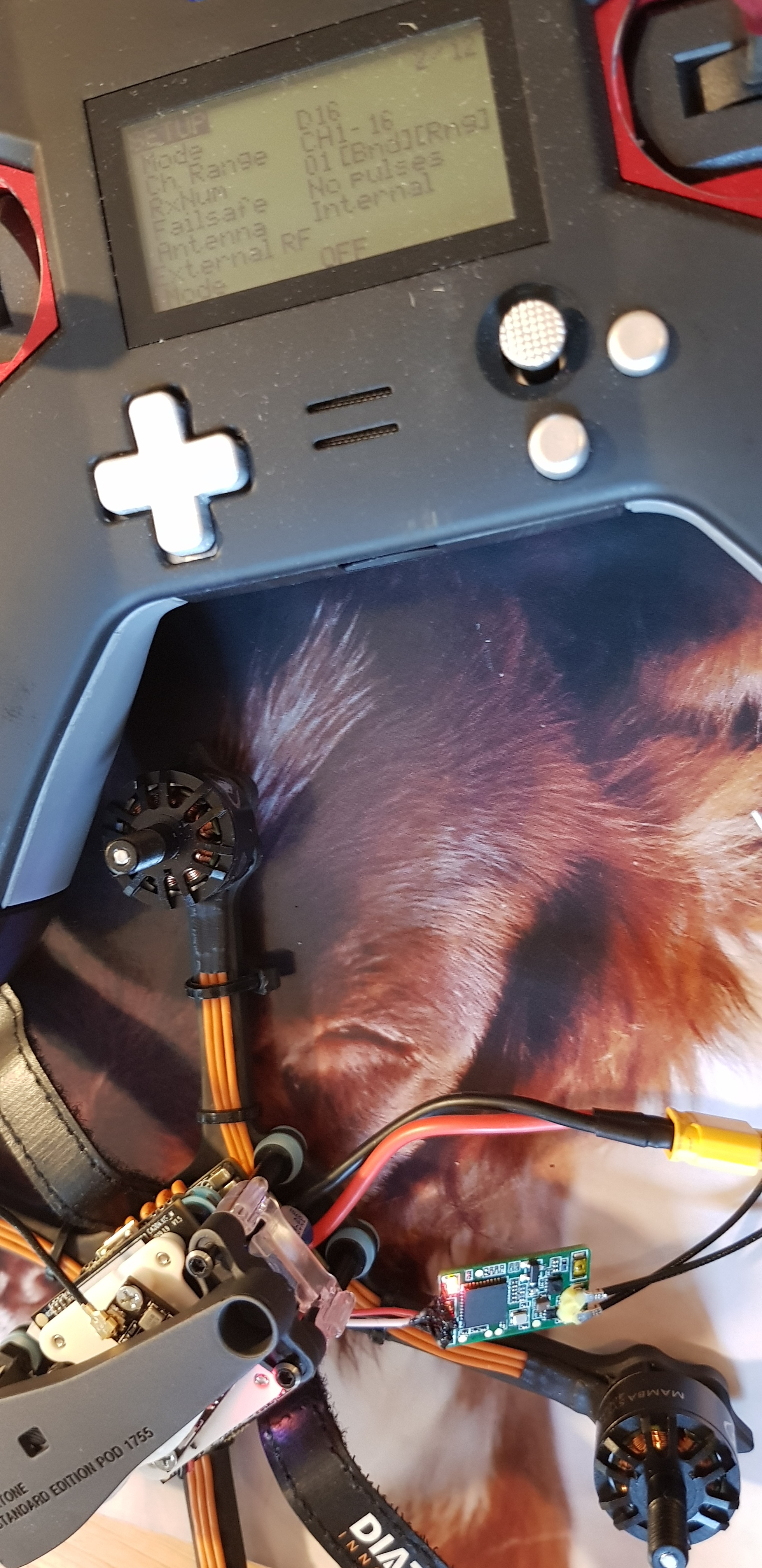

Another plea for help. The XM+ goes into bind mode when powering up with bind button pressed and with blue and red LEDs illuminated. The x lite goes into bind mode and happily bleeps. But powering down and up again doesn’t result in a connection. I’ve checked the mode. Suggestions online are that I need to flash the receiver…but surely something easier?
Where did you buy your x-lite?
If from China its going to be on international firmware.
Receivers and TX bought in the UK are EU LBT firmware and the two are not compatible.
Might be a mismatch.

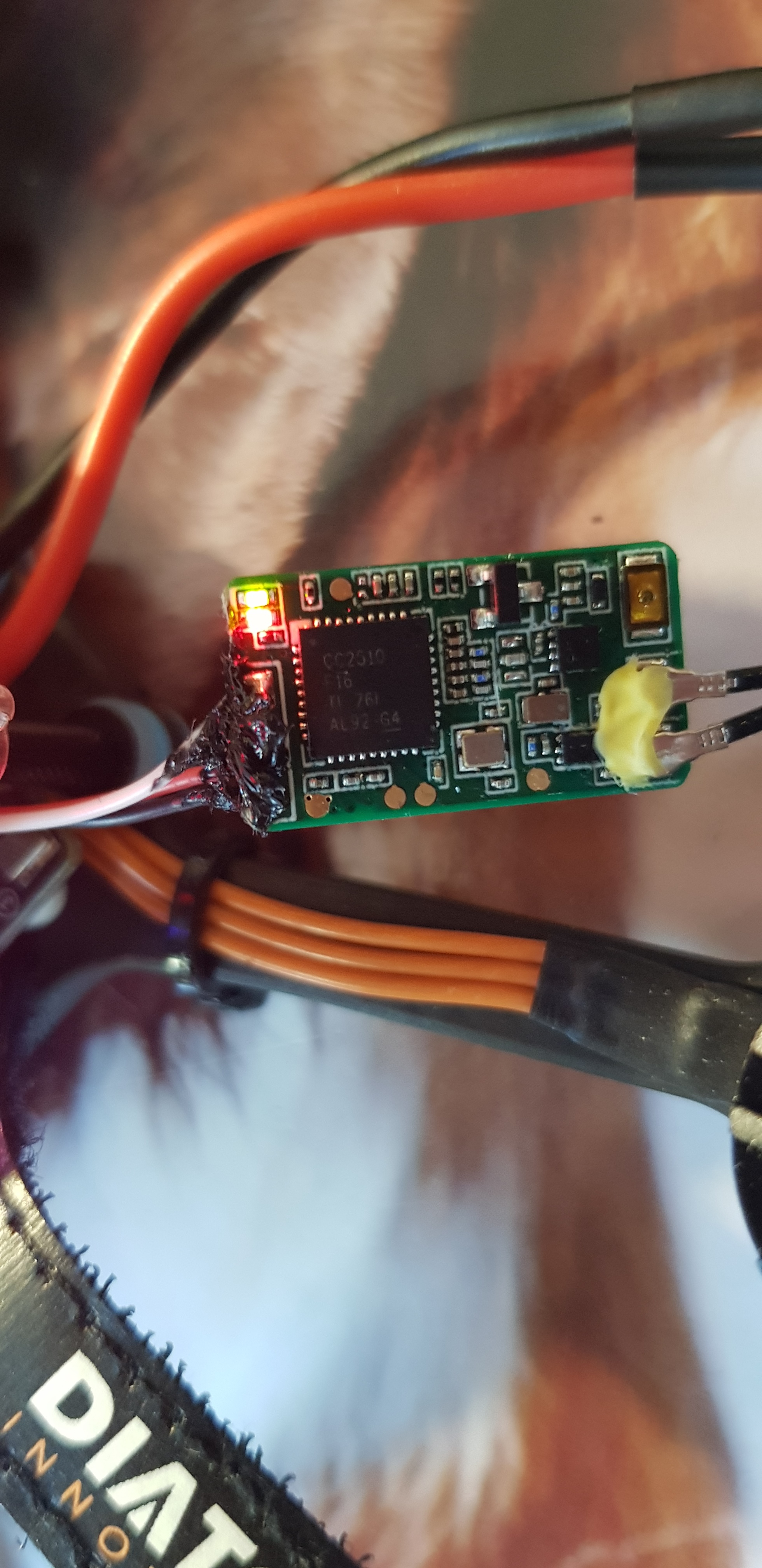

The receiver needs to be connected directly to the TX to flash. The x-lite should have a female connector somewhere you use with a short lead to your receiver.
You’re shitting me! I’ve got to desolder, attach some sort of plug and connect it to the transmitter…! I may cry.
Does the xm+ have no connector? just pads?
S’right. Mind you, a plug came with it…
