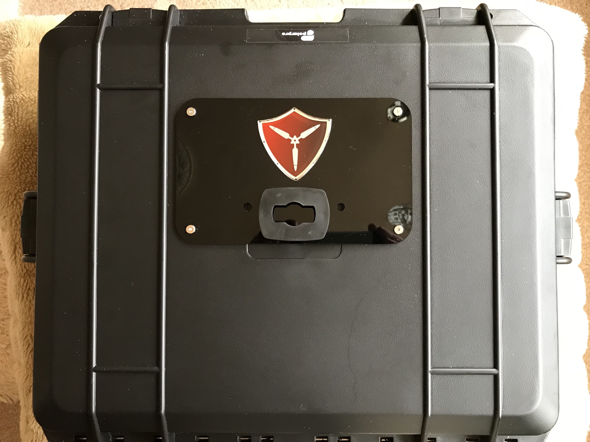

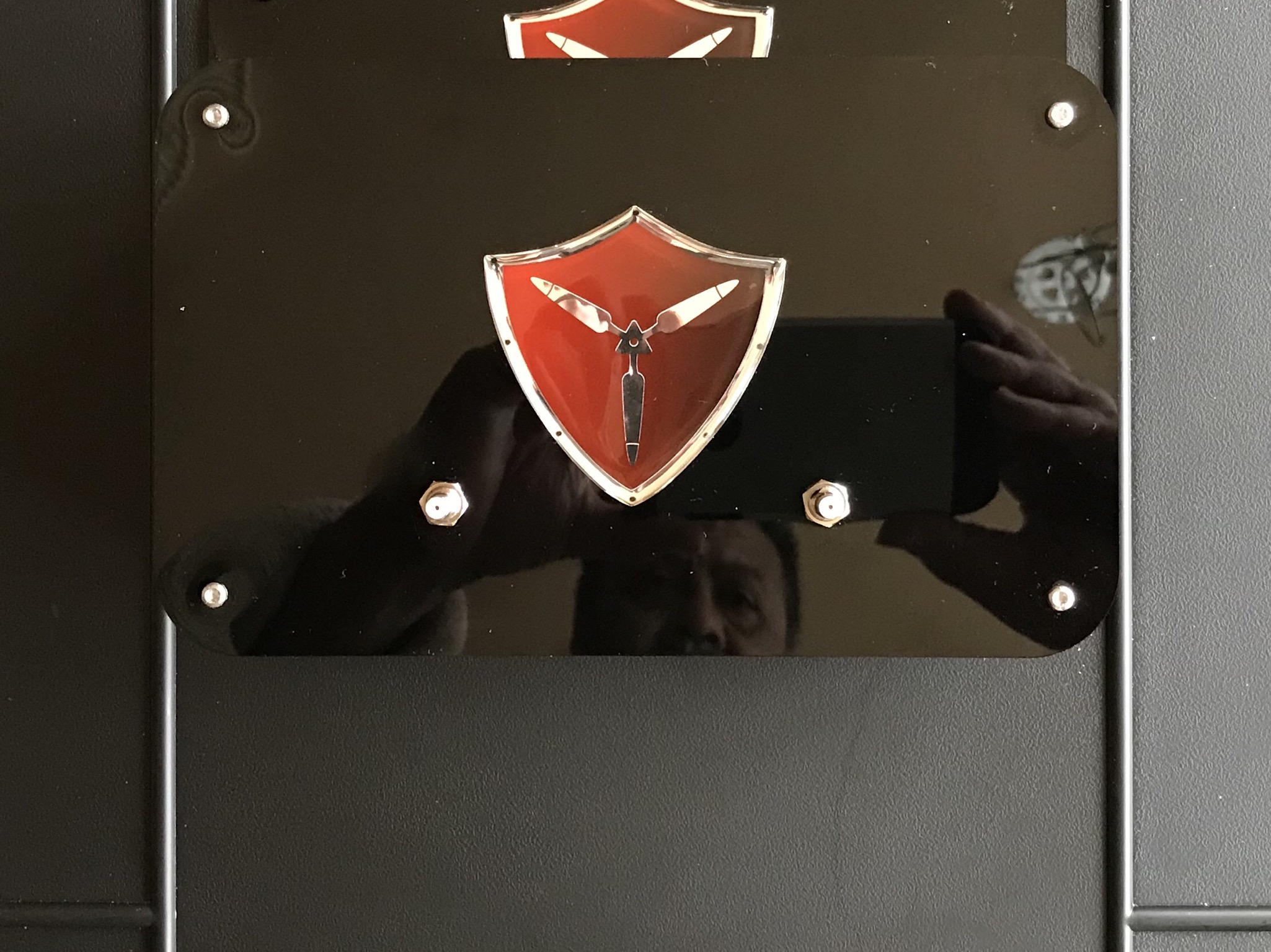

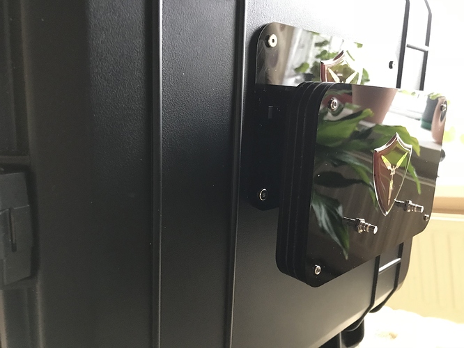

This mod occurred to me shortly after the RC mod was finished. It may also serve as a ground station of sorts, the idea came to mind because I tend to forget critical bits.
Damn!!
That’s a brilliant idea

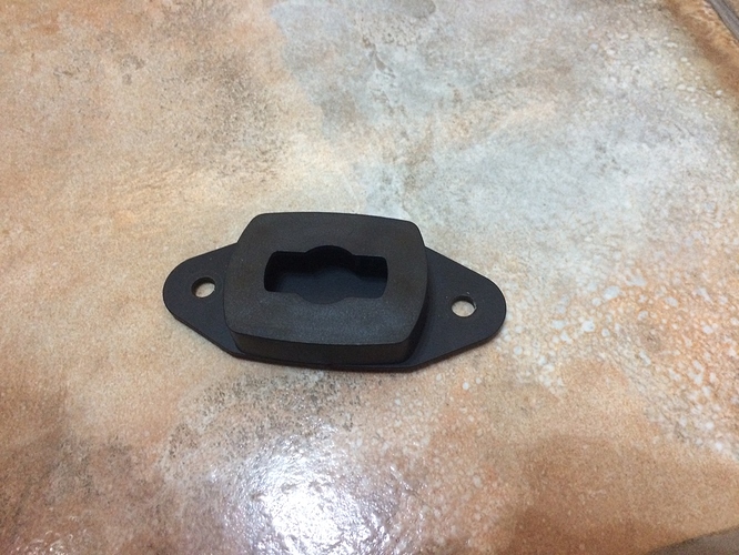

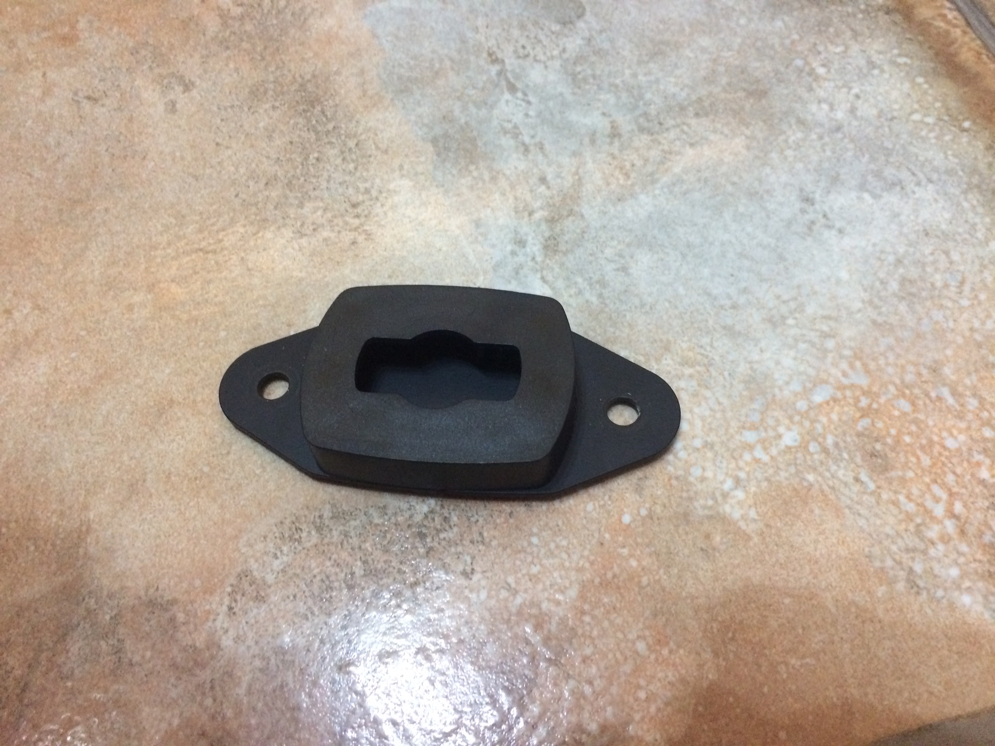

I wonder if the suckers on my car mounting kit would stick to the lid of my hard case
Hmmmm… thanks @Njoro - crackin’ idea
Well do they?
I’ll be ordering the car kit next week although I was thinking of buying RF cable and connectors to make up my own.
No, not even close, falls straight off ![]()
Not to worry, I’ll stick with attaching it to the van roof ![]()
Was worth a try though…

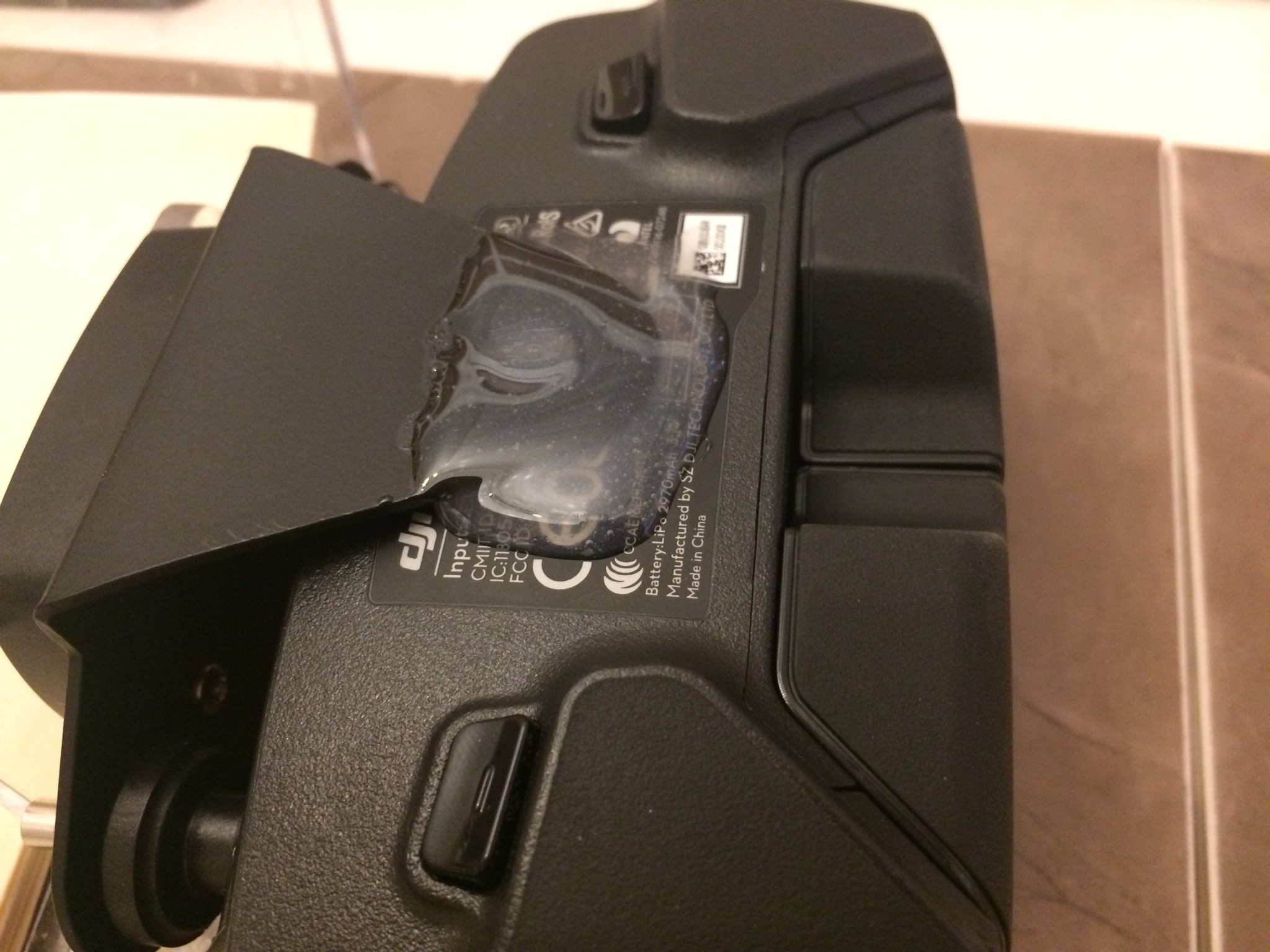

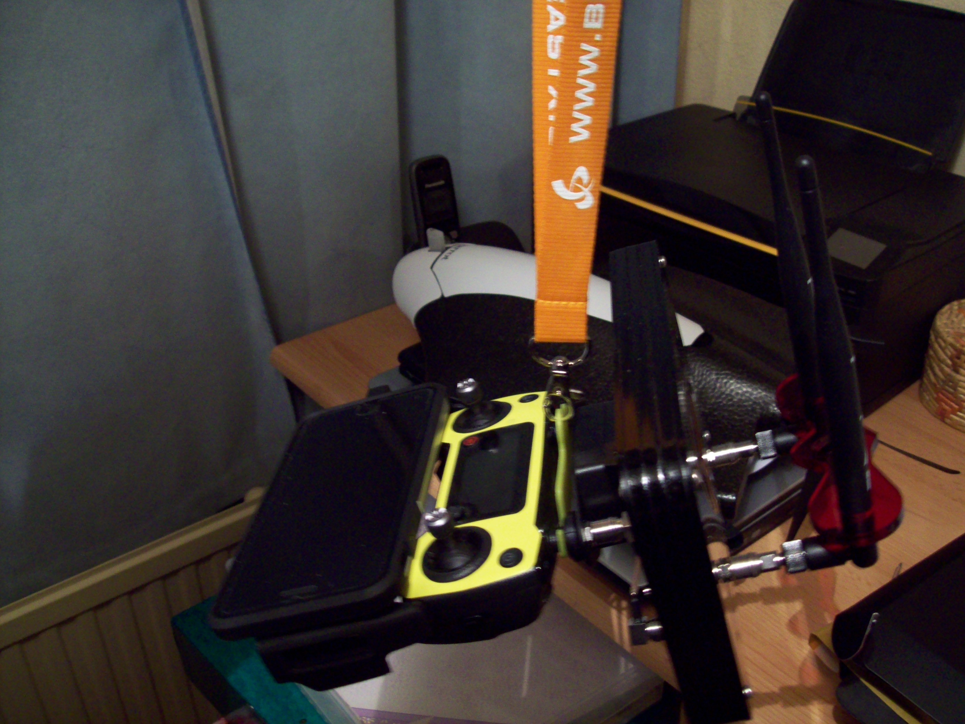

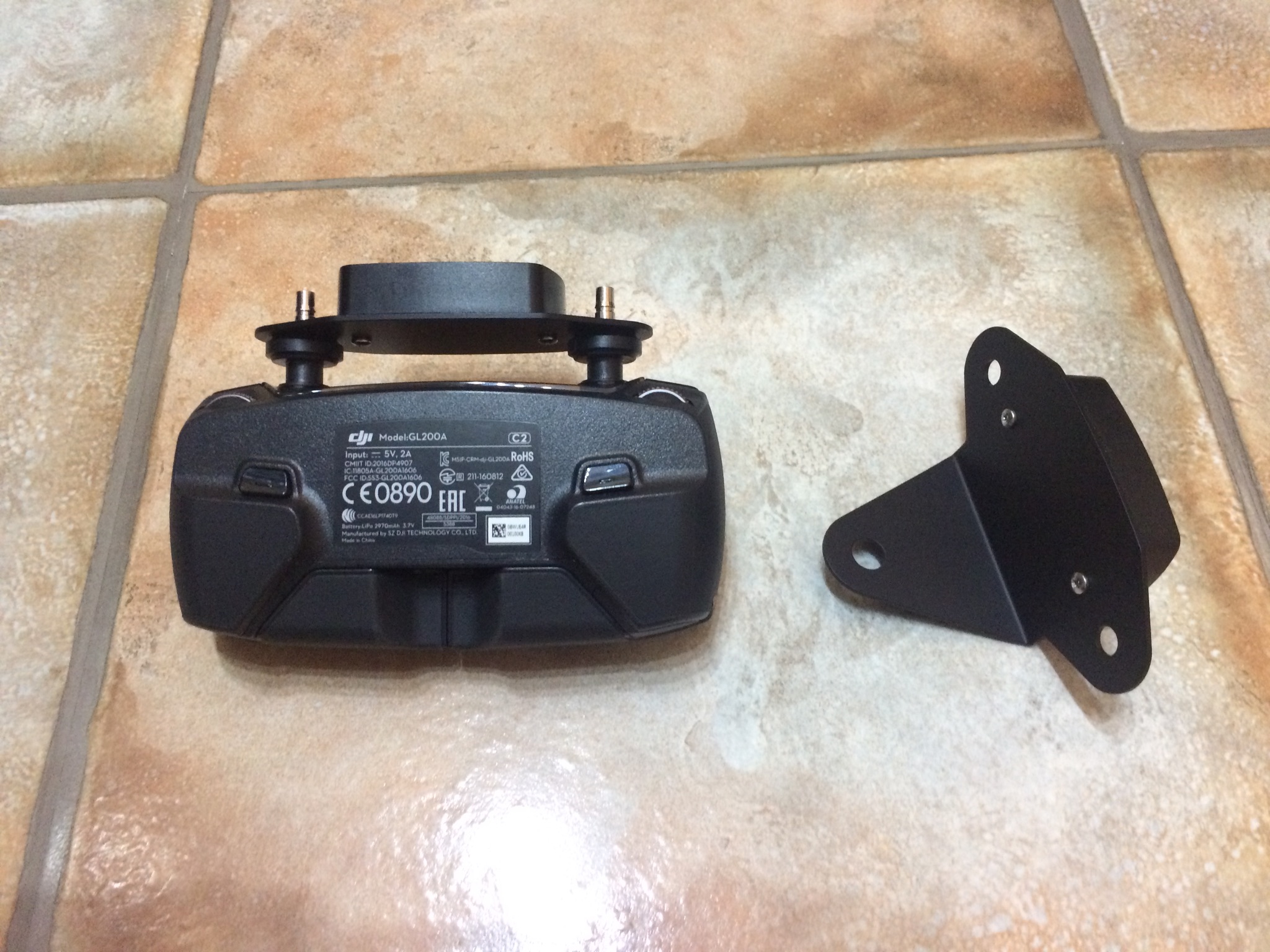

My main concern here was not so much the RSI my neck might suffer through the lanyard but the fact that when the CS is attached, if I place the whole lot down on a surface somewhere the weight of the CS on the front tries to bend the antenna mounts out of the controller ![]()
Honestly, if flexes an alarming amount - something I wasn’t comfortable with at all.

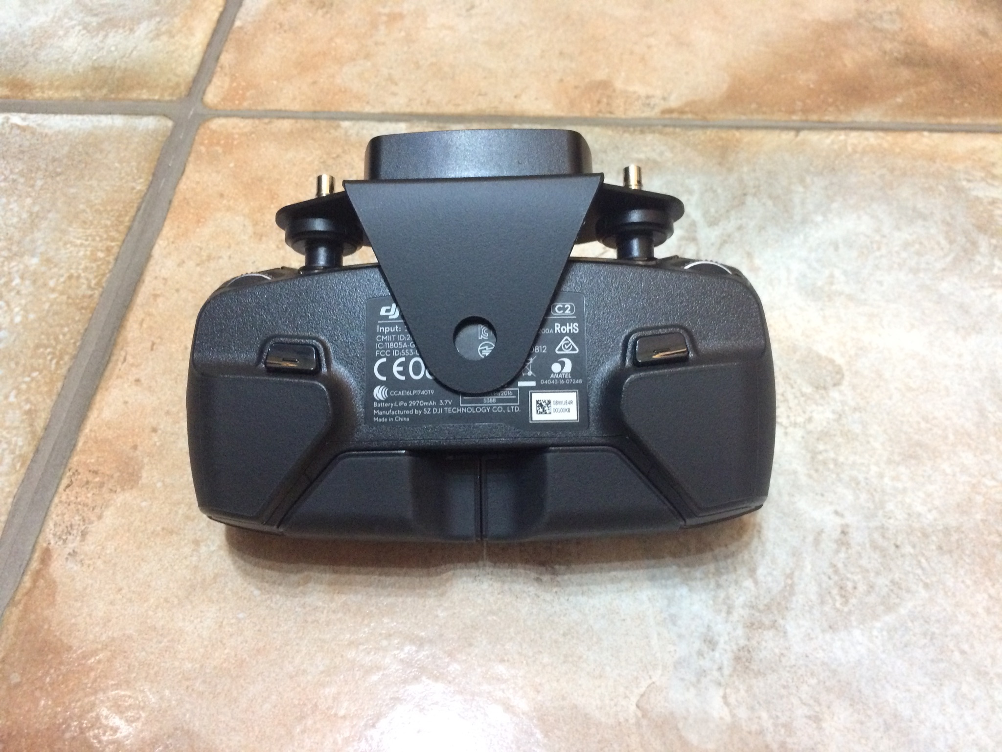

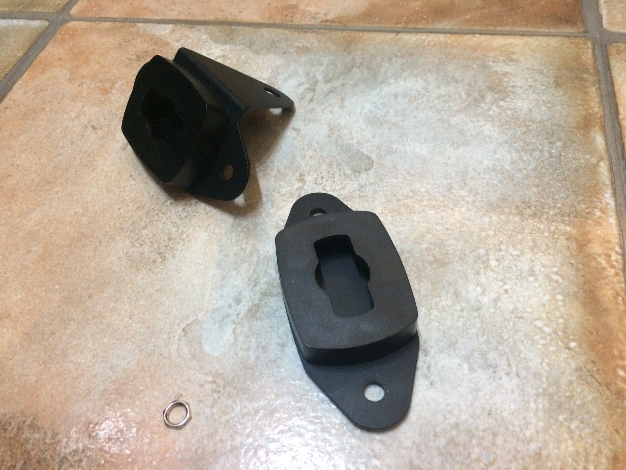

I ordered a Phantom 4 bracket, which is kinda T-shaped, it has an extra piece of metal on the back:
Here it is once fitted in place.
You’ll see it rests nicely on the back of the Mavic Pro controller.

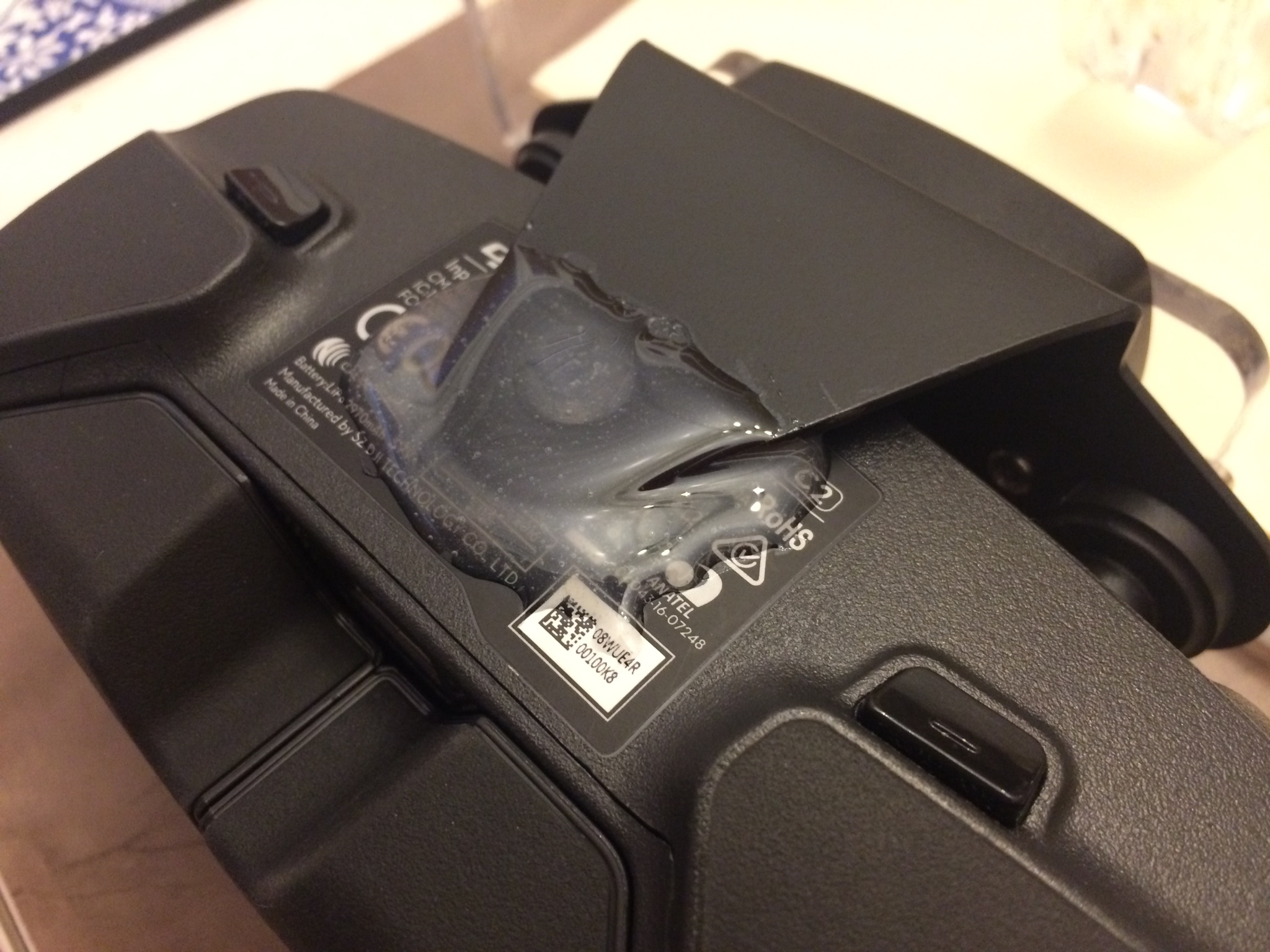

Well, in for a penny…
Superb amounts of Araldite epoxy resin to hold this bad boy in place.
Yup, I’m without doubt past the point of no return now!
The end result (I’m hoping, when its set tomorrow) is that all the flex on the weakest parts will be gone and I can rest the entire unit down without hearing a crack that would make me cry ![]()
Also, added bonus, I now have one of these spare:
I’m debating attaching it to the lid of my case, ala @Njoro case lid mod ![]()

Due to the way I’ve mounted my CrystalSky though (see post # 9 above) I can only ever have the lanyard attach to the very front.
Which is a complete
for the lanyard balance I tell ya!

I’ve been looking at it again this evening, wondering if could attach the lanyard to the top of the CS somehow.

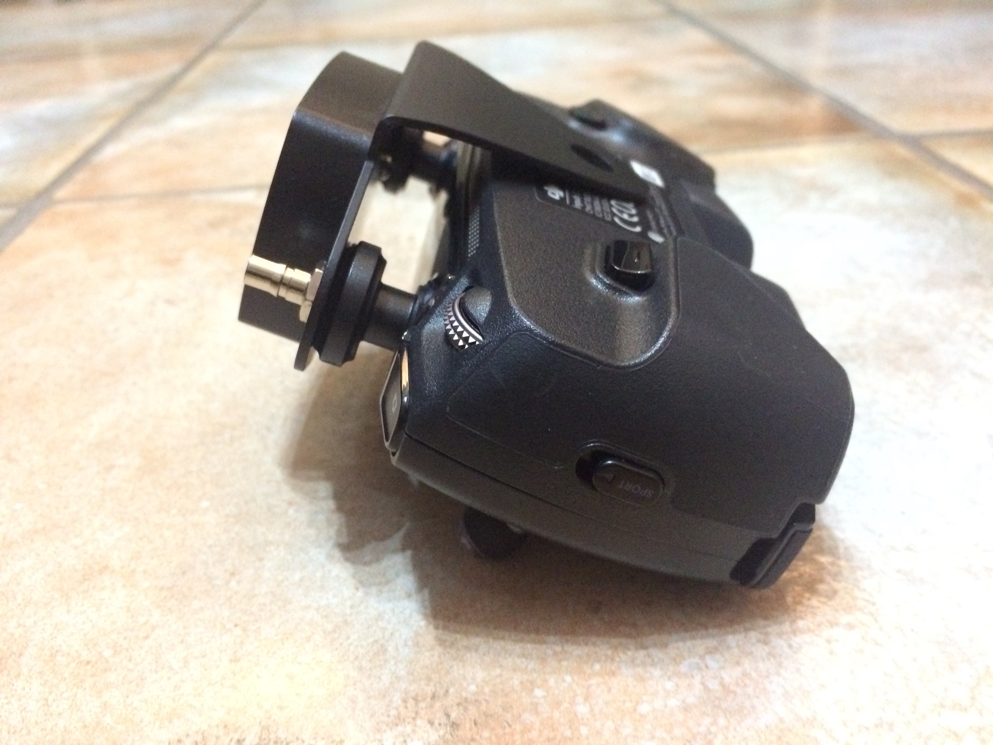

Update…
The t-shaped bracket that I resin-glued to the controller worked a treat. Zero flexing with the CS attached to the front and the Titan attached to the rear, problem solved ![]()
I flew with this setup for about 45mins yesterday.
It is ridiculously heavy ![]()
Too heavy on the lanyard so you end up holding the weight of it all. Arms like Popeye now ![]()
