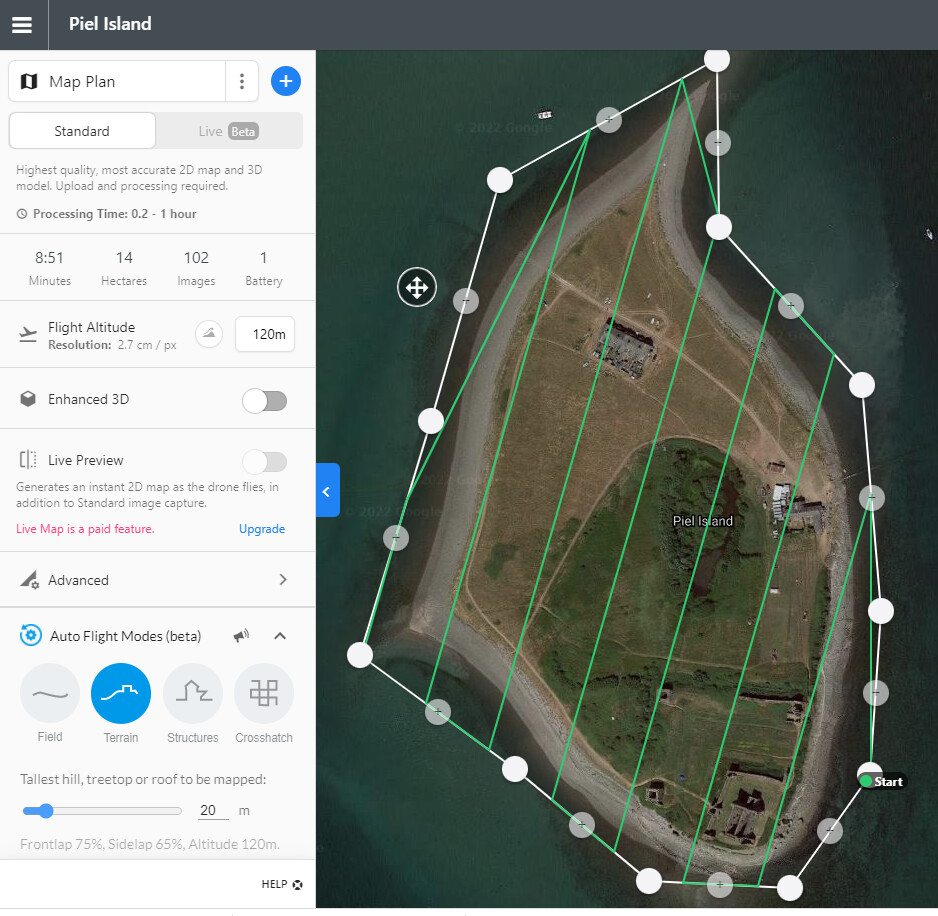

I knocked this out just now using the desktop DroneDeploy app … really quick to use.

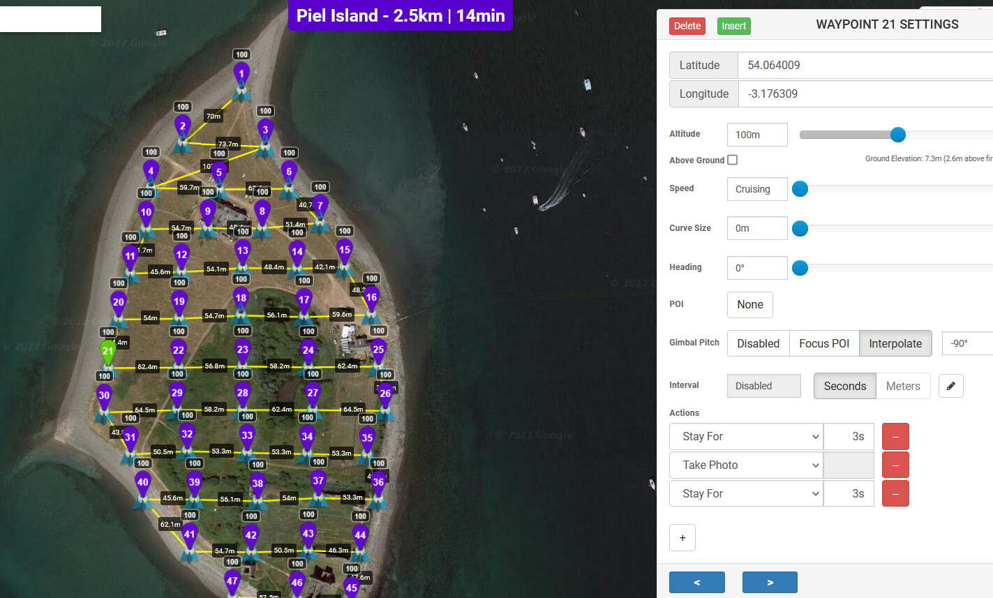

I guess you can take the settings and mirror a waypoint mission in Litchi with similar settings - it’ll just take longer to create.
Can the route gpx be exported?

You can pause at waypoints to take pics in Litchi … but there’s a 100 waypoint limit, so limiting the area one can cover. Hence why suggesting using time-lapse mode so that only the turning points of each leg need be specified.
Obviously, a small area can be covered within 100 pics/waypoints.

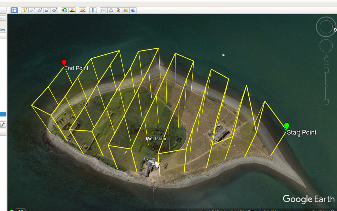

I am new to Litchi and Mission planner but couldn’t you just plan a mission and take pictures, say like this
That’s exactly what I’d been suggesting further up.
What one needs to do, first, is the calculations to ensure overlaps. That’s where the other platforms help.
Yes, that was just a 5-minute knock together, but it can be done. Its given me an idea to do my local nature reserve
