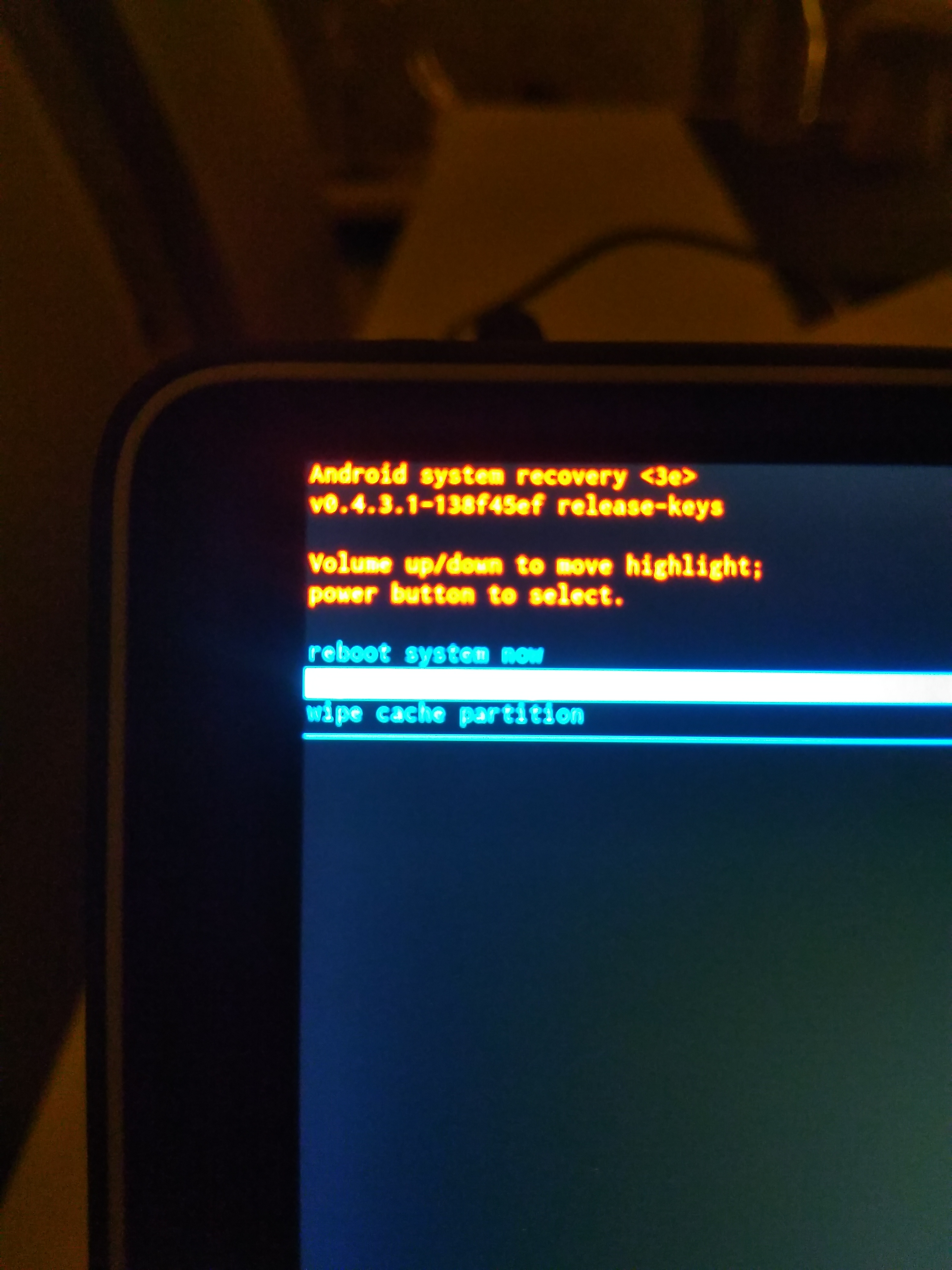

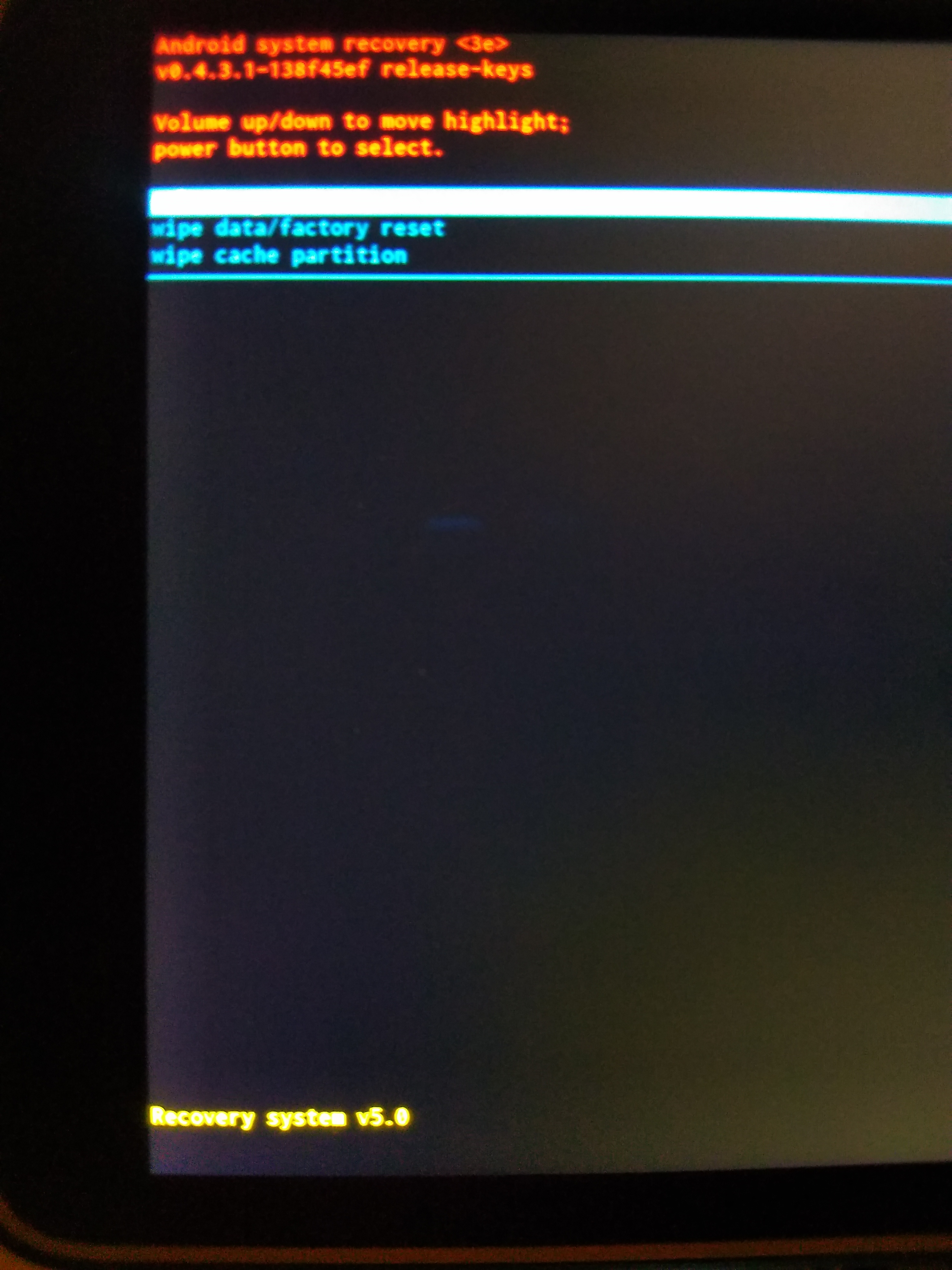

It doesn’t work on the device itself because I no longer have a user interface (I’ll send you a few photos when I’m back home).
And the STOCK-RECOVERY on the Crystalsky has no option to install a ROM.
That’s why I haven’t been able to install the original DJI ROM yet.
When I start my GL300E, only the start screen appears. After a short time it becomes a little darker. That’s it.
I also don’t get into the settings menu when I touch the upper screen tab.
And in recovery mode there is no option to install a new ROM.
I am currently downloading the latest original firmware from DJI. The STOCK RECOVERY from Android only accepts original ROMs from the manufacturer.
