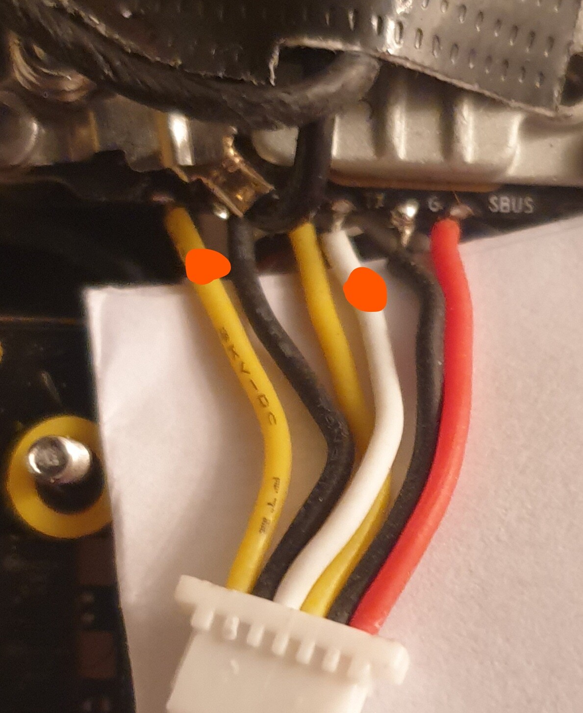

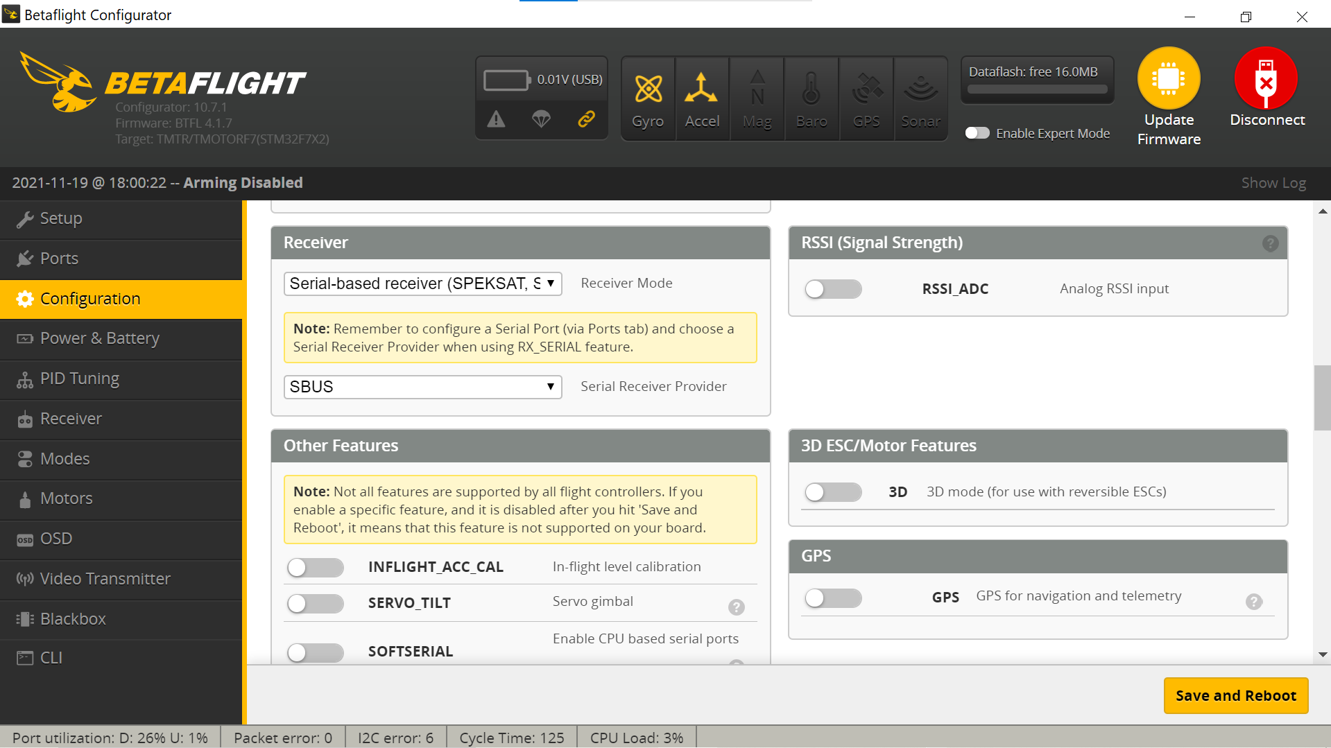

Have you set up your configuration tab and selected SBUS for the receiver type?
Did you rewire the plug end or is that an old photo?
No that’s how they are now

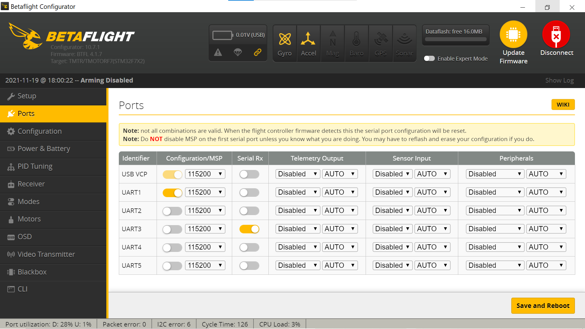

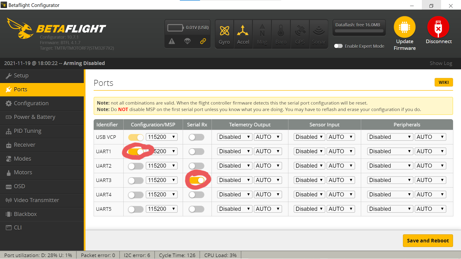

Ok so that looks like your rx and tx are the wrong way but the sbus and 10V are correct. Can you post a photo of your ports tab and like Deano said have you selected Sbus in your configuration tab?
Swap them
UART1 should be serial RX and UART3 should be MSP
So that’s wrong. You need uart 1 set to serial rx and uart 3 set to msp. Then you need to swap the yellow/ white rx/tx wires on the Vista

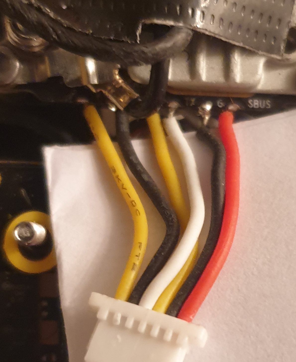

These 2 over ?
No the 2 in the middle (rx/tx) wires :+1:t2:
The white and yellow next to each other :+1:t3:
The first yellow wire is correct that’s your SBUS wire. Swap the other yellow wire with the white wire.
Although that will only effect your OSD and not your control link

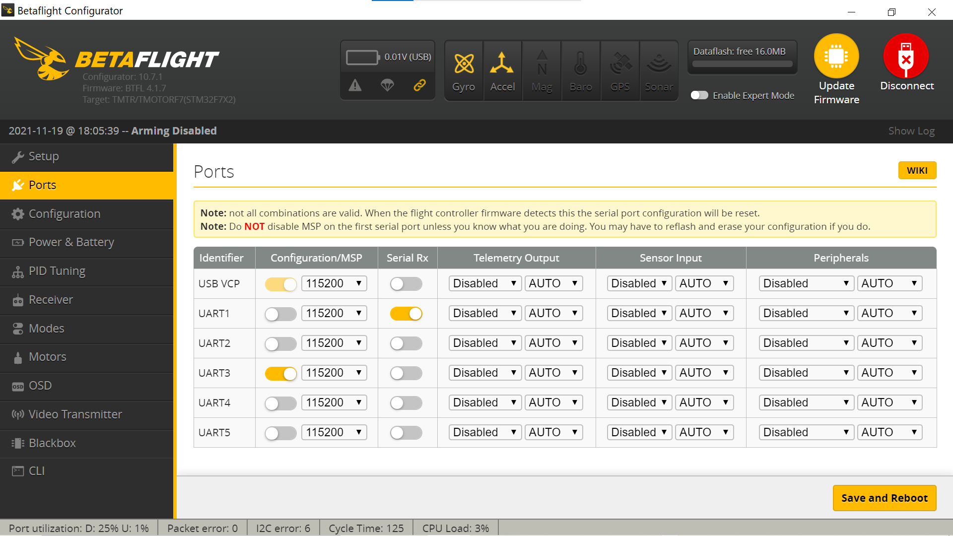

Well swopped them round and still nothing, starting to wonder if it is me or I have a faulty stack.
Really starting to run out of options and things to try.
When you changed the uarts in the ports tab did you save before exiting?
If the wiring is correct, uart 1 is set to serial rx and you have sbus selected as the receiver type in the configuration tab it should be working :exploding_head: So now thats all setup correctly are you still not getting stick movement in your receiver tab when the lipo is connected?
