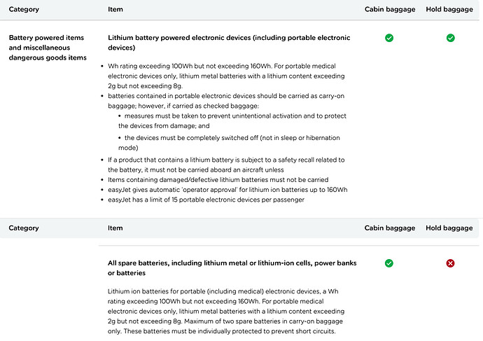

Apologies for re-opening an old thread. I’m not reading EasyJet’s rules the same way as others.
I’m flying with my drone in a couple of days and needed to check. Previously my drones have been transferred by ground freight or someone’s car or van.
My reading of the rules for flying, is that being a portable device, the drone and a battery installed can travel in a cabin bag, and then up to two additional ‘spare’ batteries can also be carried in a cabin bag.
The limit of two spare batteries is only for batteries between 100Wh and 160Wh.
Mini 4 Pro batteries are 19.98Wh and plus batteries 28.4Wh so no limits (within reason.)
I agree, although if travelling together, I’d be minded to think they’d be considered in multiples of ie. 8x standard batteries adding up to 160Wh, meaning 16 batteries in total.
Either way, a battery can travel inside drone and arguably, depending on the definition of ‘portable’, the drone and installed battery might be stowed in the Hold, for anyone silly enough to risk it.
No, if they are below 100Wh there is no adding up, there is no limit provided they are for personal use.

So “within reason” is permitted? What’s reasonable?
Although under the weight limit and for personal use, I can’t imagine being allowed to take a couple of thousand in my large carry-on. Be like taking a bomb on board and very easy to short them out.
