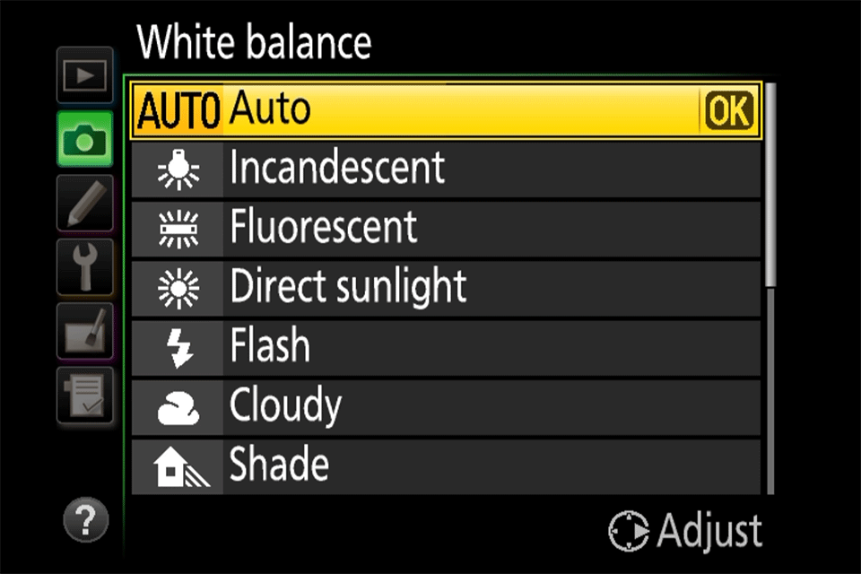

Set white balance to cloudy and leave it there unless its a Med sun type of day.
Shoot in raw, makes its easier to compensate in post too.

Why would I leave the white balance on cloudy I’ve always changed it according to the weather when I was flying with my Phantom 4

Do you think @milkmanchris idea of leaving WB in cloudy a good idea?

What about if I leave the WB on auto and adjust my EV values, would that work as well? Happy New Year :champagne: by the way
Alex have a read of the following on colour temperature to see if it explains it any easier than I can.

When you’re out shooting switch white balance between the presets and see what difference it makes.
